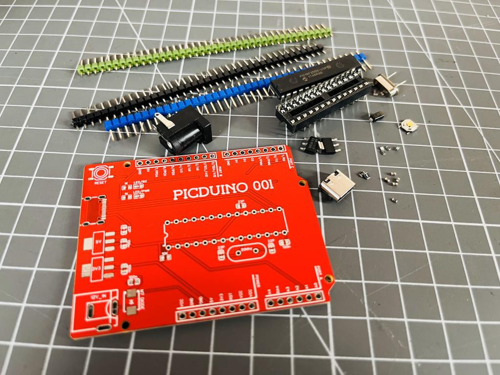

Components Required:
  • PIC18F2550
  • USB TYPE C
  • DIODE M7
  • 20MHz
  • 22pf, 100nF capacitor 0603
  • AMS1117 3.3V and 5V
  • 1K, 10K resistor 0603
  • Reset button
  • 12V jack
  • Pin Headers

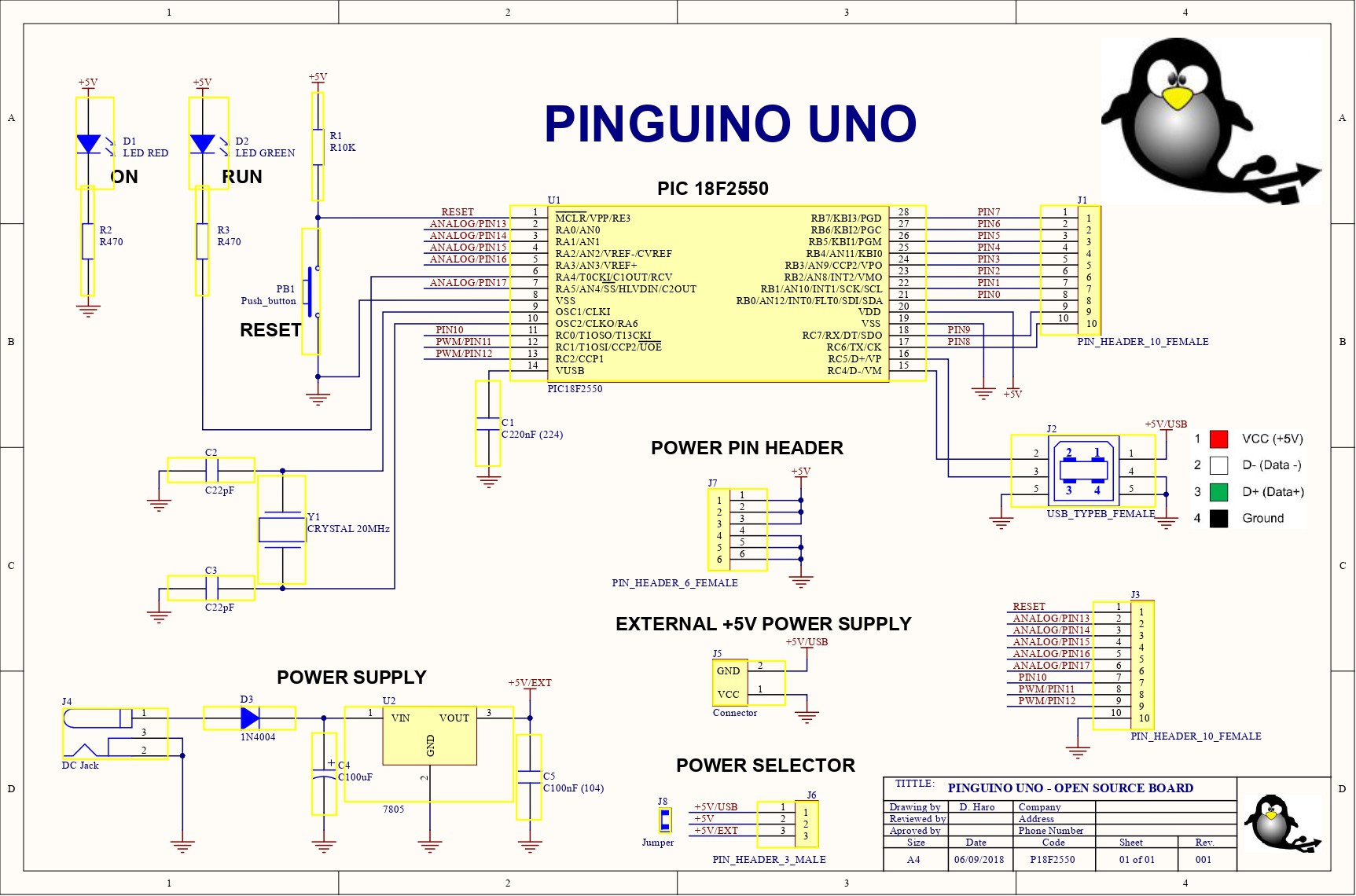

Circuit Diagram:
I am hoping to design a minimal board, overall a system that is compatible with Arduino UNO. And for this I choose two linear voltage regulators, a USB type C port for power and programming purposes, and the same compatible headers to ARDUINO UNO. I have added a header for programming through the PIC kit directly. The circuit diagram shown above and sectioned properly. 12V connector for the external adaptor power.
Crystal oscillator with loading capacitors, it supports a maximum of 20MHz clock and the loading capacitors can be calculated based on tracks and springs. As said earlier this project already exists, but I have added some other options in my version. The main thing is not to provide hardware support but to provide proper instructions from starting (hardware level) to programming with pinguino software. The configuration of headers, onboard leds can be seen in the circuit diagram.

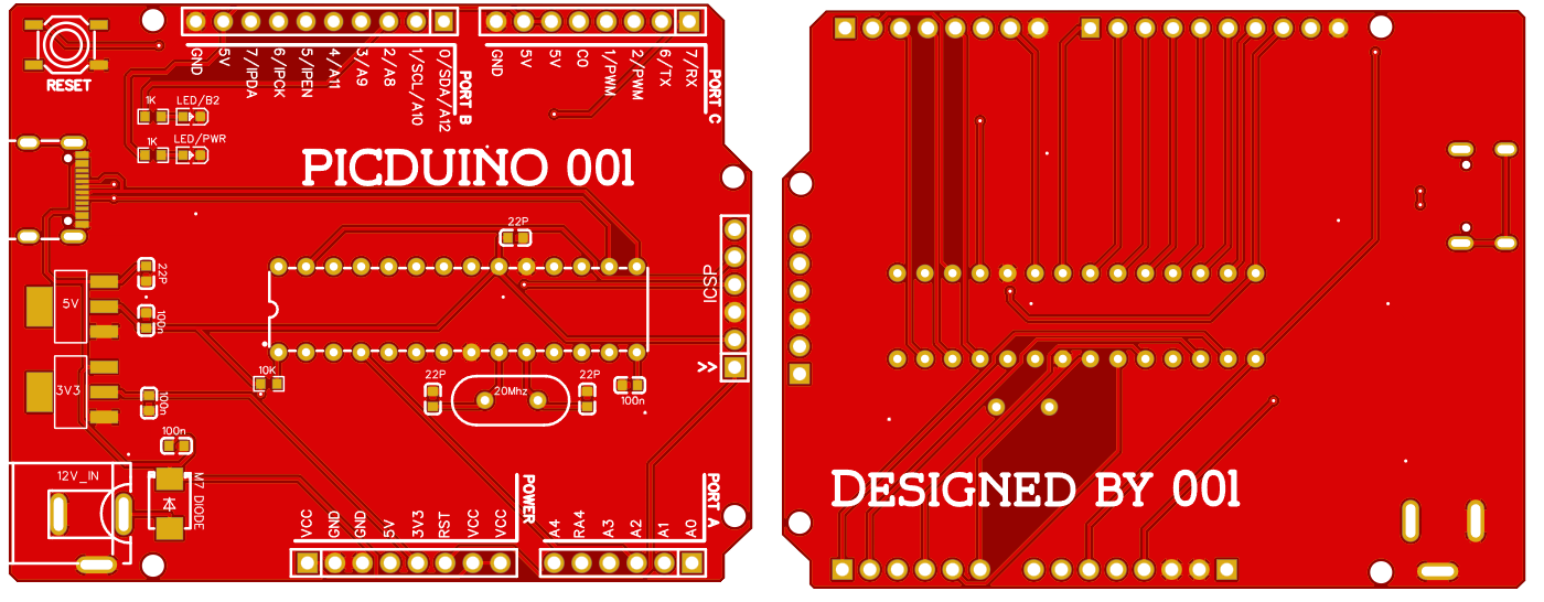

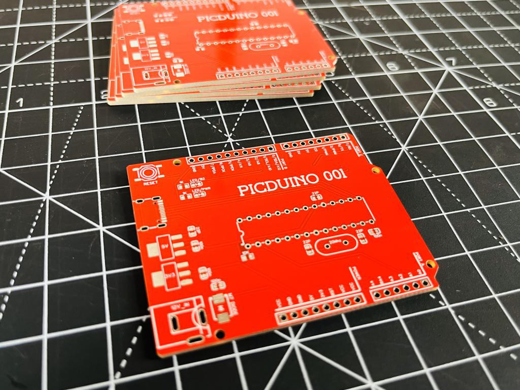

PCB Layout:
The PCB layout turned out to be the same as the Arduino’s one. The chip at the centre, oscillator nearby it. Some decoupling capacitors. The power section at the front end with all capacitors, led’s and power indicator at the top right. 12V jack and USB for power and programming, with ICSP at the same place.
I have used PCBWAY for PCB fabrication, one of the most reliable and trustworthy services. It is easy to place an order and I am amazed by the quality. It is better than other manufacturers at the same price point. PCBWAY also offers services related to PCBA and stencil, sign-up using this link and get free PCB coupons for your first PCB order.
