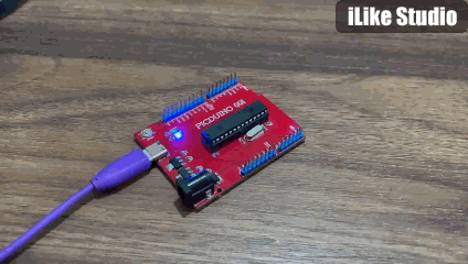

In the previous tutorial I have designed a PICDUINO board, all the hardware files are shared in that previous article. Today is the day to program this board through the USB port. I have used a PIC18F2550 which is an 8 bit microcontroller similar to an Arduino. It directly supports USB protocol without any interlink chip in between. Which is a great feature of it. Today we will use this feature and program the chip with a blink code. Choosing a blink sketch makes the process easy to learn.

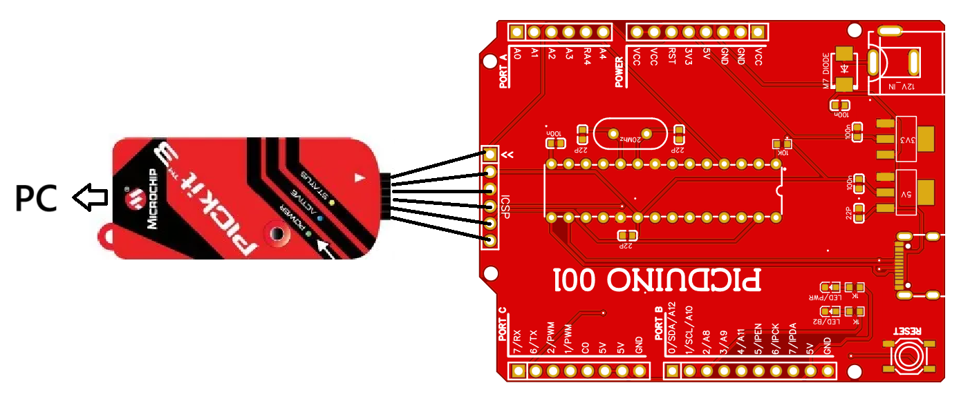

Uploading the USB Bootloader in PICDUINO:
Download the USB bootloader hex file from here, Connect the PICDUINO with PICKIT 3 using the wired diagram given here. Write the hex file in the program memory of PIC18F2550. To know the full process of writing a hex file to IC, see our getting started with PIC tutorial from here. After successfully writing the bootloader file in the chip now, we can program the chip using USB only. There is no need for PICKIT anymore. Let’s make a hex file of blink code and program it via USB.
Program for Blink in Assembly Language:
void main() {
TRISB = 0;    // selecting the GPIO as output
for(;;) {
PORTB = 0XFF;  // assigning the value HIGH to GPIO
Delay_ms(1000);
PORTB = 0;     // assigning the value HIGH to GPIO
Delay_ms(1000);

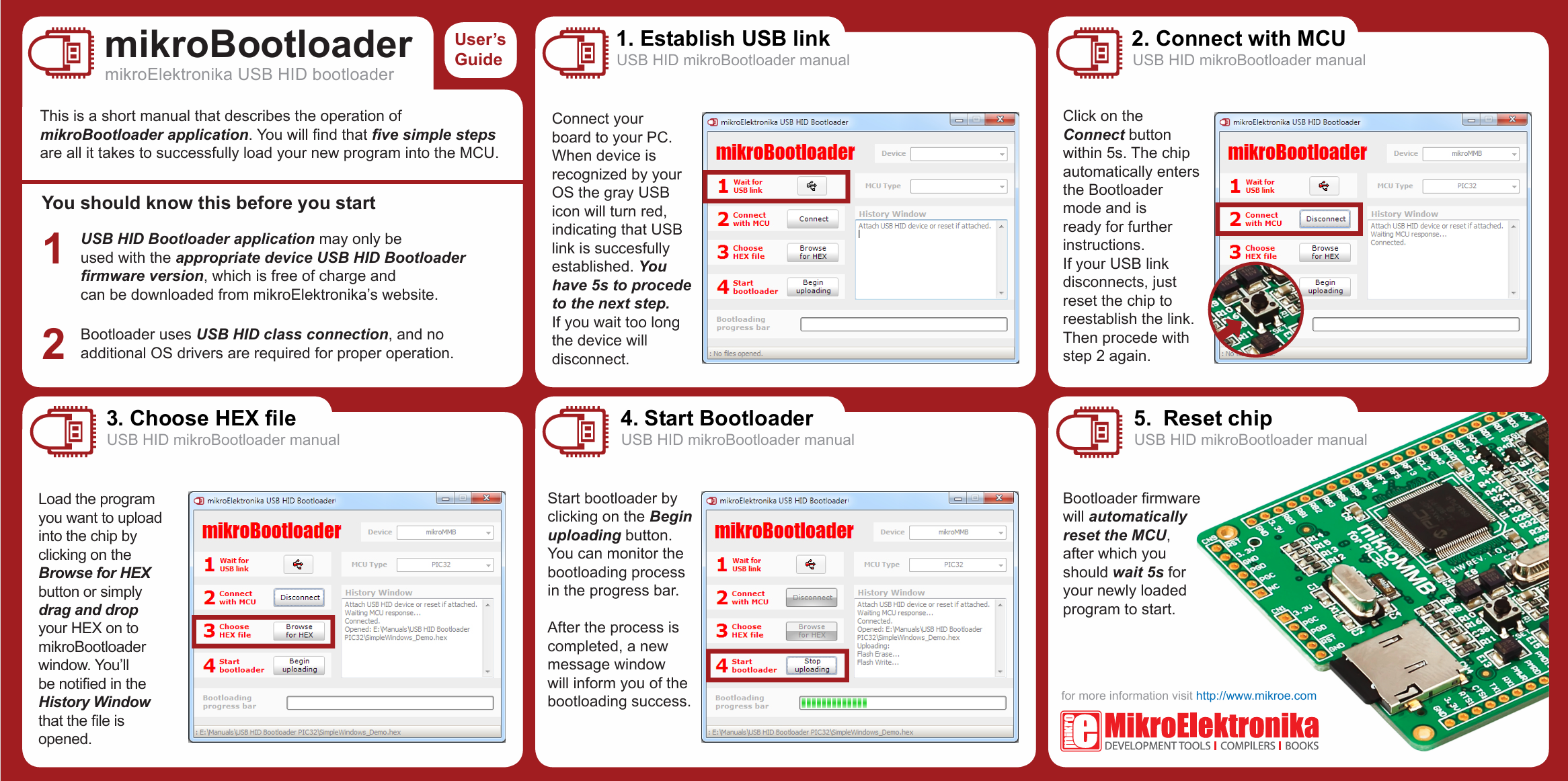

Programming Via USB:
Here is the time for Mikrobootloader software, which basically acts as an interpreter for the USB device, and after selecting the HEX file we can directly upload the file. Here is the 5 step process: Download the Mikrobootloader software from here .
Step 1. Establish USB link: Connect your board to your PC. When the device is recognized by your OS the gray USB icon will turn red, indicating that the USB link is successfully established. You have 5s to proceed to the next step. If you wait too long the device will disconnect.
Step 2. Connect with MCU: Click on the Connect button within 5s. The chip automatically enters the Bootloader mode and is ready for further instructions. If your USB link disconnects, just reset the chip to reestablish the link. Then proceed with step 2 again.
Step 3. Choose HEX file: Time to choose blink.hex file, Load the program you want to upload into...
