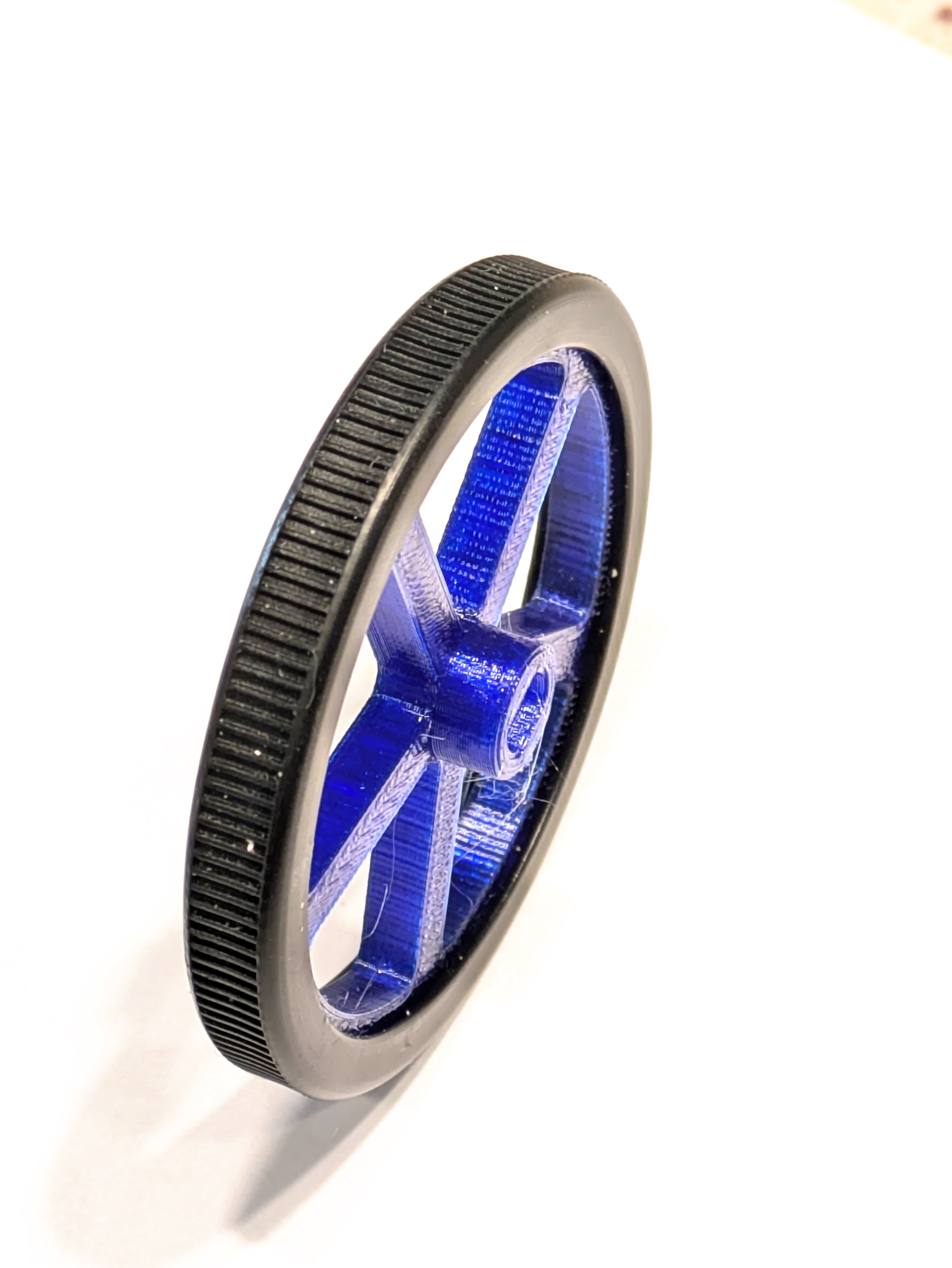

Better wheels
I made new wheels which work with Pololu's silicone tires https://www.pololu.com/product/3409.
They have same diameter as original wheels, so they can be used without any modifications to the rest of the chassis.
Design files are here: https://www.printables.com/model/1275321-wheel-for-xrp-robot-pololu-tires

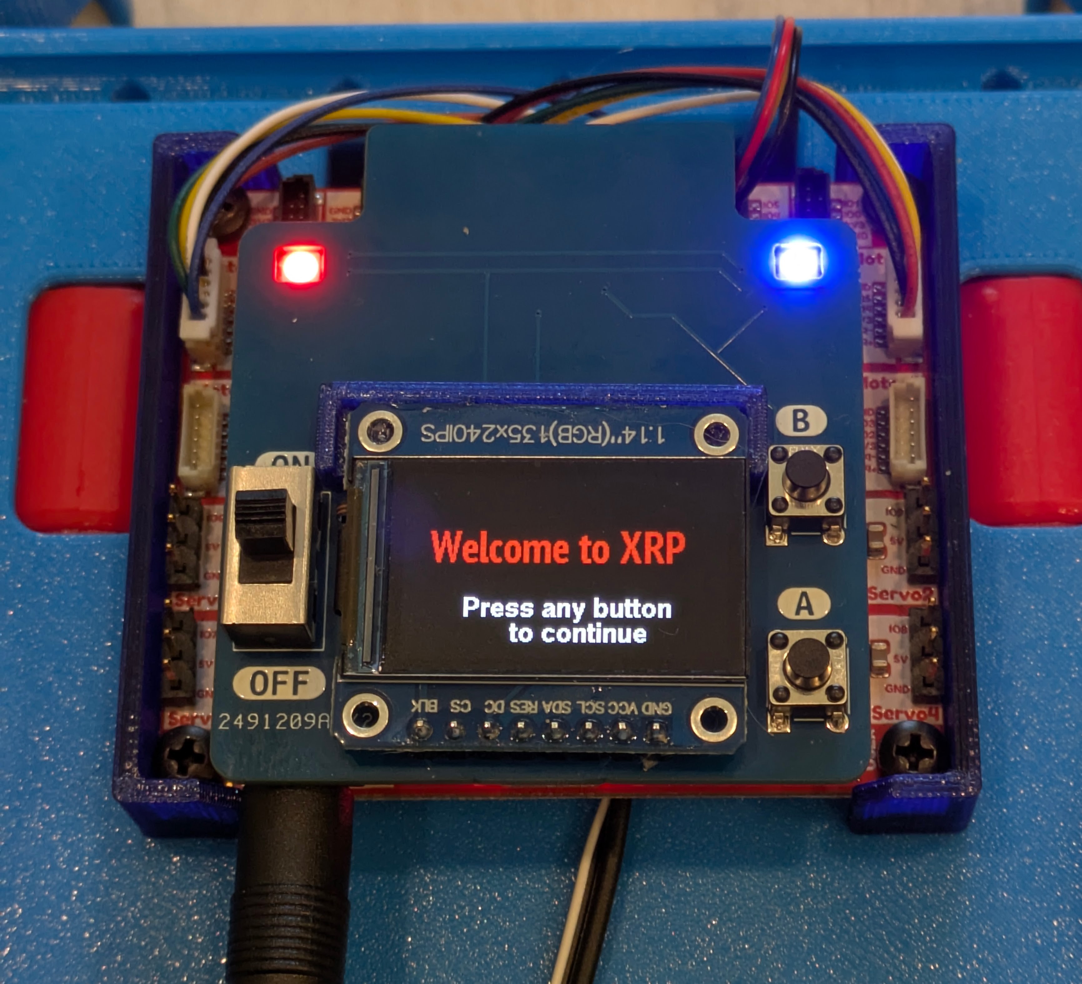

Display board
This add-on board contains a 135x240 TFT SPI display, 2 user buttons, a large on/off switch, and two neopixels. It plugs into the headers of the XRP controller.
Source files are in github, and full documentation at https://xrpdisplay.readthedocs.io/
