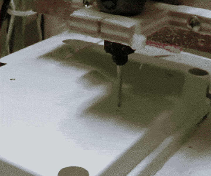

Machining the prototype enclosure on a cheap DIY dremel based cnc:
