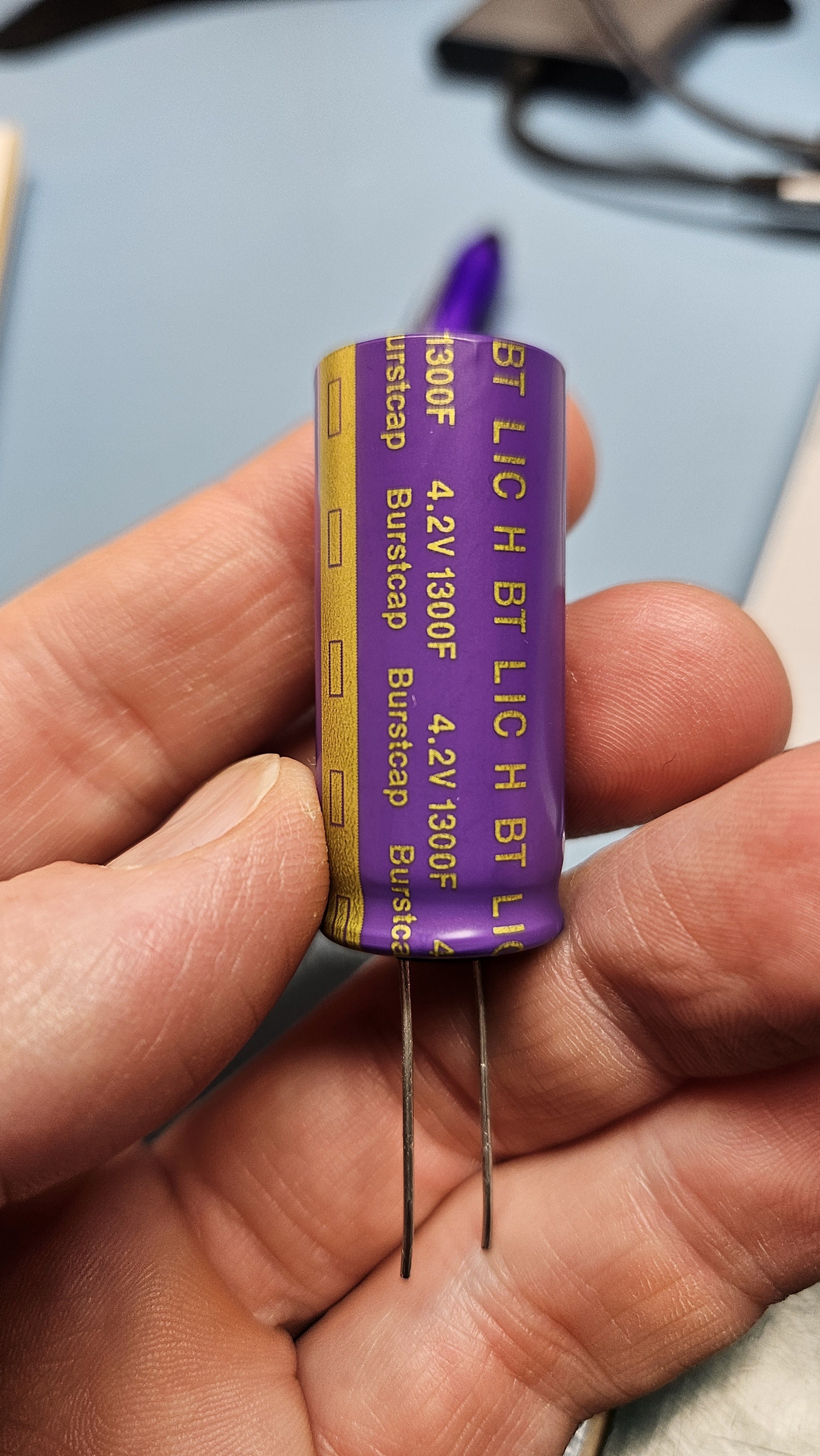

In 2022 I thought 250F 3.8V LICs are big, in 2023 I was impressed by 750F 3.8V LICs (1840 size), in 2024 I found 1100F 4.0V LICs (1840 size) and in 2025 I acquired a 1300F 4.2V LIC (1840 size) . Today a 250F 3.8V is only 1.65 euro and a 1100F 3.8V LIC is 4.82 euro. The emergence of kilo Farads, the increasing voltage and the dropping price makes them more and more interesting.

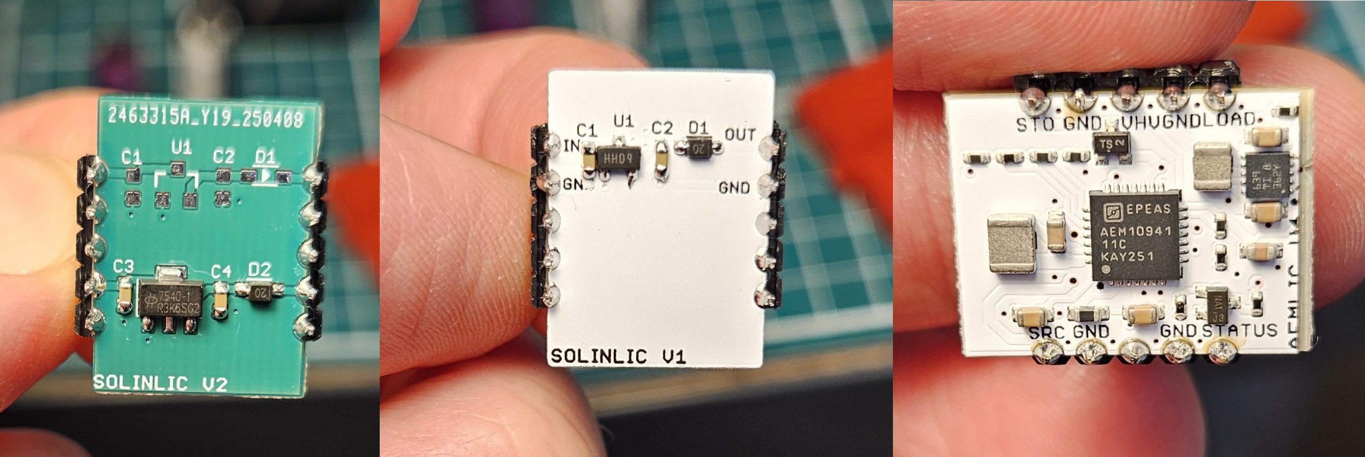

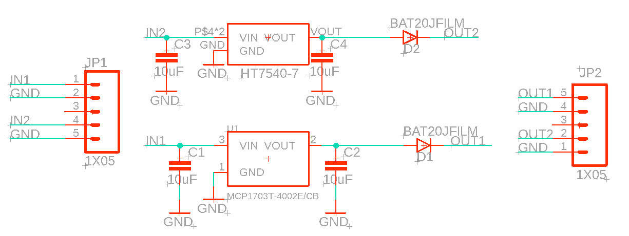

In this project I have designed two small PCBs with two LDOs and compare them to an another PCB with an expensive switching solar energy harvesting circuit. The first LDO is a 45 cents 4.0V MCP1702 from Microchip and the second is a 12 cents 4.0V LDO HT7540. Both have a quiescent current less than 5uA. I added a diode with low voltage drop in series which keeps the capacitor at max 3.8V. The diode BAT20JFILM prevents discharging of the capacitor into the LDO at night. This diode was selected for it's low reverse current. Below 4V the LDO input closely follows the capacitor voltage. This is one of the secrets of the high efficiency, as long as the capacitor is charging there is little voltage drop over the LDO. A 3.8V LIC must be kept within 2.5-3.8V range. Therefor during charging the solar panel voltage will be in the range 2.75-4.05V. So a 4V solar panel may work close to it's maximum power voltage. And due to the very low voltage drop of the LDO and the diode, the system efficiency is very high.

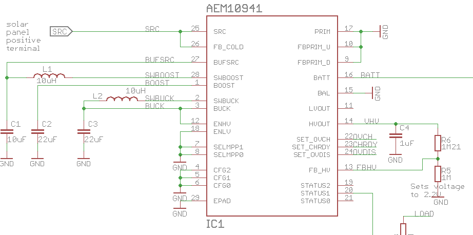

To benchmark efficiency, I compared the LDO-based circuits against an advanced energy harvesting chip E-peas AEM10941. This IC was configured to load the solar panel to 70% of open circuit voltage.
Left is the Holtek HT7540-7 in SOT89-3 package, middle is MCP1702T-4002 in SOT23-3 package and right is the AEM10941 in 28 pins LGA package.

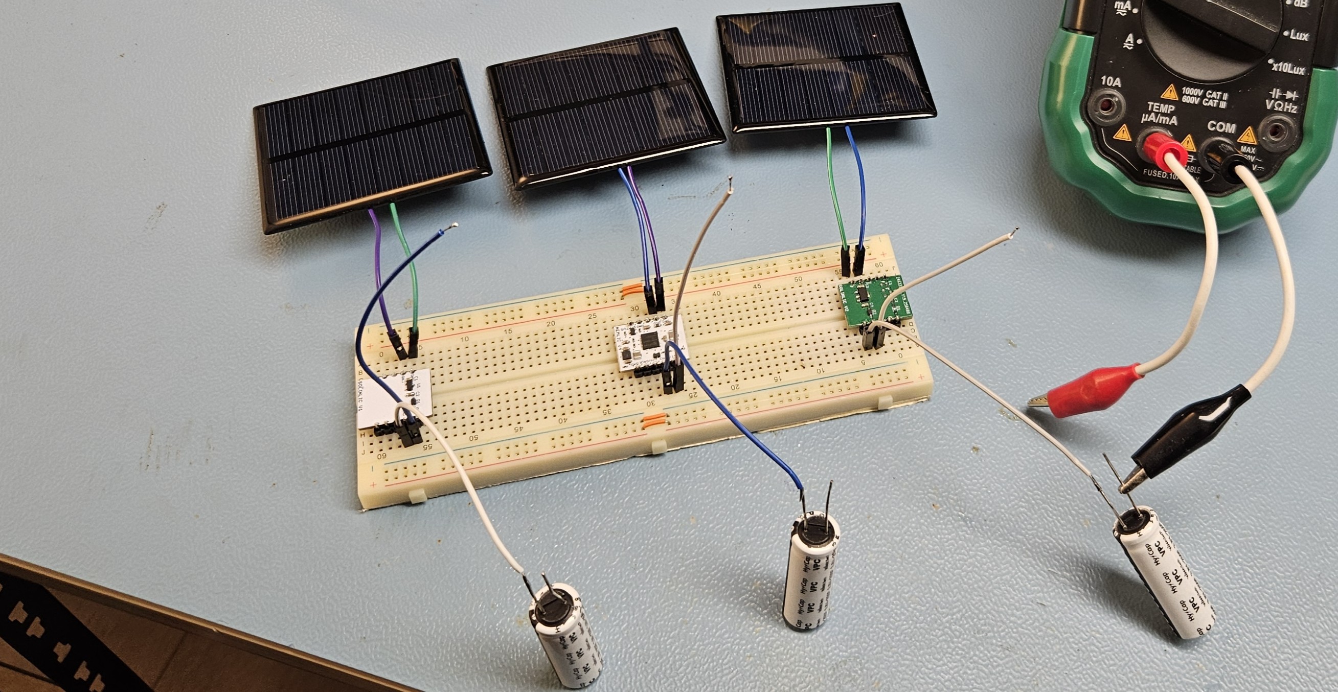

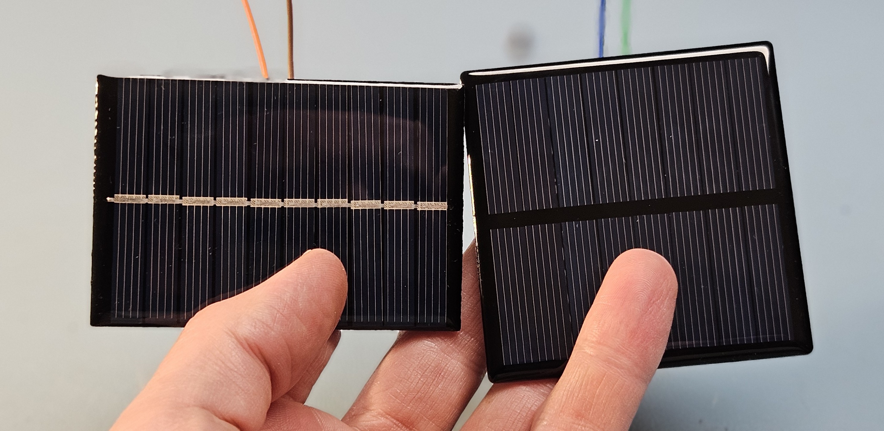

I used two solar panels with same power but different voltage 4V/150mA 70x70mm and 5V/120mA 80x50mm.

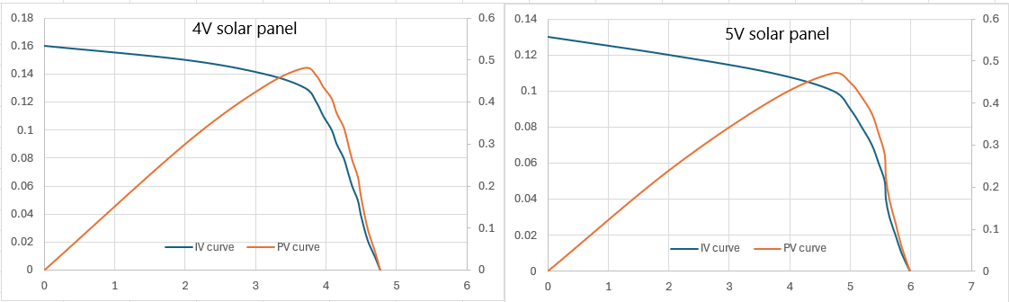

First I measured the IV and PV curves of the solar panels in full sunlight outdoors
It showed the 4V-panel had it maximum power at 3.75V and the 5V-panel had maximum power at 4.75V

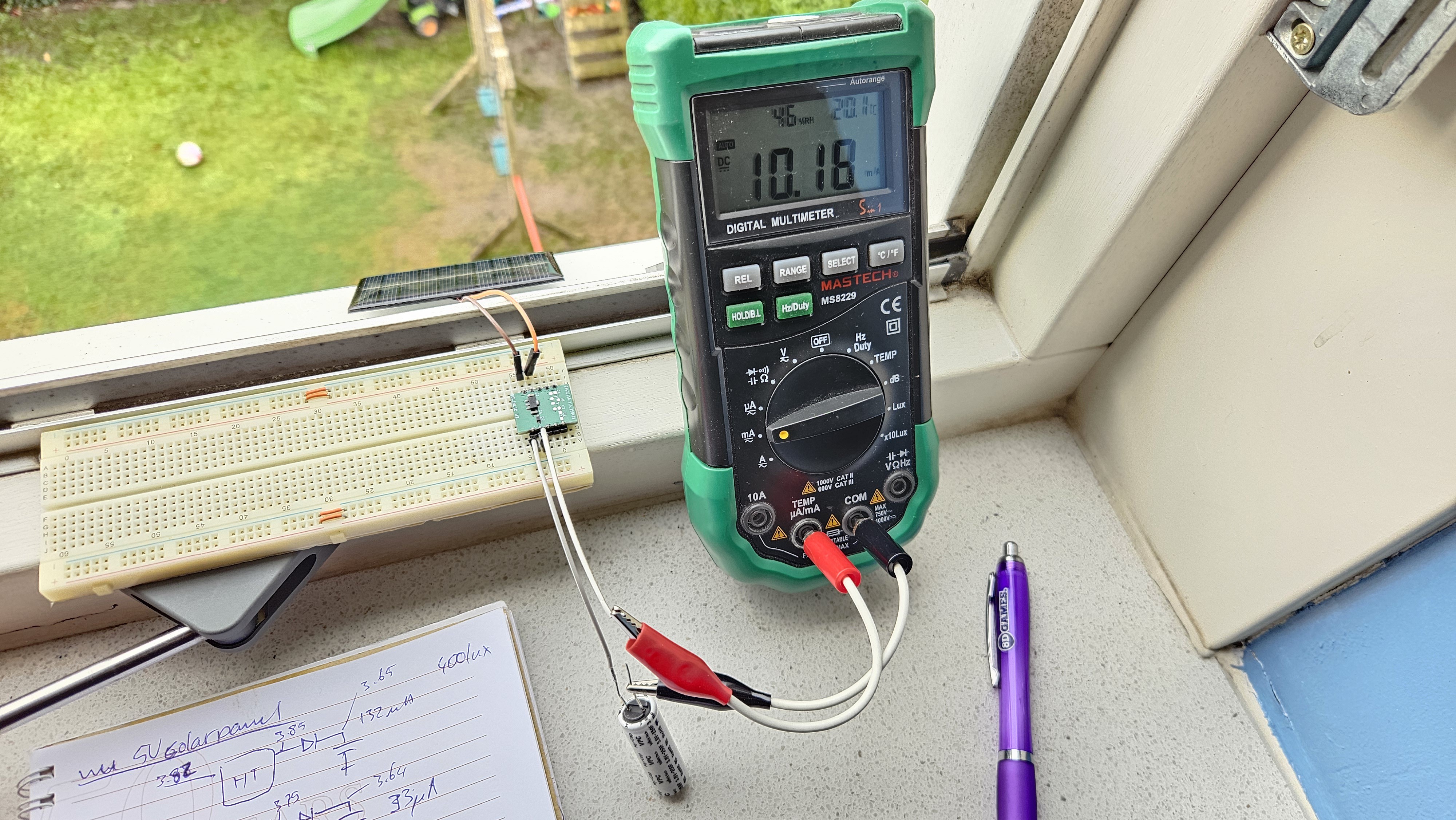

I connected a 250F 3.8V LIC capacitor and measured LIC charge current, and measured voltage drop between solar panel, over the LDO and diode to the LIC.
I tested...
