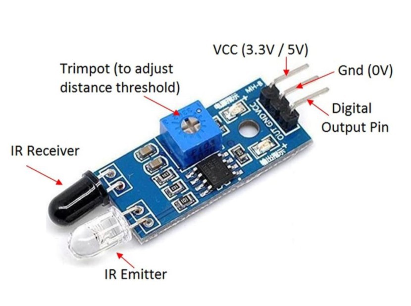

  As the name itself tells us, this detector module consists of an Infrared receiving LED which is connected to an operational amplifier which processes the detected signal. Infrared LED has the ability to detect a light source in the infrared part of the spectrum. In the case of a flame, most of the spectrum that is emitted is in that infrared region. In addition to the infrared sensor, we also use a microcontroller, which, when detecting a flame from the sensor, activates other processes, in this case a light and sound alarm, as well as a pump immersed in a water tank which at that moment begins to extinguish the flame to prevent its spread. Actually, I made this device together with one of my students and it is a high school graduation project.

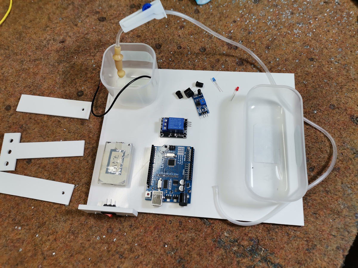

 The device is very simple to make and consists of only a few components.
  - Arduino Uno microcontroller board,
  - Infrared Flame detector module,
  - Water pump with hoses
  - 5V Relay module
  - 2 Leds with apropriate current limiting resistors 470 Ohms.
  - Buzzer
  - and Battery (in my case 2 lithium cells in series with total 7.4V and 1 cell for Water pump)

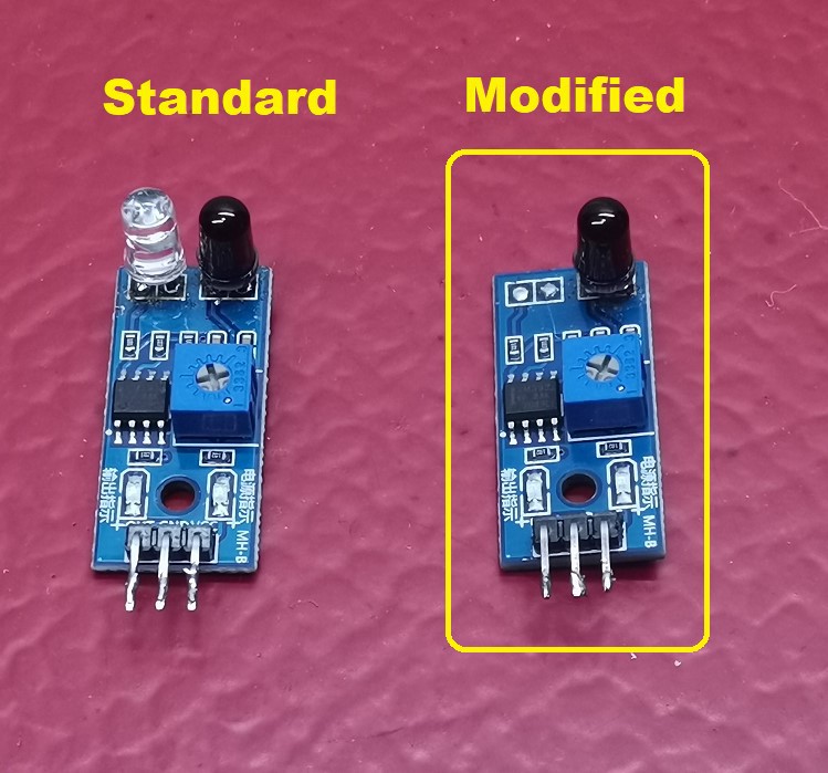

  Let's first analyze the hardware part. For the Flame detector I use a standard IR sensor module with transmitter and receiver LEDs, where we need to unsolder and remove the transparent transmitter LED.
The main part of the water pump is an electric motor, which requires a current of more than 100mA to operate. On the other hand, the Arduino outputs can only handle a current of up to 40mA. For this reason, the water pump is connected via an electromagnetic relay module, which consumes about 20mA.  The pump also uses a separate power source because the motor brushes often reset the microcontroller because they were previously connected to the same source. LEDs are by definition current consumers, so they are connected to the Arduino outputs through current limiting resistors with a value of 470 ohms, so according to Ohm's law, a current of about 5mA will flow through them. The buzzer is a component that connects directly to the Arduino and is controlled by pulse width modulation(PWM).

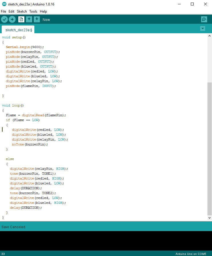

  As for the Arduino code, it can be seen that it is extremely simple and therefore reliable, which should be a basic feature for this type of device.
At the beginning, variables are defined and created, and then in void setup, the inputs and outputs are defined, as well as their starting values. Then in the loop function we use an if-else statement that allows you to make decisions depending on the value of a variable.
   Now let's see how the device works in real conditions. First, I'll turn off the power to the water pump for practical reasons and test the rest of the device. First, we need to adjust the sensitivity of the IR detector using this small potentiometer. Now the sensor is adjusted and we can connect the pump.
