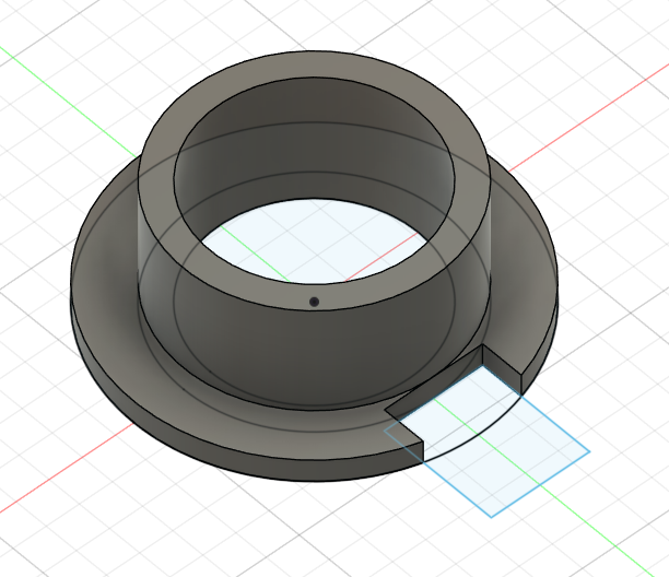

So far, I have been fixing this up and removing unneeded parts. The main piece of work I had to carry out was on the film gate. There is a rotating lens that also acts as the shutter. When the film pulls over the Front left-hand Gear, this rotates the Gate, or it is supposed to. When I got this unit, the gears were extremely stiff. Fixing and tracing the issue was made worse by some Gears being metal and some plastic ( evil designers ) .
Behind the small Gear at the rear of the assembly, there are two plastic cylinder washers. These had shrunk just enough over time that the whole assembly could bearly move. So I booted up my PC and designed a replacement to 3D print. This will be available online at some point, free for anyone to use.
