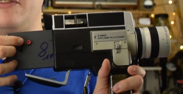

In my journey iv found a few people who have had the same idea. I first found out this might be possible from the Elements 14 YouTube channel video linked here, but as you can see in the screenshot below, it ended up being rather bulky and with focusing issues

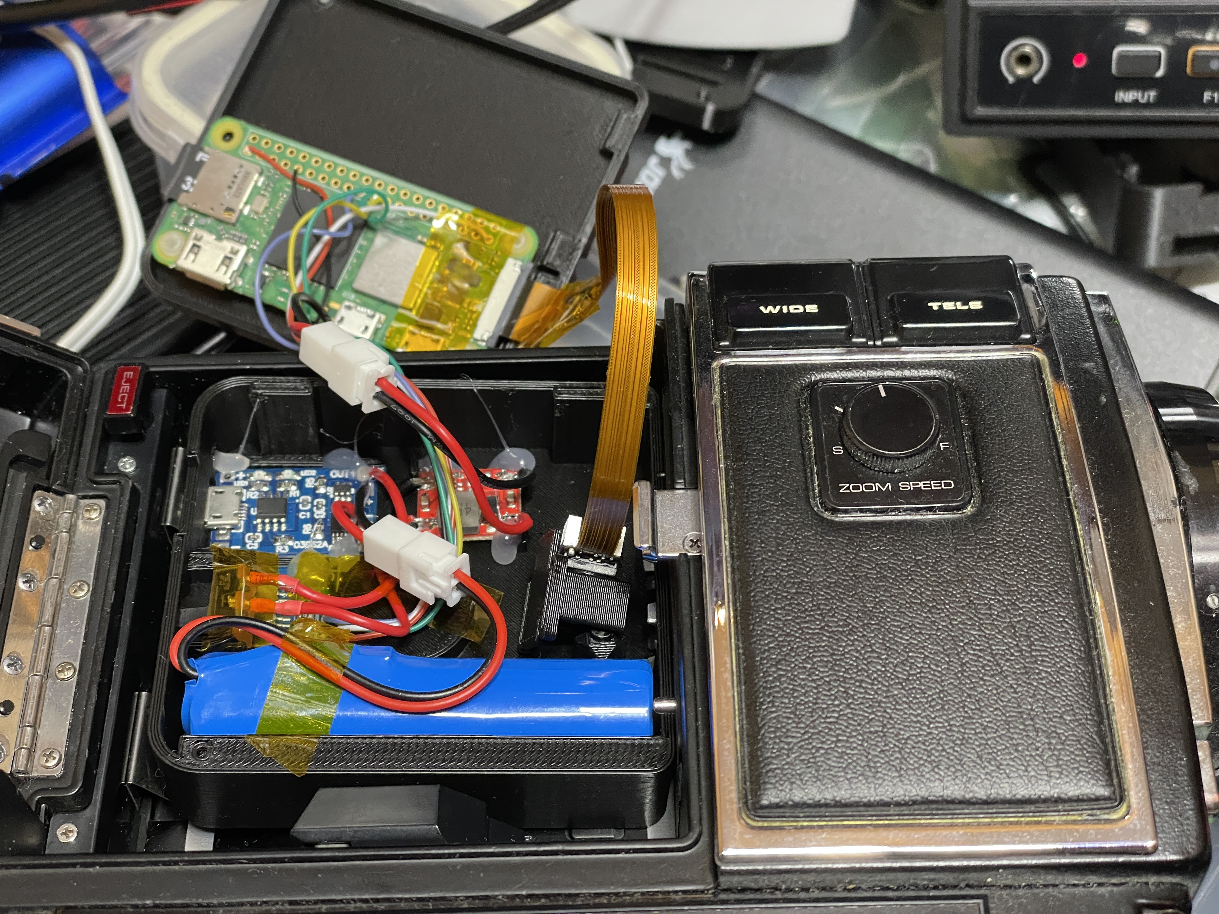

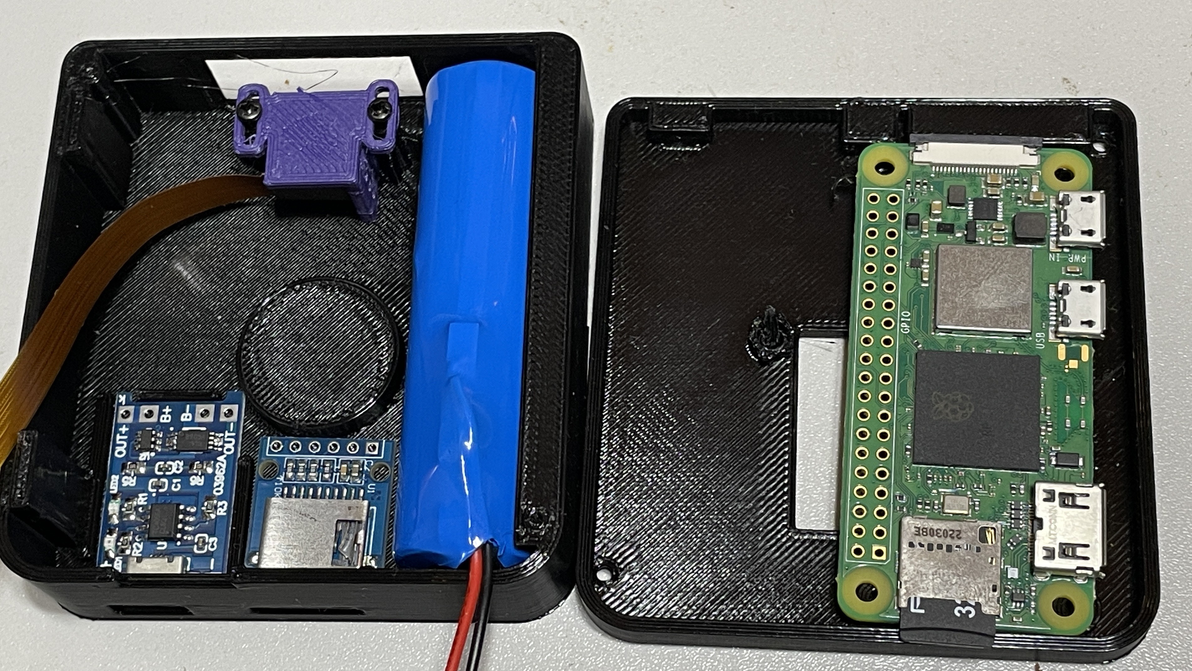

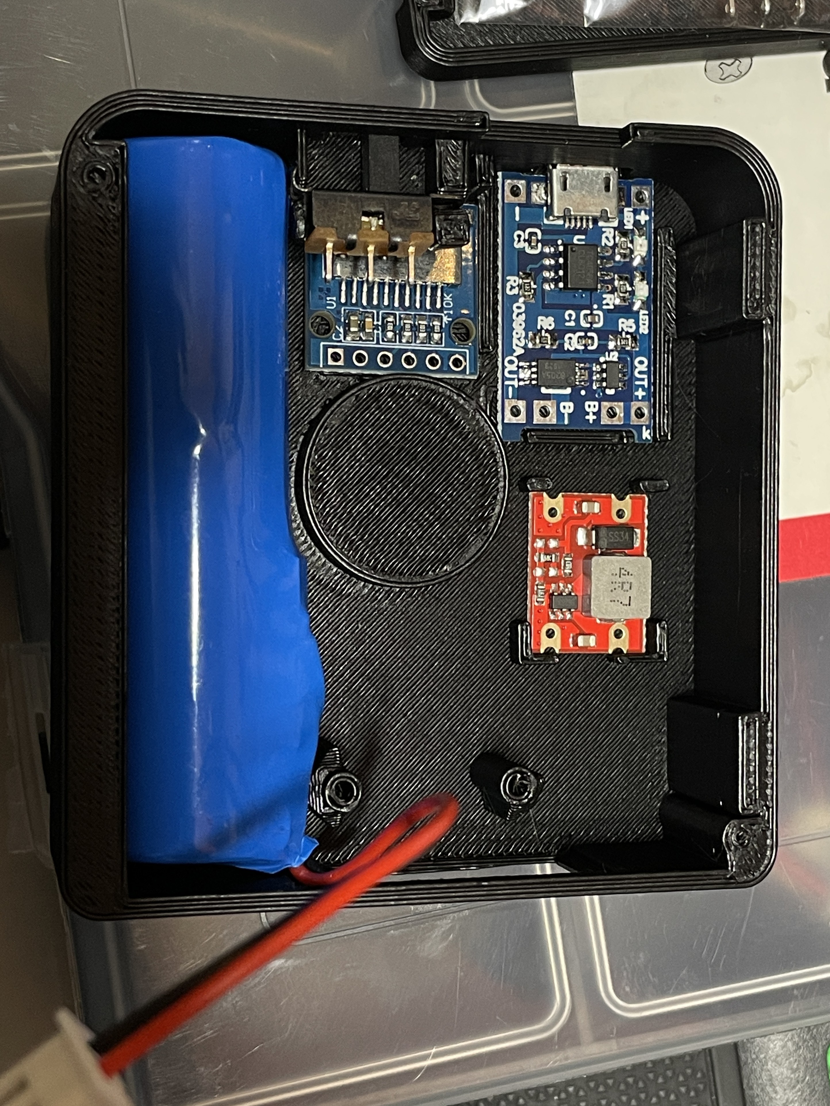

    This update is a small but vital step in this project. The digi cart is now running under its own power. I have swapped out the bad DC to DC converter.
    This new one can go up to 5 amps, so plenty of headroom. I have also found a micro switch small enough to fit in the case that can also take 1 amp at 5 volts ( max for this circuit )
    I've installed everything into the Digi Cart to see how it fits and to find out any issues
    Issues so far
    1 . Raspberry Pi standoffs need lowering to allow some more space for ribbon cable, as it is hitting the camera module when I try to close the lid fully
    2. The SD card reader is the type where the micro SD card sticks out, something I had not realised until I tried it in the case. I will need to rework the case design to move this SD card reader back.
    Before I address these issues, I'm sorting out the camera itself, trying out different ways to mount it, different-sized extension tubes, and making sure I don't need to change the mounting points on the case.

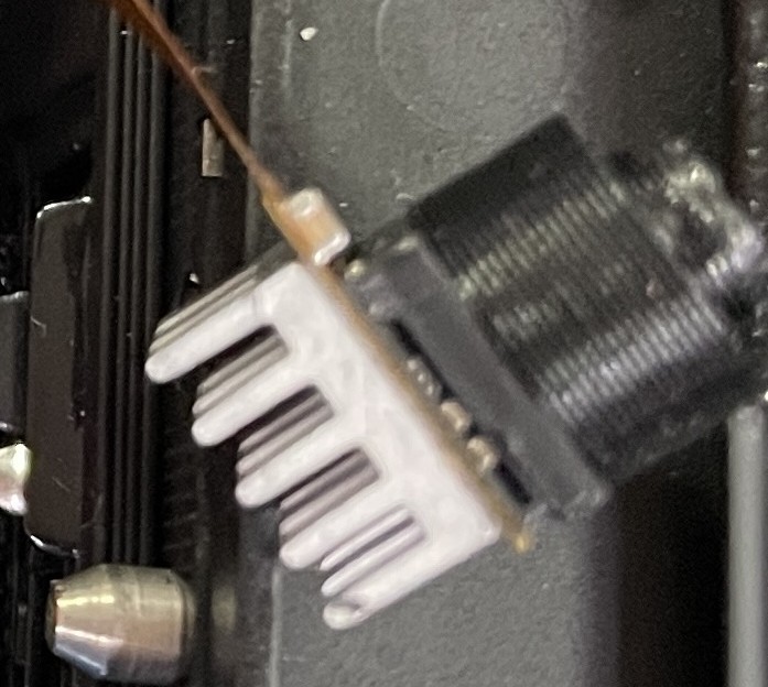

    While waiting on parts to fix my power issues, I've been experimenting with different ways to use the camera module, and two of them worked (YAY). So I now have two possible ways to make the camera module display an image. I have included a short video of the results below.

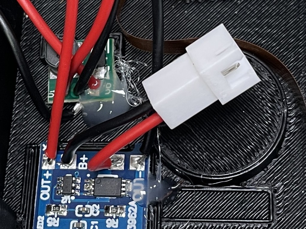

    So the first issue I have is that I started soldering the power wiring into place.
    The eagle-eyed among you will notice that the BATT input is wired the wrong way round. This is due to my battery using reversed colours, something I didn't know until I tried plugging it in.
    The battery still works fine; this one section just has the wrong colours.
    The second issue revolves around my battery charger and DC step-up converter.
    My charger can only output around 4.2 volts at 1 amp, so my intention was to use a DC-DC step-up converter to make this a stable 5 volts. However, this little PCB
     It can only output about 480mA max at 5 volts, so it is completely useless and has been removed from the parts list. I had far too many tabs open with DC-to-DC converters, and it seems I purchased the wrong one/ got the data sheets mixed up.
    So what are the next steps :
    The wiring with the wrong colours, I'm just stuck with, so that is what it is.
    The power converters I have three open
    1. Find a new step-up converter that can do 1 amp
    2. Find a new battery charger that can output 5 volts at 1 amp
    3. Run the pi directly off the battery at 4.2 volts ( not recommended)
    I will be exploring these options over the next few days.

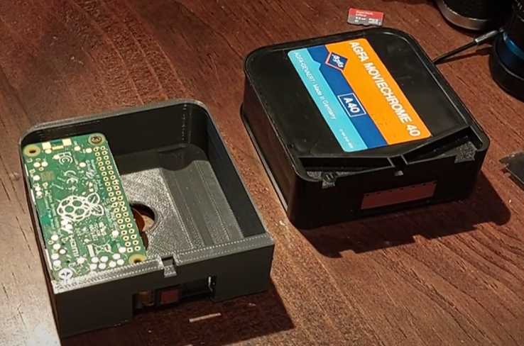

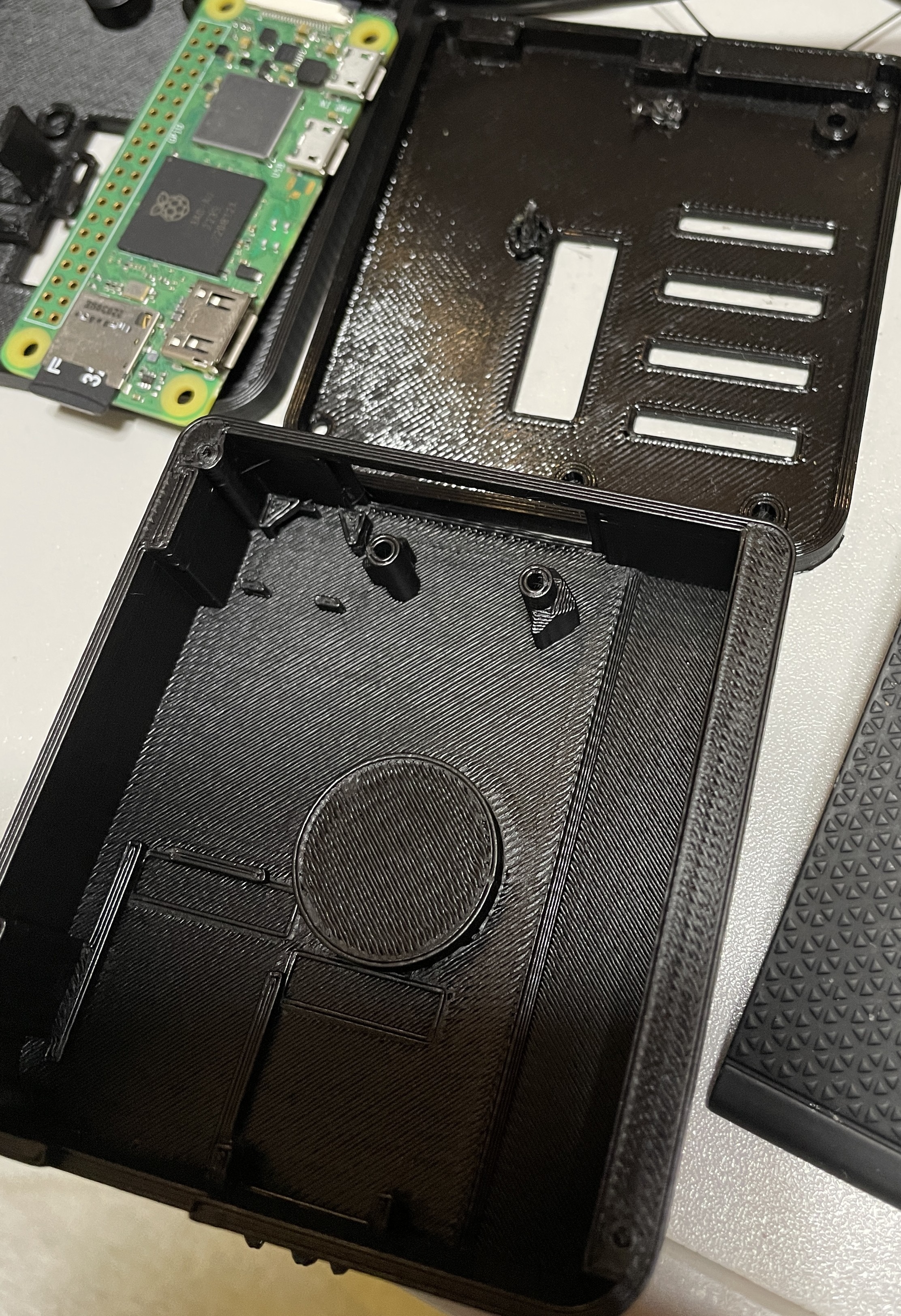

    Over the past few months, I have been focusing on the case design and fitting all the parts inside, as the main thing holding me back at the moment is that I'm not able to run this as a self-contained unit. It's stuck on my desk, and my office is not long enough to reach infinity focus when calibrating the camera.
    I can now start a list of parts for my project (yay), as I have found parts that fit and will hopefully work. I already know my screen will not work as it is, hence it is not being listed yet. I will update the list as and when I find new parts or issues.

    I have recently changed the 3D filament I'm using to matte black. So far, the amount of light it reflects is a lot less ( see the example below top part is the old filament and the bottom is new matte black)
    Next steps:
    The next steps are to get this assembled and under its own power so I can start working on the software. I can then work on the camera module. I have designed the case to allow me to swap this out when I find new ways of focusing the cameras. I already have three ideas floating around if the current one does not work. And finally, I need to make a power-on switch for the Pi. This will prob be the only custom PCB, not an off-the-shelf part, as to date I have not found a micro switch that can take 2 amps at 5 volts. If you know of one, please feel free to comment below.

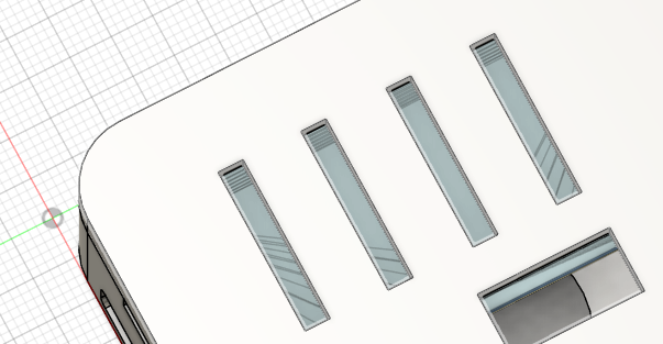

    I have also added some air vents above the Raspberry Pi to help vent heat. I also have some full-body heat sinks for my Raspberry Pi in order to ensure some of the heat can escape.

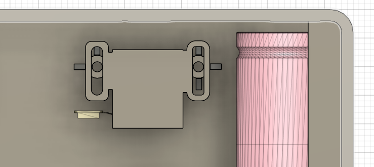

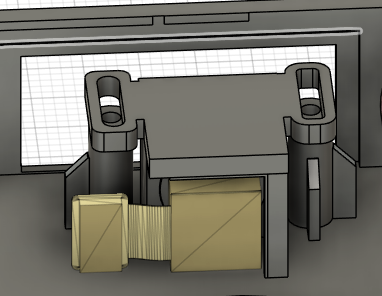

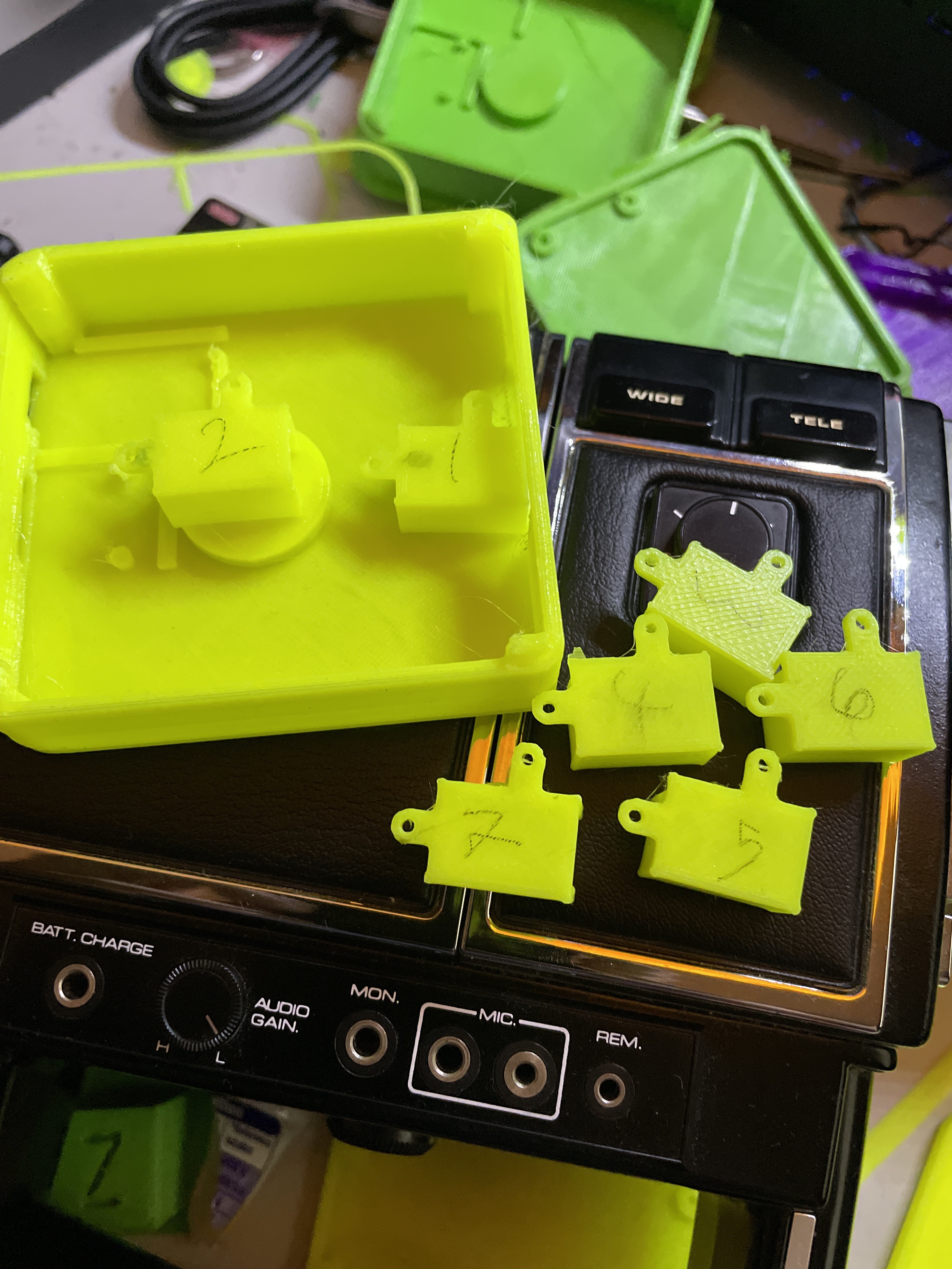

    I have been working on the camera mounting. After far to many editions ( more then you can see below ) I finally have a mount that works for my camera.
    This mount locks the camera from moving away from the focus plane while leaving enough space for me to experiment with different cameras/measurements from the focus plane.
    I have two Super 8 cameras, one side-loading and one rear-loading. I have been trying this out with both cameras using the side loader so I can adjust the parts inside the DIgi Cart easily, and in the side loader, and I can confirm compatibility by trying the rear loader.
    After a lot of adjusting the position of the camera and the focus, we have success, I finally have an image, its not perfect but its a start.

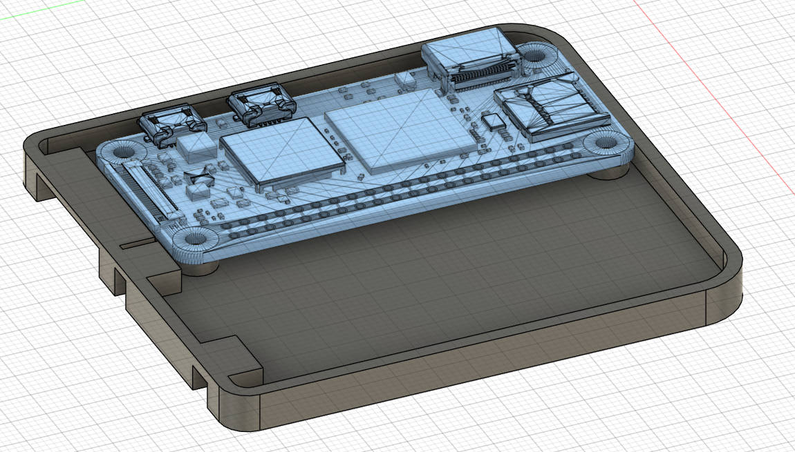

    Iv spent the past few days refining the Case idea, and Case V1 is almost there, all must have parts that have a home now, and it's getting very cramped in the Cart. I am now working on the camera mounting solution, which you can see at the front of the cart. Next, I need to figure out if I can fit a screen and controls onto the lid before i can start working on the software.

Oh, I tried the same thing a few months ago with a Raspberry Pi, but I had a lot of focus issues and a lot of crashes due to overheating.
I will follow this project more closely.
bozzer91 wrote 11/08/2025 at 16:11 point
that's good to no there might be over heating issues. iv added the air vents iv also orders some heat sinks as well hopefully that will help.
