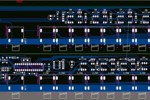

This is in its infancy.
This was posted to the piclist
Theory:
Closed loop control where all the slaves chase the master by attempting to maintain the same resistance of their internal pots.
A DPDT switch to provide the polarity reversal and eliminate the need for each slave to be driven with a H-Bridge.
