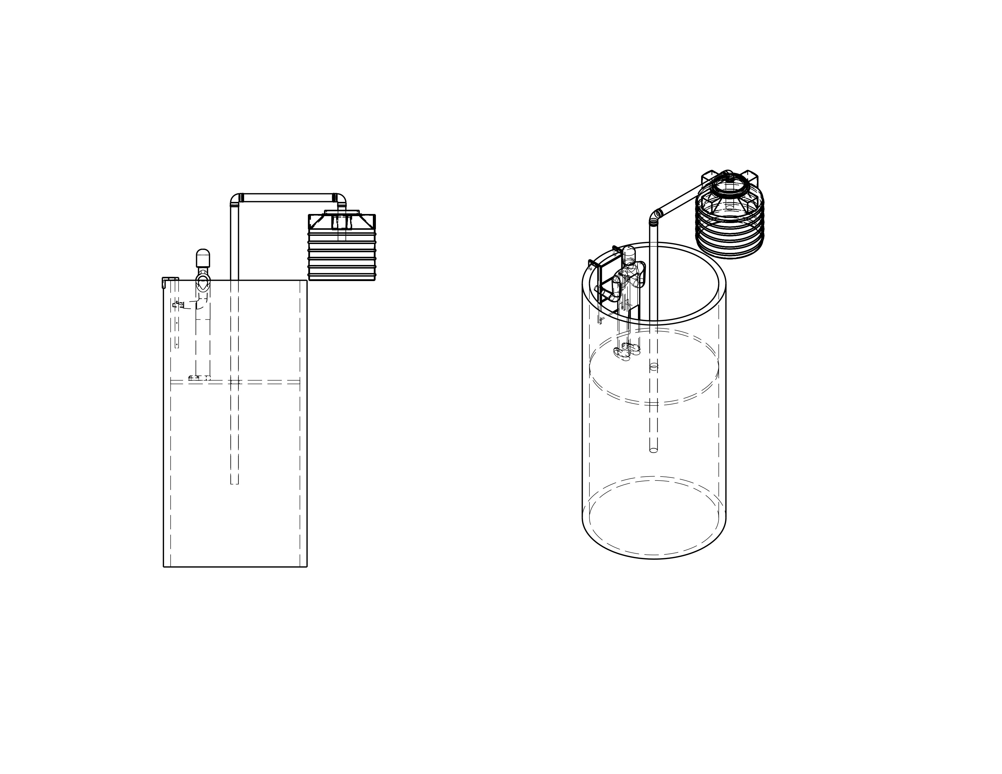

New kind of water well that doesnt need any power source except weight of people to pull water out from ground up by using pascal’s law.
This project is about building a new kind of water well that does not need any power source except weight of people to pull water out from the ground up by using pascal’s law.

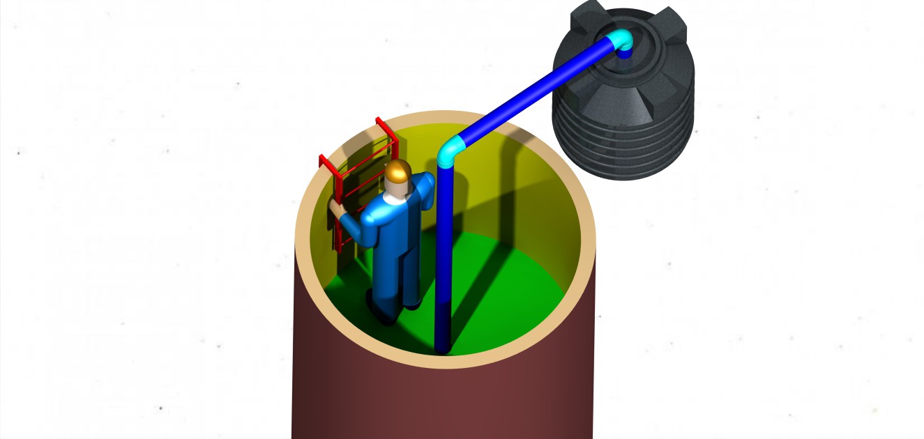

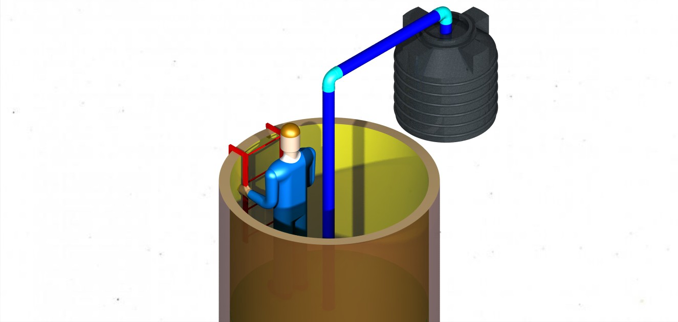

This is done by using the wall casing of the well as a large cylinder with surface area A1, a plate that act as piston on the static water level which is 4.76m to 7.8 meter depth so that a person(s) can stand on it acting as a self-pushing piston rod with force of F1 to push the water found at the static water level down forcing the water up in to the pipe with surface area A2 found on a center of the well with high force of F2 to direct it in to water tank found higher elevation.
The peoples who stand on the large pistons use an extendable ladder or rope ladder to go up without affecting the operating system of the piston. The peoples exert force of F1 that can be calculated from summation of their weight on to the water down ward since the only path of water is through the pipe located on the center of the well, water travel with a force of F2 calculated by multiplying F1 with surface area of the pipe divided by the surface area of the wall casing. This F2 force can also give as the height it will travel upward with ρgh analysis.
The only remaining system that is being developed at this time is the upward return system of the standing piston towards the static water level. We will use the rope ladder or the extendable ladder for people to go up and stop the force on the piston to reverse the mechanism.

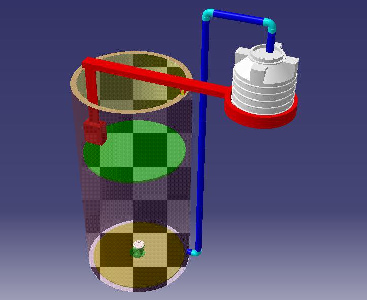

This new design is about using a weight balance system to push the piston downward incase weight of person is not enough to overcome the pressure of the water in the well. This will automate the whole system avoiding a person contact by using the water tank as a counter balance weight when enough weight water enters in to it. In opposite side of the weight balance there will be a load of X Kg enough to push water in the well to Y meter depth. Ideally the load weight and the water tank full of water have same weight. When the water tank is empty the load in the well will push the ground water down ward filling the water tank. As the water tanks starts to fill up it will start pulling the load up balancing the weight which will act as an automatic filling mechanism. When people use the water in the water tank the load will start pushing the piston down ward starting the filling process again.
3D model is not in actual size shown here. https://hackaday.io/project/202915-water-well-design-50/log/240442-piston-plate-downward-push

Florian Festi wrote 05/06/2025 at 08:44 point
Sorry to be blunt: This is not going to work and you are wasting your time.
The issue is the weight needed to press the piston down. You need a pressure that is high enough to lift the water to the level of the top of the pipe. For this you need a force equivalent to a cylinder of water of the same height but the area of the piston. So 2.5qm times 5m of water are 12.5 metric tons. No idea how to convert this to African women.
You are basically replacing a totally functional hand pump with a totally impractical and impossible to use pump.
Anteneh Gashaw wrote 05/06/2025 at 11:26 point
Thank you for your constructive feedback @Florian Festi  but you are wrong.
Please base your consideration on Pascal's law of incompressible liquid. a larger diameter piston can push a smaller diameter piston in Pascal's law and it will exert a greater force. Pascal's law states that pressure applied to an enclosed fluid is transmitted equally throughout the fluid. Because the larger piston has a greater surface area, the force exerted by it will be proportionally larger.
Yes, the weight of water does affect Pascal's Law, but it's a distinct factor from the pressure transmission described by the law itself. Pascal's Law, in its simplest form, states that pressure applied to an enclosed, incompressible fluid is transmitted undiminished in all directions. However, the weight of the water creates an additional pressure due to gravity, which increases with depth.
 Basic physics, Sir!
Florian Festi wrote 05/06/2025 at 11:50 point
You are reading the law wrong. Yes, pressure is transmitted everywhere. But force is pressure times area. So while the pressure is the same the force isn't. So indeed the force of the large piston will be larger - but this is a bad thing. This is the force you need to push down on the piston. The large piston gets a large force for a small pressure, but is also only creates a small pressure for a large force.
You need about 100 hPa per meter you want to move water up. So 300hPa for 3m. 300hPa * 2.5 m^2 = 30000 N/m^2 * 2.5 m^2 = 75000 Newton - so the weight of 7.5 tons.
If you don't believe me just calculate the energy put into the piston and ending in the raised water or build a model - before ruining a perfectly good well.
Anteneh Gashaw wrote 05/07/2025 at 10:19 point
@Florian Festi  Thank you very much for your comment. It is because of you I saw my design flaw.  Please see the improved system of the well and do tell me your thought https://hackaday.io/project/202915-water-well-design-50/log/240442-piston-plate-downward-push
Florian Festi wrote 05/07/2025 at 11:59 point
The whole idea is just beyond repair. You think a normal pump is too complicated and cumbersome. But you suggest building a pump with cylinder of 1.8m diameter and 5m height.
There are so many things missing or based on bad or at least questionable assumptions. Like
* The wall of the well is straight and smooth enough you can seal against it
* Water won't just be pushed out of the well and back into the ground
* The wall of the well is tight (most wells need large porous areas to let the ground water seep in).
* The piston needs some means to prevent it from tipping and/or jamming
* Water is not accumulating on top of the piston
Using the tank as a counter weight can only offset the increase in pressure from lowering/raising water levels but not the basic lifting. At the beginning the tank is empty and has (more or less) no weight. Using a static weight won't help you much as you need to lift is again to allow water back into the well.
If you don't like existing pump just build a better one. One that can be actuated by the feet or the whole body weight. The main thing about piston pump design is that you can easily match the force available to the pressure needed by choosing the right piston size. This whole idea is backwards in this regard.
