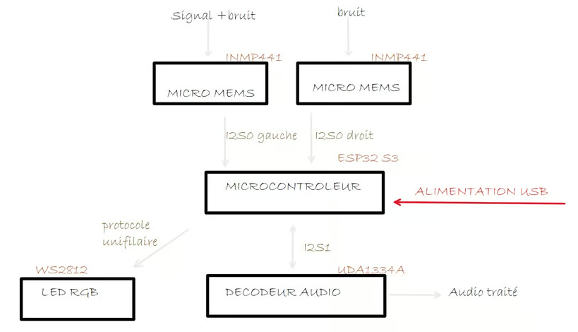

  • ESP32 DevKit (Xtensa LX6, dual-core, running FreeRTOS)
  • Two INMP441 digital microphones connected via I2S
    • Focus mic: captures signal + noise
    • Reference mic: captures mostly noise
  • Audio output: UDA1334 DAC connected to the second I2S port
  • RGB LED on the ESP32 dev board used to display real-time SNR

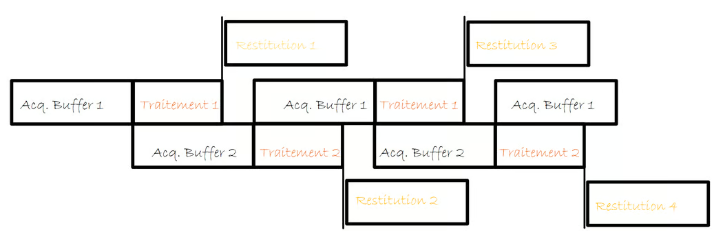

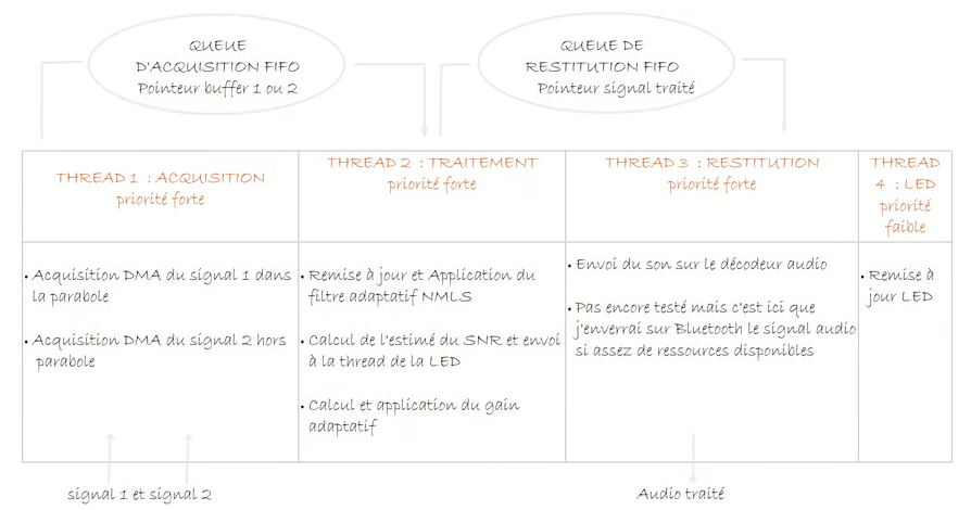

The NLMS filter is implemented in fixed-point arithmetic, with double buffering to ensure smooth real-time operation. The code runs under FreeRTOS, with a dedicated task for processing. Espressif’s optimized DSP functions are used whenever possible to improve performance (dot products, vector ops...).

The adaptive filter implemented here is a Finite Impulse Response (FIR) filter. It works by producing an output signal y(n), which is a weighted sum of the past values of the input (the noise reference from the second microphone). These weights — the filter coefficients — are continuously updated.
The goal is to make this output y(n) match the noise component present in the main microphone signal d(n), so that it can be subtracted. The error e(n) is the difference between the desired signal (signal + noise) and the estimated noise.
The filter uses the Normalized Least Mean Squares (NLMS) algorithm to adjust its coefficients. It does this by minimizing the squared error e(n)^2, which means it constantly tries to improve its estimation of the noise. Normalization ensures that the learning rate remains stable even if the input signal varies in amplitude.
This approach allows the system to adapt in real time to changing noise conditions and continuously clean the signal.
