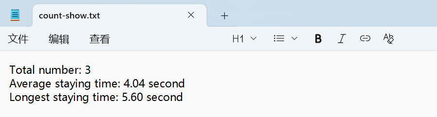

Generate Statistical Result Text

When a person enters the monitoring area, the system will automatically start timing until they leave the area. At the same time, it will count data such as "average stay time" and "maximum stay time", which are of great practical value. For example, in retail scenarios, it can show how long customers stay in front of which shelves; in exhibition halls, it can analyze which exhibition areas are the most attractive. The timing logic does not rely on network time, but is accurately calculated based on the frame rate of the picture, ensuring that even if the network is disconnected, it can be accurately recorded.
