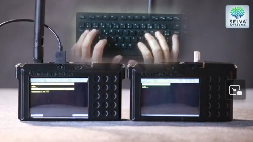

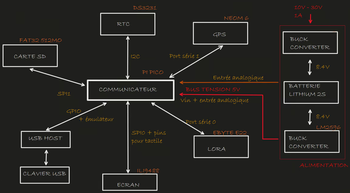

The terminal is built around a Raspberry Pi Pico microcontroller—chosen specifically for its simplicity and lack of opaque or inaccessible subsystems. A 3.5" SPI-connected IPS touchscreen offers a smooth interface for navigating between the message composer, address book, GPS tools, radio setup, and repeater mode.
Messages are typed using a standard USB keyboard connected via GPIO-based USB Host emulation—no proprietary chips required. This provides user comfort with a commonly available peripheral while keeping hardware costs and complexity low.
GPS coordinates are provided by a NEO-M6 module. Synchronization is handled by either GPS or a DS3231 real-time clock, which can remain accurate to within seconds for many months without adjustment.
The radio module is a LORA E22 400T, operating in the 410–480 MHz band. In favorable conditions, it offers a range of several tens of kilometers and reliable operation in semi-urban terrain. Transmission power and data rate can be dynamically adjusted for range or energy savings. Reed-Solomon error correction is implemented in software to improve reliability under poor radio conditions.
The terminal can act as a repeater, bridging two areas that cannot directly communicate. Messages are sent in fixed-length frames. The first frame includes source and destination addresses, optional GPS data, and 48 message characters. A second frame can carry 112 additional characters. GPS navigation tools allow users to compute distance and azimuth...
