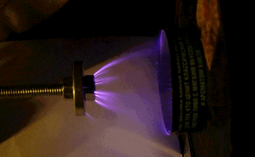

Instead, I discovered a simple ozone generator design online, based on a flyback transformer. It uses a frequency generator driving a flyback, producing a high-voltage corona discharge between the HV output and a grounded metal tube. Thanks to the ionic wind effect, no fan is needed to move the ozone.
Construction:
I found a flyback transformer with an internal diode from an old TV board. The original design used a low ~1kHz frequency, which is inefficient for flybacks (they prefer 15kHz+). I consulted the original author, who said that lower frequencies favored corona discharge rather than arcing — acceptable for this project.
I built the generator on a protoboard. After applying power, the flyback buzzed, and the transistor heated up — a good sign! When I carefully brought the HV electrode closer to the tube, I observed the corona discharge.
Since the flyback’s HV cable was very short, I soldered an extension with silicone-insulated wire and covered it with multiple heatshrink layers. For the grounded electrode, I cut a piece of an old curtain rod (23mm diameter, 120mm length) — luckily, it even had a PVC coating acting as insulation.

During initial testing, the device didn’t work — I had reversed the power polarity and fried the NE555 timer IC (rookie mistake!). Without a spare NE555, I adapted an ATtiny13 microcontroller.
I added a 78L05 voltage regulator and replaced the bipolar transistor with an IRFZ34 MOSFET. The microcontroller toggles the output pin at ~20kHz, improving efficiency and eliminating transformer buzzing.
Results:
The ozone generator worked perfectly! I used it to disinfect groceries inside a plastic bucket and to eliminate mould and odors in my basement. The device is reliable and effective — but remember to always work in a ventilated area with a proper respirator and gloves!
