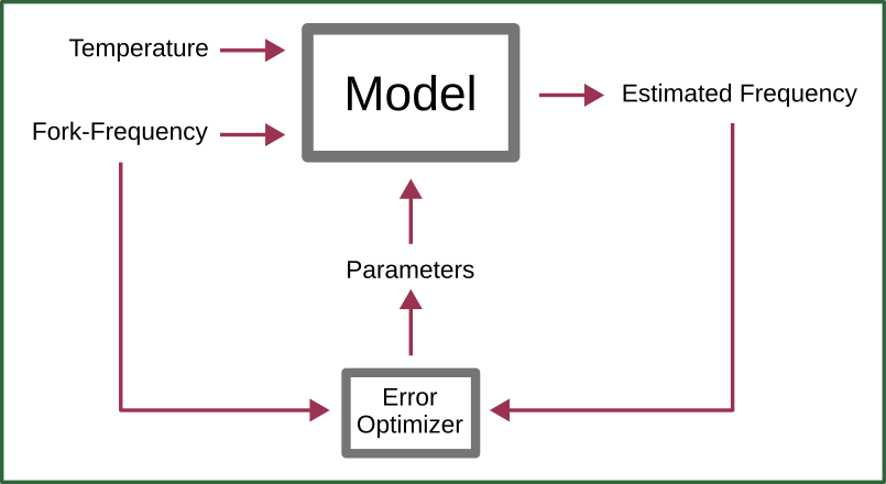

For that, I separate the usage into two phases: Measurement and Application.
In the measurement phase, I use a precise reference* to log the actual frequency against the temperature.
Also, offline on the computer, I try to find and apply functions that can model the seen behavior, and find/optimize the parameters to fit the measured frequency as good as possible.
In the application phase, I then use the offline-trained (No AI! Only statistics!) now-constants for the given model in the clock to estimate the frequency and thus, the passed time since startup. Showing the actual current time is then nothing more than adding an time offset at setting-the-clock on top of the passed-time-since-setting-clock.
So, just to wrap up: We shift what is "knowns" and "unknowns" in the phases. First, in the Fork Measurement Phase, we know the Fork frequency and temperature, but don't know the model parameters that fit the behavior.
Then, in the Application Phase, we don't know the true fork frequency, but know the model, its parameters, and the temperature to estimate that!
Currently, with a fresh calibration phase and without standing in direct sunlight (I can't model that unless I add an illumination sensor), it achieves a drift of ~2.5 seconds per three days, which results in around 10µs/s of drift! That is a factor of 100 better than uncalibrated, which I consider a project success :)
Concept of Measurement Phase

  • Calibration and the Model
    PP04/28/2025 at 09:05 0 comments
    Now that I have a steady oscillation, I can use the internal Quartz oscillator of the RP2040 to test my setup.
    Of course, that is not precise and also has a temperature coefficient, but for development I think that this is enough. Once the Process is settled, I can use an external and more precise reference with the same tools.
    A resolution problem comes up
    With a time reference of 1MHz (which I consider already high), the time between a single clock cycle at 440Hz is 2272.727µs. This poses a resolution problem, in where a single tick (µs) already can't resolve the exact (expected) frequency.
    So I instead measure the time that 440 oscillations take, which adds a factor of 440 on top of the resolution while still being around one measurement a second. I like to see seconds updating actually every second :D
    The process of finding some optimum was the usual data-science way: Fiddling around in python until something makes sense!
    The whole development is currently too long to write up for me, but basically I apply a simple polynom of the form `f(temp) = x1 + x2*temp + (x3*temp)^2`. This already finds a correlation and improves the estimation by a factor of 50:
    But, as you can slightly make out in Figure 2, the temp vs. period graph is not linear but has some "loops".
    This is caused by the tuning fork being of some considerable mass!
    It takes longer to get to temperature on temp changes than the faster sensor picks up. So I added a dampening model that adds a "low pass" to the temperature. This took a lot longer, because this dampening function is non-linear and can't be optimized by scipy. Well, it perhaps can, but I don't know how and the math is starting to get over my head :F
    ... So I track minima and maxima, and sample the mean time difference between temperature and frequency response, and linearize between some guessed sample points before optimizing the tempco polynom:
    More or less "final" estimation process
    So you know see the "damp factor". Please excuse the damp vs dampening misuse, I am not a native speaker :D
    Anyway, you can see the much more linear green dots in Figure 4 (correlation Data). The blue dots are the undampened samples. This actual measurement run went on for 5 Days, standing directly at a south-facing window, which I consider being the worst position, as sometimes the temperature goes from 20 Degrees up to 45 degrees (celsius)!  But this is probably good for calibration :)
    I suspect the sunlight being the last factor that I can't get out, so another run was recorded in a more calm environment, which surprisingly resulted in a much more linear behavior and thus less error at, tested in the application phase, around 10µs/s. Success!
    Now on to the display and final touches, and perhaps also an external reference to compensate the internal reference's drift that these runs could not consider.
