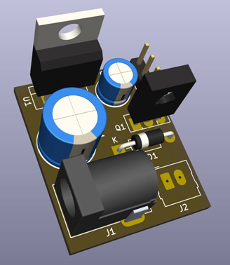

4. Lock control board: A 5V voltage regulator and a power switch to control the electromagnet

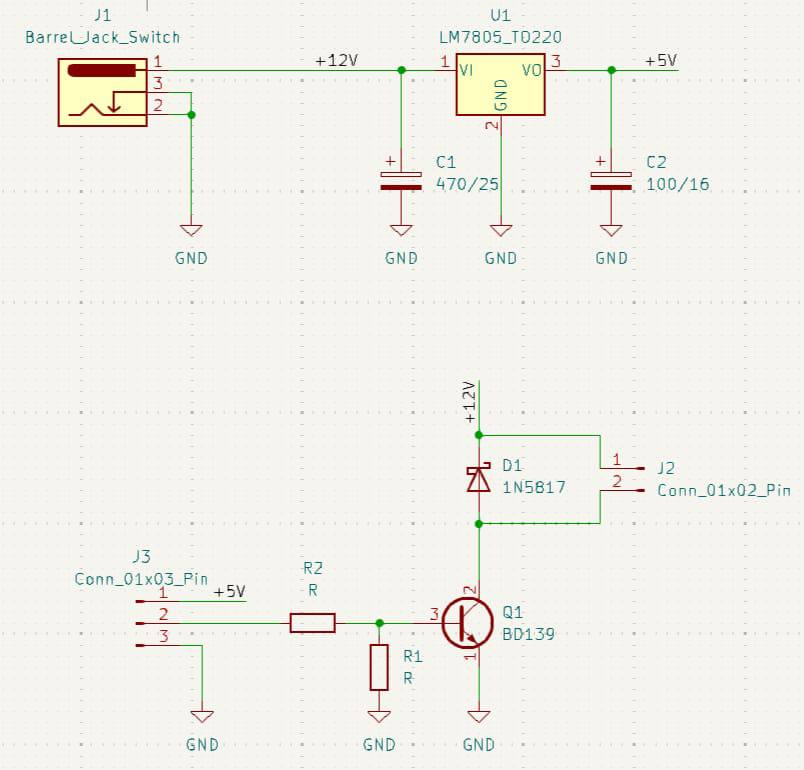

The lock control board performs two tasks:
- When connected to a power source, it supplies 5V to the GRC AI DevBoard via a regulator to power the board.
- It delivers 12V to the electromagnetic lock to open it upon receiving a signal from the GRC DevBoard. In other words, when the correct voice PIN is spoken, the GRC AI DevBoard triggers the transistor on the power board, sending voltage to the electromagnet and releasing the latch.
It can be assembled using the provided documentation or replaced with any suitable alternative—for example, a custom-built one using components from Electromagnetic Lock, and Crowtail-Relay 2.0.
The board’s schematic:

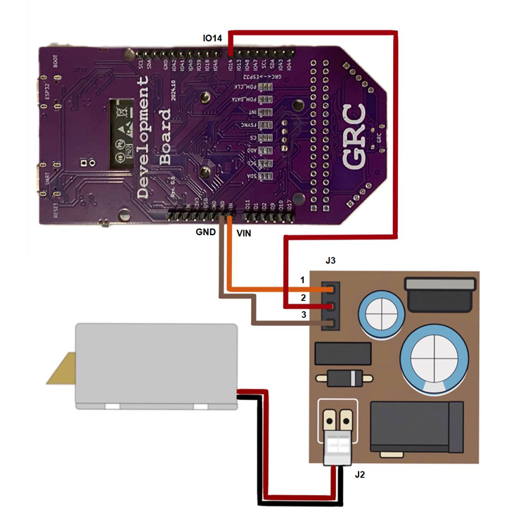

Next, let’s break down the wiring diagram for all components.
1. Connect the output on the power board (connector J3, pin 1) to the VIN pin on the DevBoard. This supplies the necessary 5V power.
2. Connect the ground (GND) from the power board (J3, pin 3) to the GND pin on the DevBoard.
3. To control the lock, link the GPIO_NUM_14 pin on the GRC DevBoard to pin 2 of connector J3 on the power board.
4. Connect the electromagnetic lock to connector J2 and the power adapter (with the plug) to J1 on the power board.

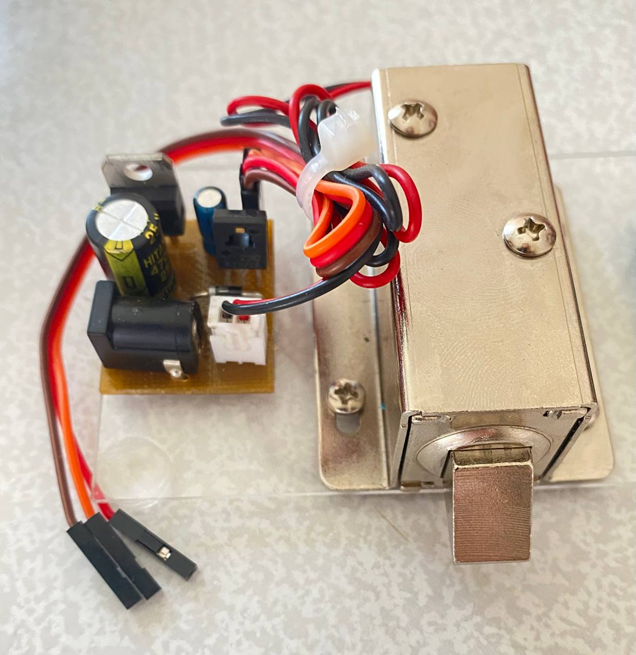

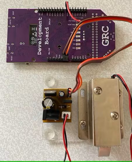

The fully assembled device looks like this:

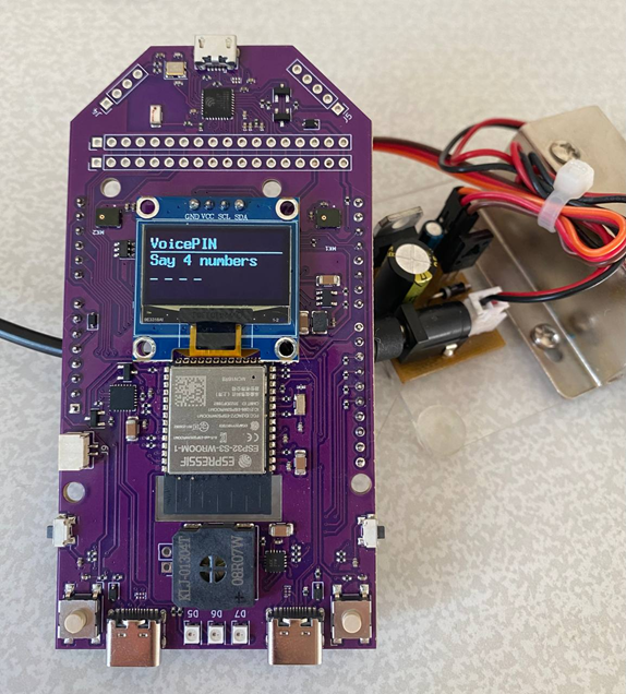

VoicePIN Setup & Operation
Upon first boot, you’ll need to create a PIN code. The user must speak four digits aloud, and the DevBoard will memorize them after confirming the new password.
Once saved, the device will prompt you to repeat the code and verify it against the initial input. If correct, the lock will open with a confirmation message. If not, the lock remains closed, and the DevBoard will notify you of the incorrect input.

This appears to share the same problem as with cheap electronic safes: an external magnet can be used to actuate the solenoid.
