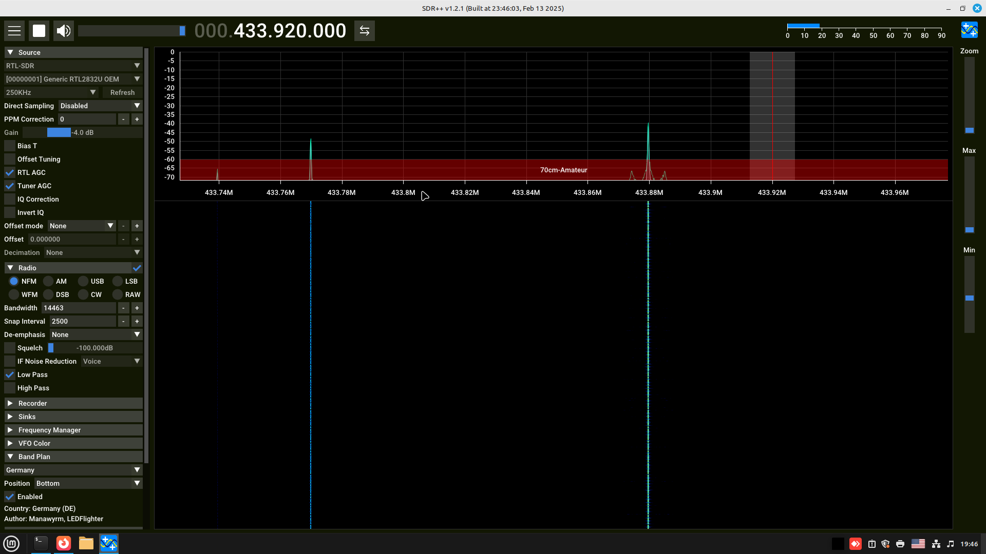

Today, s decided to test the SubGhz module on my (currently 15 USD) DIY Flipper zero.
As you can see, i find out, that transmision is happening on 433.88, instead of 433.92, and i believe, that it is caused by crysal on cheap chinesse module, so i decided to to find a way how to fix this in the FW.
Transmision on SDR
