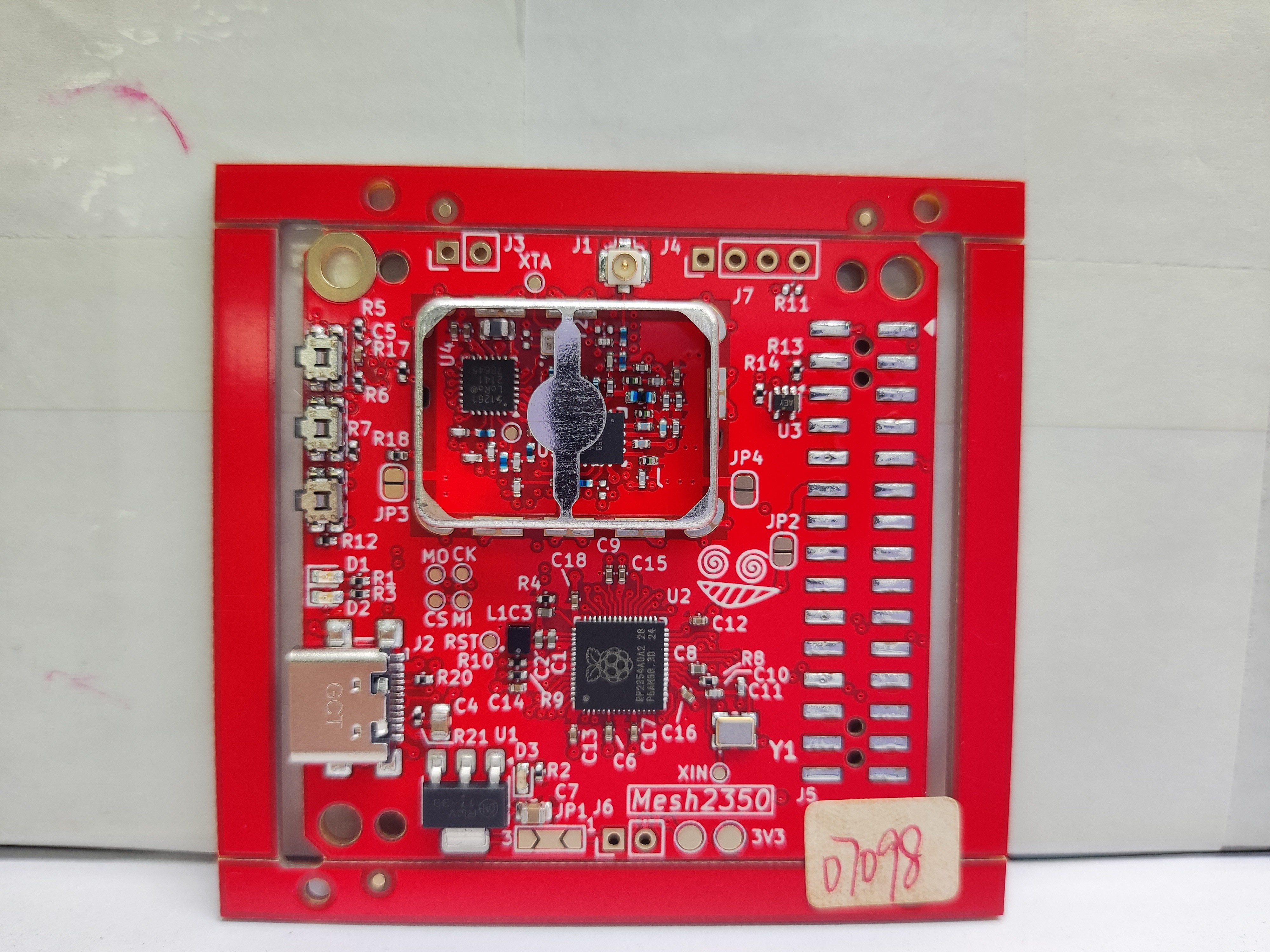

    After finishing the design of the initial revision, I ordered two board prototypes from NextPCB, who did a very good job on the resulting hardware and in supporting engineering questions, as well as handling PCBA. I was very satisfied with their service.
    Below you can see a board with all the components on, as shared by the engineering team at NextPCB:
    The bringup procedure
    Bringup is fairly straightforward, especially in standalone mode (i.e. powered by USB):
    • Connect USB cable to a PC port with a proper USB-C cable
    • Measure voltage on pin 3 of JP1 -> should be around 3.3V
    • Disconnect USB, close 2-3 of JP1
    • Reconnect USB while keeping SW2 (BOOTSEL) pressed (button in the middle)
    • RP2354 should mount as expected
    • Load test firmware into memory
    • Check if LEDs blink and messages are sent via the USB virtual serial port
    • Disconnect USB, close JP3
    • Reconnect USB and, using the test firmware, check that the connection with SX1261 is working as expected
    • Disconnect USB, close JP4, connect a proper antenna via J1
    • Reconnect USB and, using the test firmware, check frequency synthesis and infinite preamble mode with an SDR
    With these steps, all major functional blocks - except the M-BUS connection - can be tested.
    So, since this is the first revision of the board, I inevitably ran into issues almost immediately when performing the procedure :)

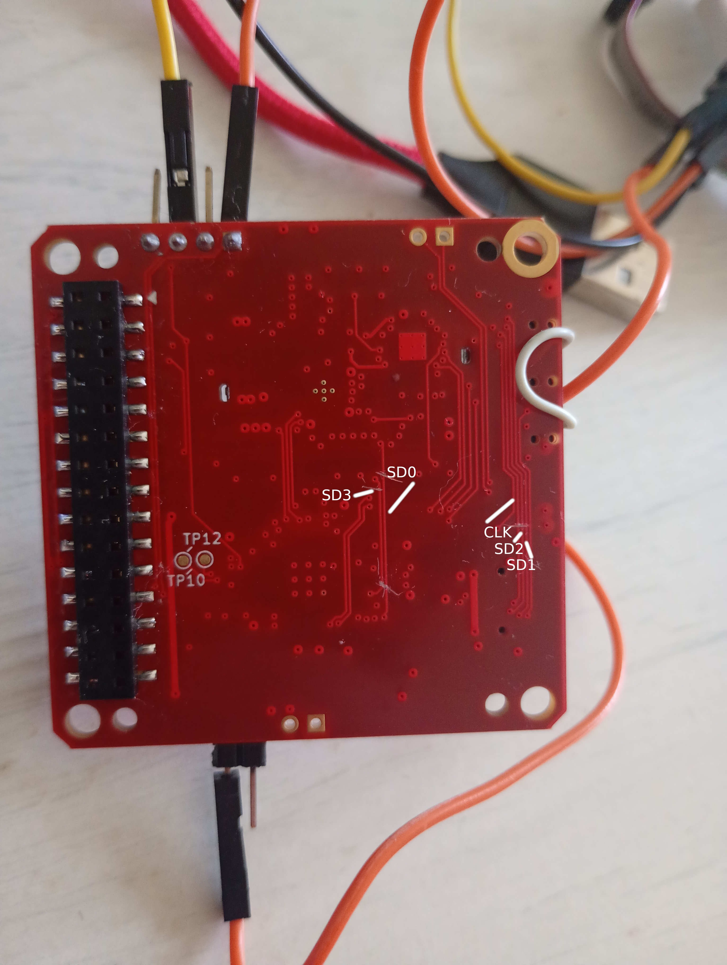

    RP2354 woes
    As mentioned previously, I wanted to tinker with the RP2354 (thanks to production samples offered via NextPCB) instead of other microcontrollers in order to save board space that would have been taken by the QSPI flash. It somehow would have fit on the board if I wanted to, but again, I just thought it would have been more interesting to use the new version with internal flash.
    Unfortunately, when routing the board, I missed an important section of the RP235x datasheet, i.e. 14.3, which states that
    "The six dedicated QSPI pads on the RP2350 die (CSn, SCK and SD0 through SD3) connect to both the internal flash die and the external package pins. [...]",
    which in turn means that if you're using the version with internal flash, you should leave those pins unconnected, otherwise you're possibly directly affecting the signal levels of the QSPI bus.
    Having missed that, I proceeded to route the SX1261 DIO, RST and BSY signal to those QSPI pins, since they were pretty convenient due to their position and facing direction. Oops.
    You can read more information about this whole "investigation" on the relevant thread on Raspberry official forums. Suffices to say, the RP2354 would show up as a mass memory, ready to accept UF2 files, but would not run the executable correctly. To mitigate this, the offending traces had to be cut away.
    With this (pretty ugly) hack I was able to finally boot functioning software via the UF2 loader, confirming that at least the rest of the circuit for the MCU was working as expected.
    Another issue I encountered though, was when I tried to connect a J-Link debugger to the SWD port (J4) to make sure the debug functionality was operating correctly. That also led to all matter of weird issues when trying to upload the firmware via the debugger. This was confirmed a debugger side issue by Segger support themselves, stating that the capability to interface with the RP2354 is currently planned, but still not implemented.
    Despite this, if the flash step is skipped and the debugger is only used to analyze execution of the existing firmware (i.e. via UF2), everything works as expected (except maybe flash breakpoints - still haven't checked those).

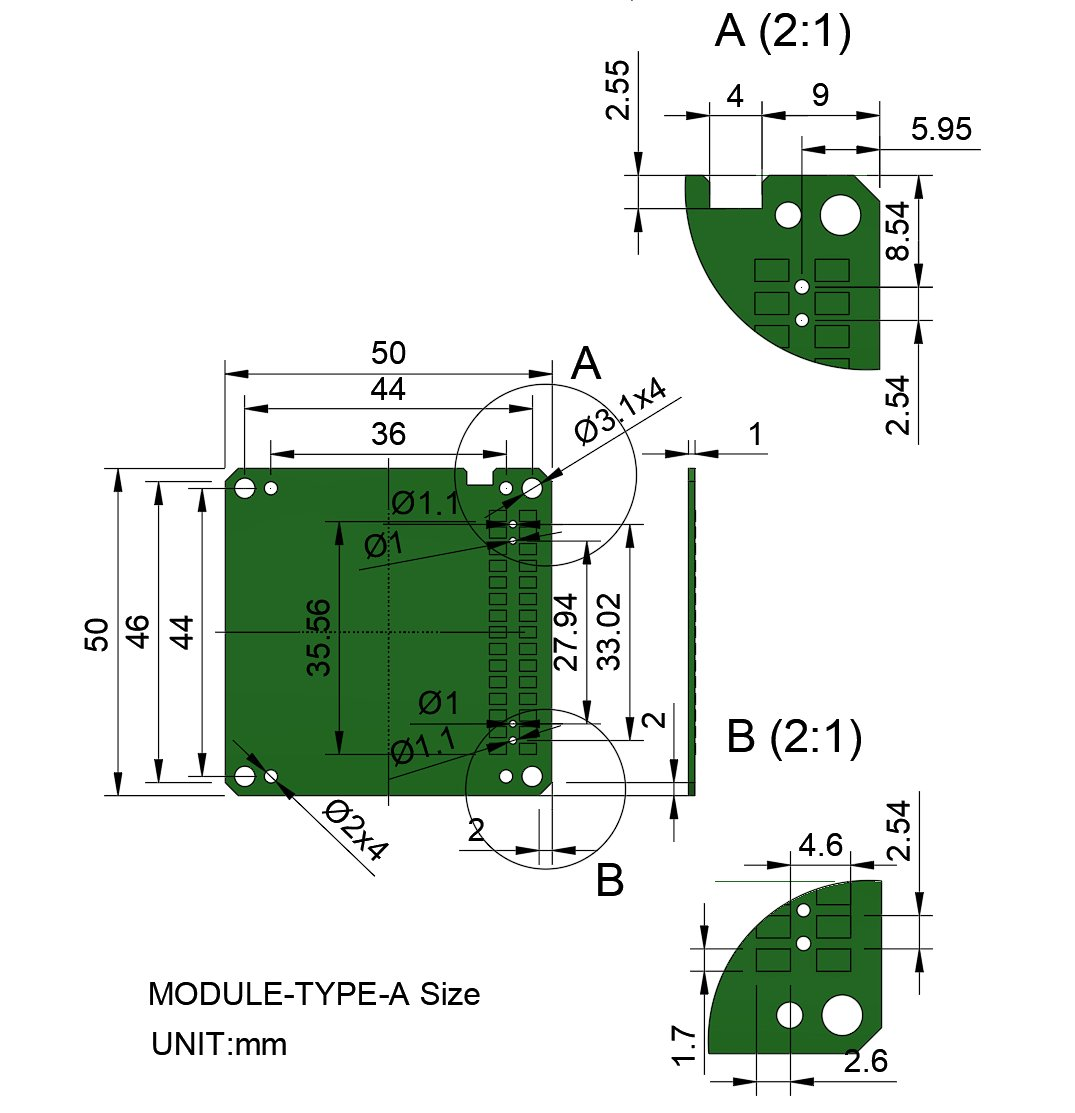

    The overall height of the board with its largest (tallest) elements does not quite fit beneath the M5Stack Core, at least not with the headers that M5Stack provides. I...

    From the attached figure, you can see that there are already two limitations regarding the position of ports and headers:
    • on the right side, the M-Bus (can't see that from the picture actually, but you can check M5Stack docs) takes up most of the available board outline
    • on the bottom side you have the keyboard
    You can see the general outline of the board from the picture below.
    So I ended up placing the ports I was most interested in to the left and top side of the PCB.
