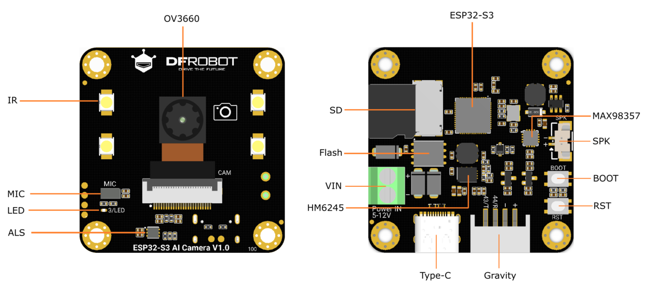

Let's have a look at the brain of this project, which is the new ESP32-S3 AI CAM made by DF ROBOT.
https://www.dfrobot.com/product-2899.html
The ESP32-S3 AI CAM is a powerful camera module built around the ESP32-S3 microcontroller and optimized for advanced video processing and voice interaction. It is designed for AI-powered applications and excels at tasks like video surveillance, edge-based image recognition, and conversational speech interfaces.
The ESP32-S3's strong neural network computing and signal processing capabilities enable the module's advanced image recognition and intelligent voice interaction features.
The ESP32-S3 AI CAM is powered by the Xtensa® Dual-core 32-bit LX7 microprocessor, which runs at 240 MHz and includes 512KB of SRAM and 16MB of Flash for efficient processing.
It has a high-performance OV3660 camera sensor with 2-megapixel resolution, a 160° field of view, and infrared sensitivity for better image identification. The module supports IEEE 802.11b/g/n Wi-Fi and Bluetooth 5 with Mesh capabilities, ensuring seamless connectivity.
With a wide operational voltage range (3.3V-12V) and Type-C input, as well as an operating temperature range of -10°C to 60°C, it is ideal for AI applications in a variety of conditions.

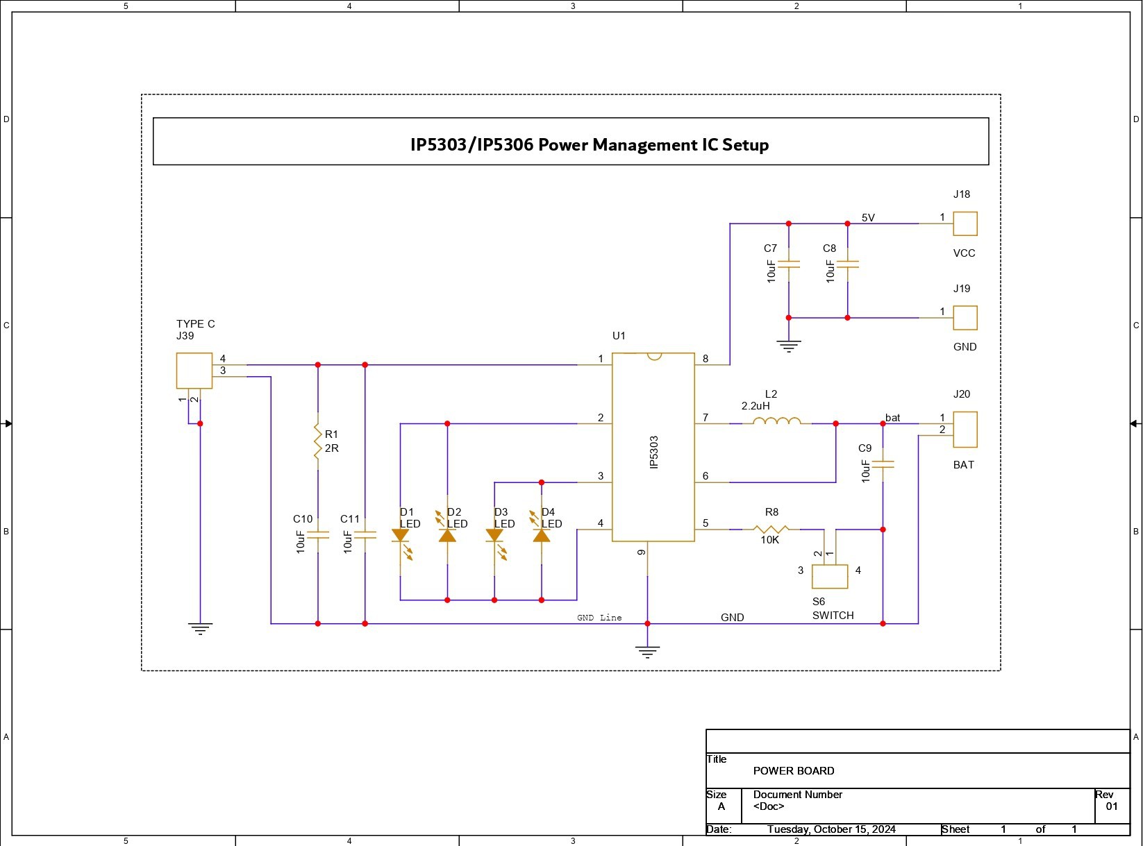

POWER CIRCUIT
We then designed the power board's schematic, which revolved around the IP5306 Power Management IC, which delivers a consistent 5V/2A of power from a 3.7V lithium battery.
After constructing the basic layout per the datasheet, we utilized a Cad file to add components such as the Type-C port, right-angle switch, and LEDs after converting the schematic to a board file.
After finalizing both boards, we exported their gerber data and shared it with HQ NextPCB for samples.

    We started by preparing the basic electronics setup, which includes the Power Circuit, the ESP32 S4 Camera Module, and the lithium polymer battery.
    • We begin by wiring the 5V out and GND of the Power circuit to the ESP32 S3's VCC and GND via connecting wires.
    • Next, we connected the Li-PO Cell's positive and negative terminals to the Power Circuit's BAT and GND contacts.
    The device powers on by pressing the power circuit's push button once. Double-tapping the push button will turn the device off.
