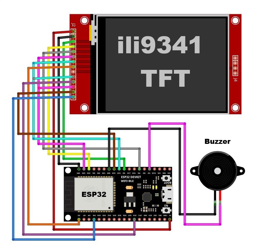

The hardware part is extremely simple and consists of only three components:
- ESP32 Development Board
- 3.2 inch TFT LCD Display ILI9341 driver with Touchscreen
- and small Buzzer
This project is sponsored by PCBWay. They has all the services you need to create your project at the best price, whether is a scool project, or complex professional project. On PCBWayyou can share your experiences, or get inspiration for your next project. They also provide completed Surface mount SMT PCB assemblY service at a best price, and ISO9001 quality control. Visit pcbway.com for more services.
It is very important to emphasize that if you use the display connection to the microcontroller in an identical way as in the given schematic diagram, then you must also use the given TFTesPI library adapted specifically for this project. Also, don't forget to tell you that I compiled the code with Arduino IDE version 1.8.16, and more importantly, ESP32 core version 2.0.4.

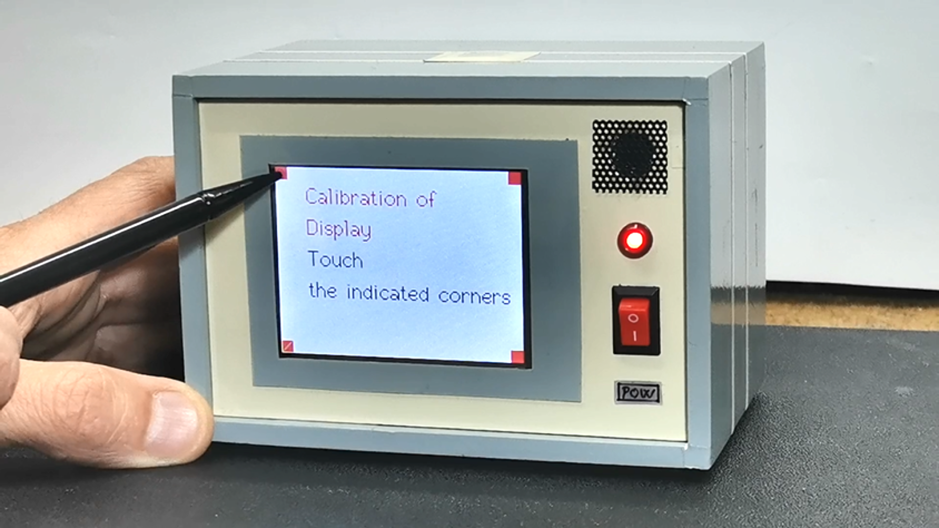

First, I will describe how to join as well as the options in the game. After turning on the device, a guide to calibrating the touch screen appears on the display.

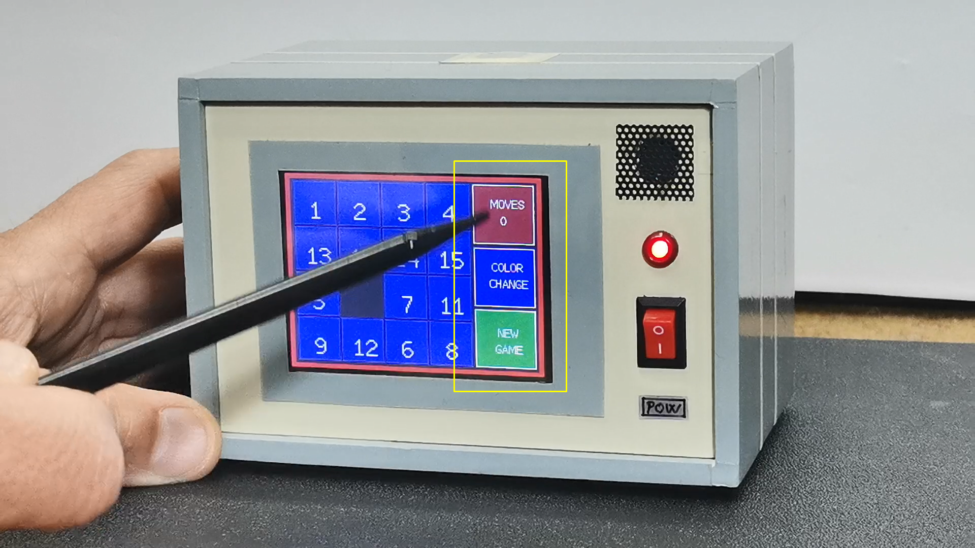

This is important because the game itself is played by touching the screen and it is crucial that it is well calibrated. We perform the calibration by pressing the four corners of the display in the specified order. Then the name of the game appears and we start the game by pressing the button. The playing field takes up most of the display, and on the right side there are three control-information buttons.
- The top button displays the current number of moves played. In fact, here we monitor the course and success of the game. Namely, the goal of the game is to arrange the numbers in as few moves as possible.
- With the middle button we can choose one of the five colors of the board we are playing on. This is a particularly useful option and we can use it at any moment of the game, without affecting the result.
- The bottom button is also used to start a new game. This button is functional both at the beginning and at any moment of the current game, if we get stuck with some positions. With each press of this button, a new game is randomly generated, so we can choose a game that at least visually seems easier to solve. All touches on the screen are accompanied by an appropriate sound, which makes playing easier and more interesting.

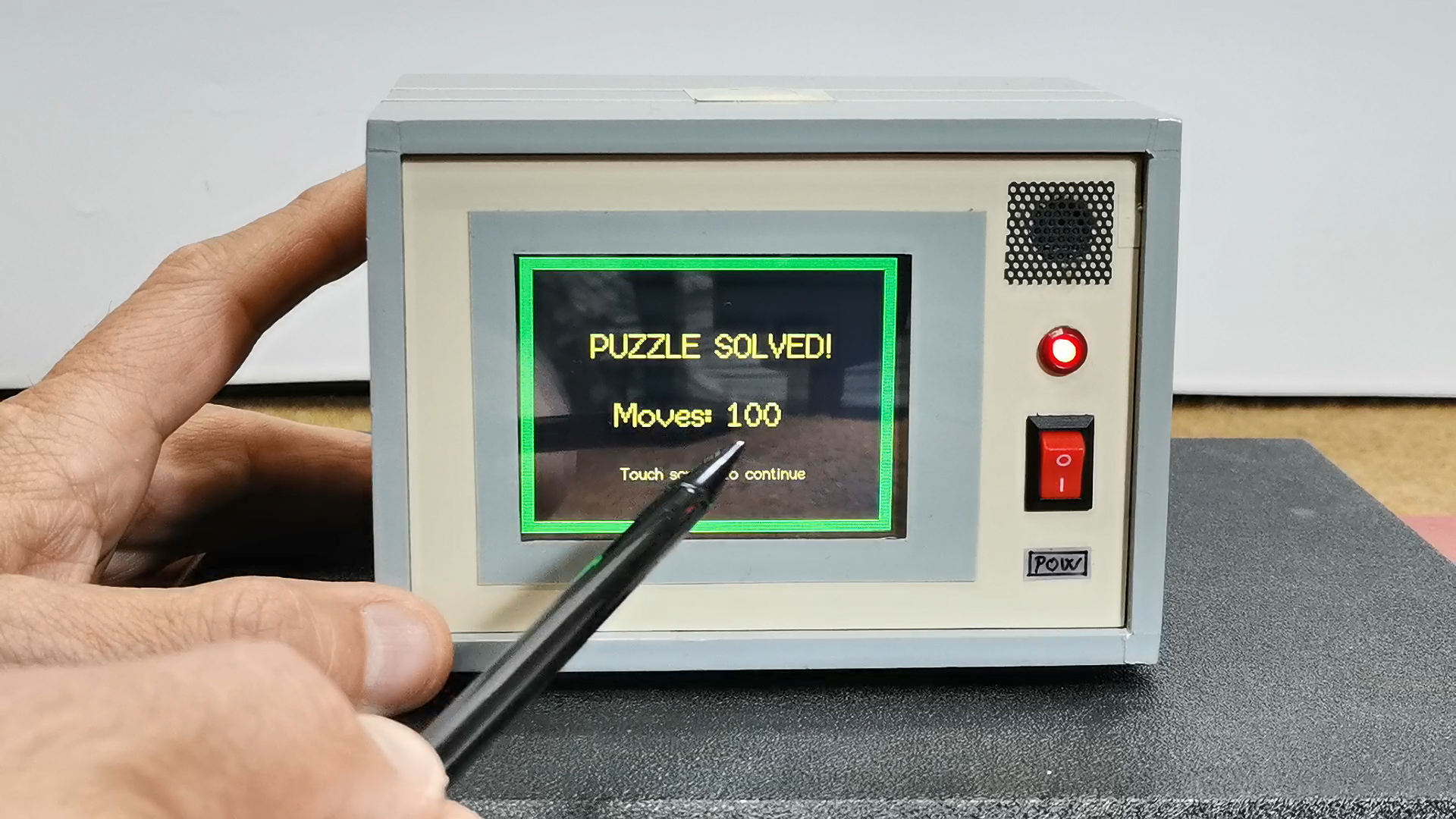

Finally, when we finish the game, a screen appears with information showing how many steps the puzzle was solved in, as well as a button to start a new game.

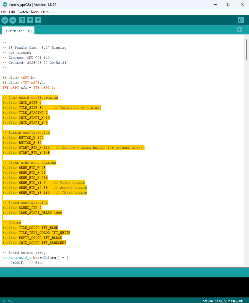

Just a few words about the code.
You can see that it is designed in a way that allows you to easily change most parameters, from tile spacing and size, to adjusting the sounds and colors in the game.
