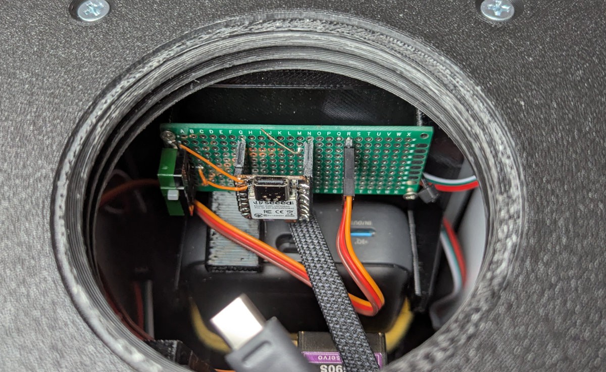

The timer is powered by a USB powerbank, mounted to the inner structure. There is a service opening at the top to access the controller, reset button and USB cable for charging.
The timer was successfully used for the Sunday lightning talks at Hackaday Europe 2025.

    The code is running on a XIAO nRF52840 Sense board using Zephyr RTOS (VS Code with nRF-Connect). It is my first Zephyr project, so still learning.
    • Peripherals:
      • Addressable LEDs (4x35) as one strip
      • 5 different countdown animations
      • Accelerometer for hour glass trigger
      • Servo (PWM)
      • (Microphone for future use)
    The LED animations are running in the main thread, the Servo control and timing for the alarm mechanism is in a separate thread triggered when the 1 minute is left.
