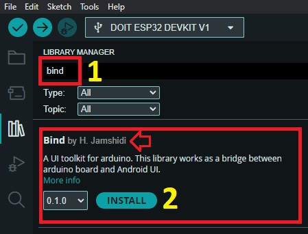

Installation
  • Install the library into your Arduino IDE

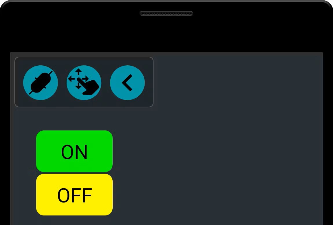

Let say we want to have two buttons on the screen like these controlling the LED:
Here is all the Arduino code you need to generates the above UI elements:

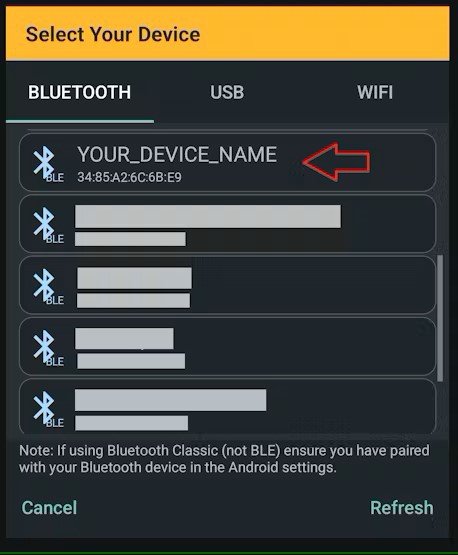

 Upload the code to your ESP32 boards and then open the BindCanvas App on your Android Device; press the connect button, and then in the connection dialog find you device name (we have chosen "YOUR_DEVICE_NAME" in the "bleStream.begin" function here)
Connect Button
Connect Button
Connection dialog
Connection Dialog
And that's it, you will magically see the objects on the screen and can interact with them.
Also if you don't like there positioning, you can move them around using move button and drag them around (you can later change your code to make it permanent)
Move Button
Move Button

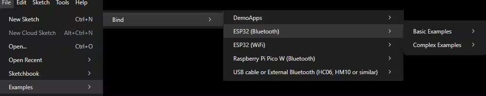

  • For this example I randomly used an ESP32-C3 but the example should work with any ESP32 boards
  • For other Arduino boards or for using WiFi check the example section of the library.
Bind Examples
Bind Examples
