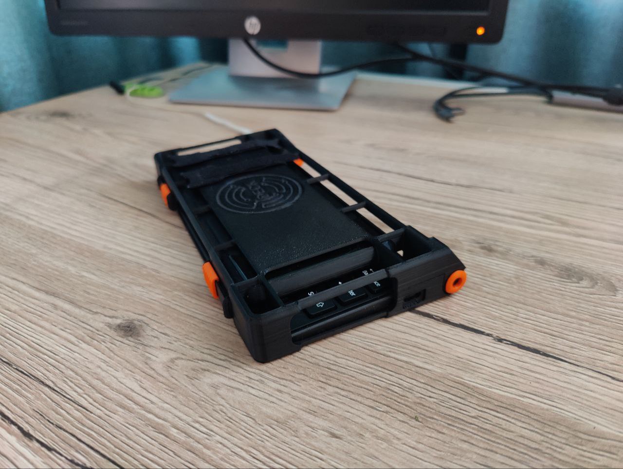

The Idea
This project converts a Google Pixel 3 XL smartphone into a clamshell-style palmtop, paired with a Bluetooth keyboard and enclosed in a custom 3D-printed case. The result is a compact, low-cost portable device ideal for field work, diagnostics, and general-purpose computing.
I’ve always been a fan of clamshell palmtops — a fascination that started years ago when I worked as a network field engineer. Back then, I used a NEC MobilePro 900 to configure and troubleshoot network equipment on-site. I really liked how practical and easy to use that form factor was.
Though the Pixel 3 XL is an older smartphone, it’s still a capable piece of hardware. By repurposing it and combining it with a folding Bluetooth keyboard, this project gives it a second life as a functional palmtop — one that’s easy to carry and quick to deploy.
The current version of the case securely holds both the phone and keyboard in a folding layout. I'm working on refining the 3D-printed design to make it easier to print, assemble, and customize for others who share a love for classic computing form factors.

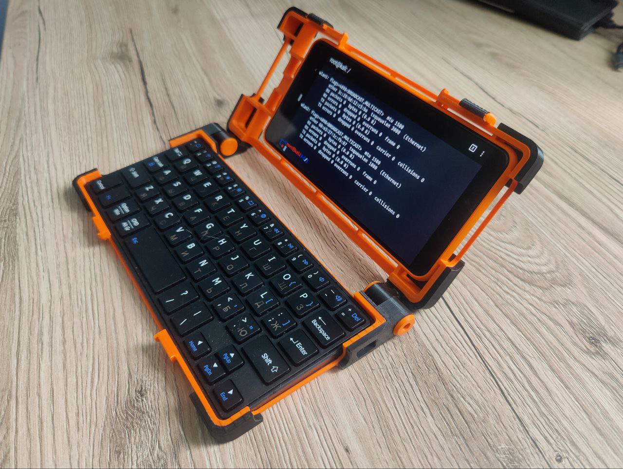

Version 1
The first version of this device was created with a rugged design in mind. It appears that this design could lead to a more sophisticated assembly. While it is nice to be able to make the device in two colors with a pretty attractive appearance, a less complex assembly will be prioritized in the next version.
Version 2
The second version of this device has fewer 3D-printed parts and are much easier to assemble. I've tried to preserve the device’s attractive appearance, even with fewer options for using different filament colors.

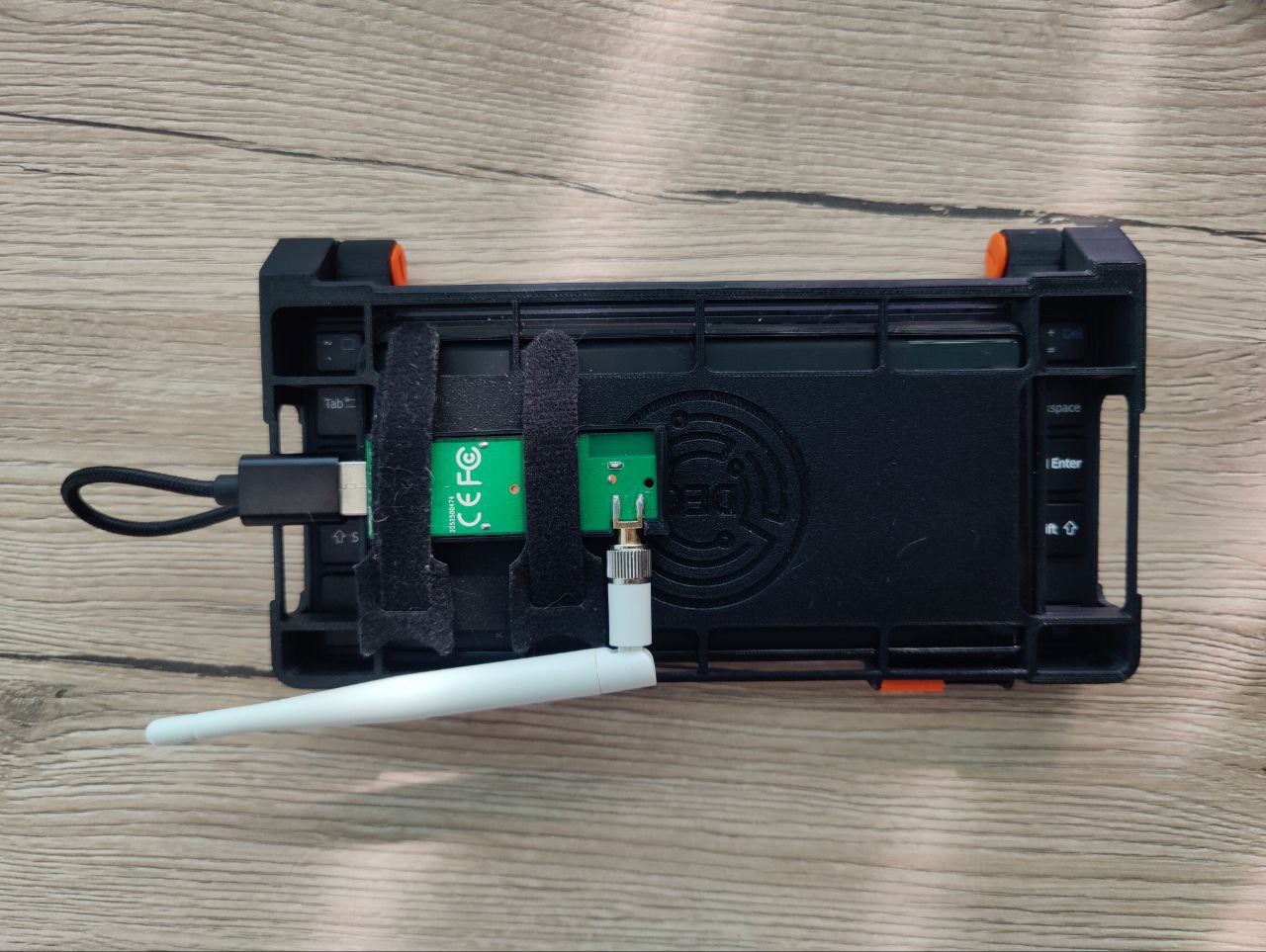

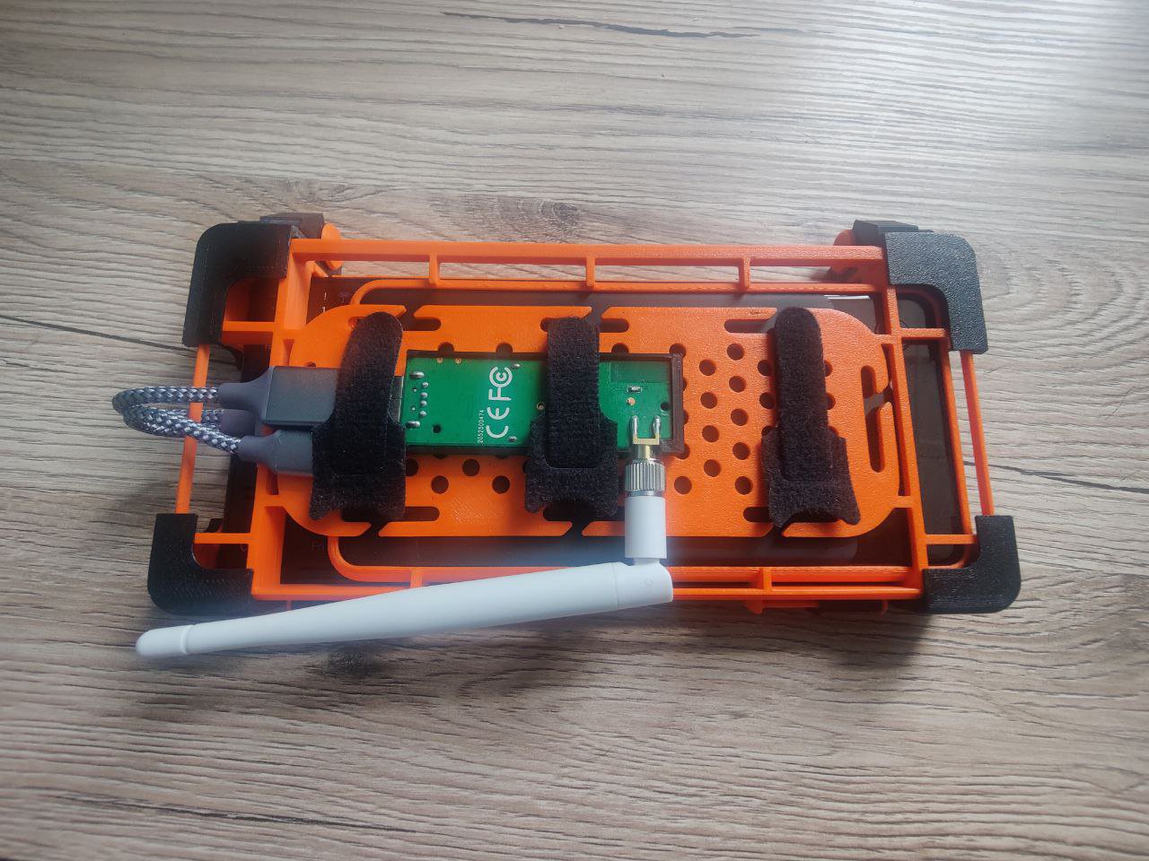

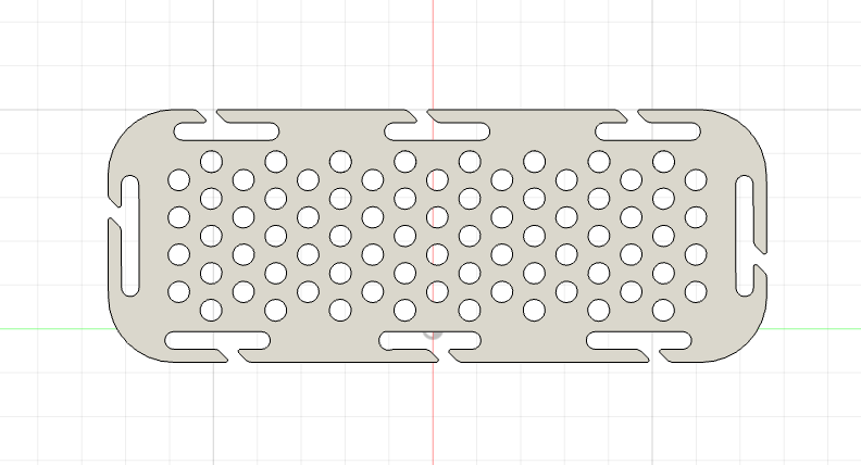

Both models have a panel on the back of the lid that can be used to mount external wireless modules connected via an OTG cable. I reused a panel I had originally designed for organizing cables in my work bag, but never ended up using
The panel's shape and design make it ideal for strapping external cards.

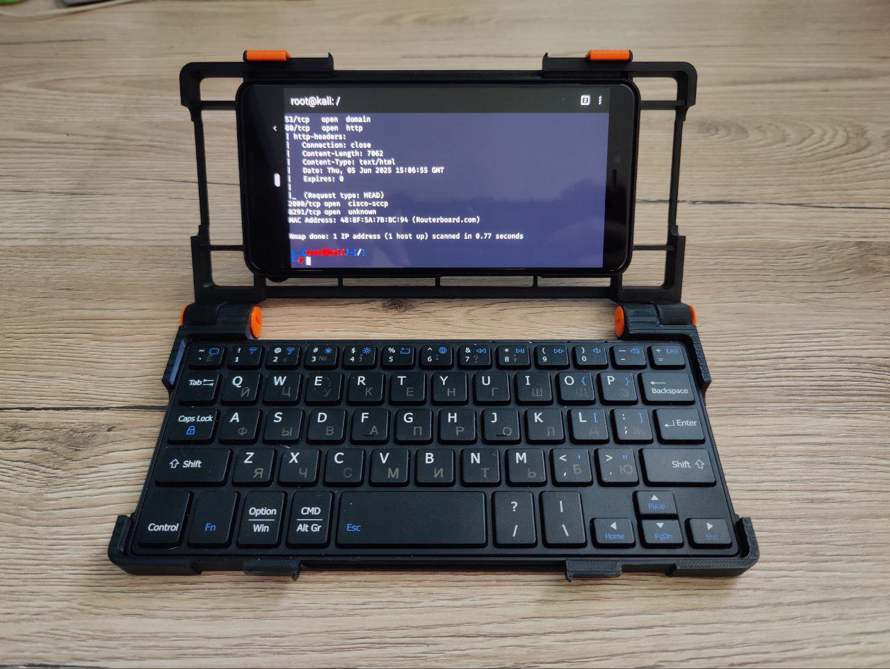

Version 2.1.0
This is the latest, and probably the final, version of this case. I’ve moved the phone to the center of the lid, removed the parts of the case that were meant for securing cables and external cards with plastic ties, and modified the upper panel design

  • Completed printing and assembly for v2.1.0
    Sergiy06/05/2025 at 19:11 0 comments
    I've printed and assembled version 2.1.0 of the case. It needs Velcro ties at least 200 mm long now. I really like how it looks.

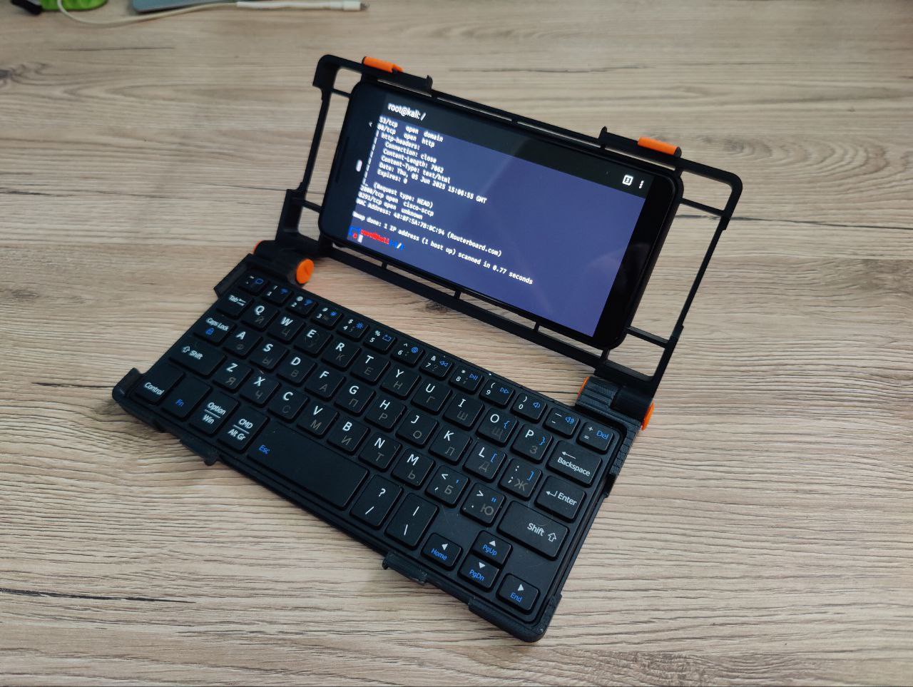

  • Design update v2.1.0
    Sergiy06/04/2025 at 08:29 0 comments
    After a few days of testing, I decided the OTG cable doesn’t need to stay connected all the time, so there’s no reason to hide its connector deep in the case. I also dropped the idea of using cable ties, which made the circular holes (and really the whole original panel design) unnecessary. Built a new  version of the case.

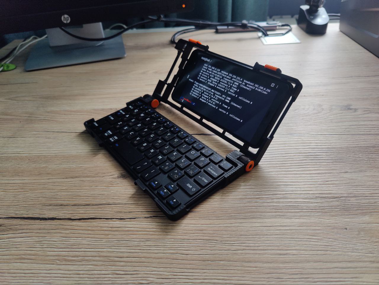

  • Completed printing and assembly of Version 2
    Sergiy05/24/2025 at 17:37 0 comments
    Just finished printing and putting together Model V2. It turned out a bit more work than expected. I had to do quite a bit of sanding and filing to get the parts to fit right. I tweaked the design and made a 2.0.1 version to fix the worst of it, but it still needs some cleanup after printing.

Out of interest, what's the external aerial and circuit board shown in the pictures, it's not in the list of parts?
Sergiy wrote 05/21/2025 at 16:39 point
This is "naked" TP-LINK TL-WN722N wireless card which is pretty common device for testing 2.4 WiFi network. I've added a custom minimal casing 3d model for it in the files.  I used it to depict the use of the panel on the back side.
