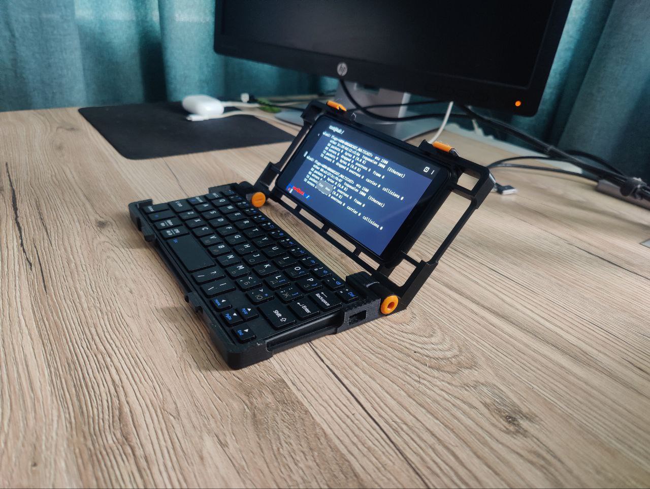

The Idea
This project converts a Google Pixel 3 XL smartphone into a clamshell-style palmtop, paired with a Bluetooth keyboard and enclosed in a custom 3D-printed case. The result is a compact, low-cost portable device ideal for field work, diagnostics, and general-purpose computing.
I’ve always been a fan of clamshell palmtops — a fascination that started years ago when I worked as a network field engineer. Back then, I used a NEC MobilePro 900 to configure and troubleshoot network equipment on-site. I really liked how practical and easy to use that form factor was.

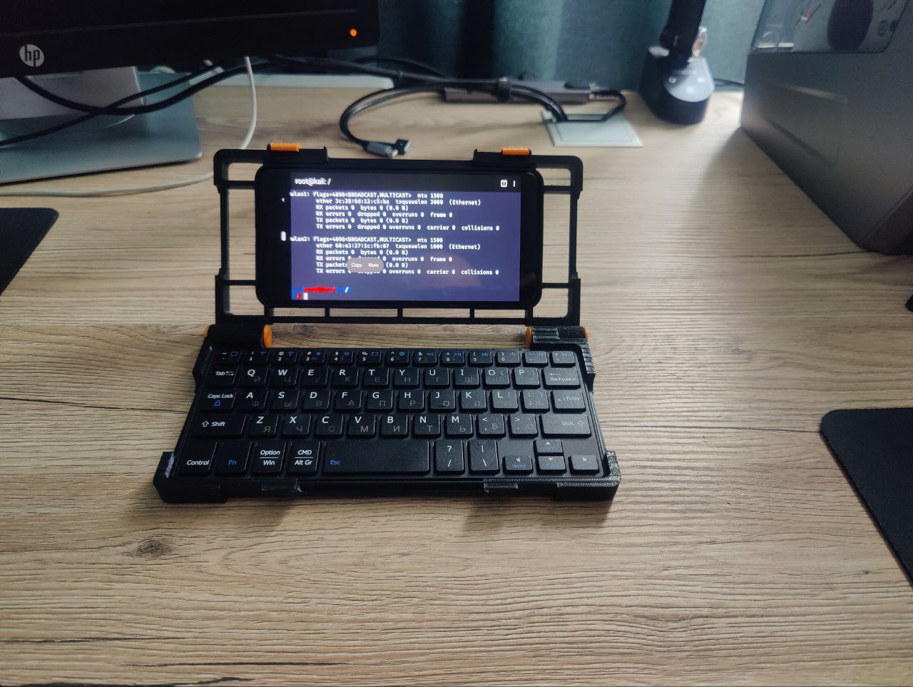

Though the Pixel 3 XL is an older smartphone, it’s still a capable piece of hardware. By repurposing it and combining it with a folding Bluetooth keyboard, this project gives it a second life as a functional palmtop — one that’s easy to carry and quick to deploy.
The current version of the case securely holds both the phone and keyboard in a folding layout. I'm working on refining the 3D-printed design to make it easier to print, assemble, and customize for others who share a love for classic computing form factors.

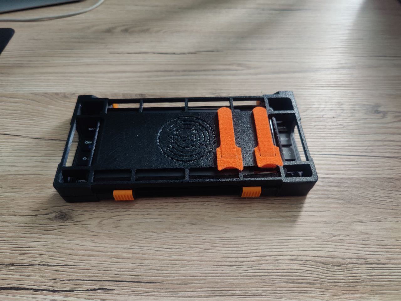

Both models have a panel on the back of the lid that can be used to mount external wireless modules connected via an OTG cable. I reused a panel I had originally designed for organizing cables in my work bag, but never ended up using
The panel's shape and design make it ideal for strapping external cards.

This is the latest, and probably the final, version of this case. I’ve moved the phone to the center of the lid, removed the parts of the case that were meant for securing cables and external cards with plastic ties, and modified the upper panel design

    I've printed and assembled version 2.2.0 of the case using PETG. It can't be captured in a photo, but the device feels much nicer to the touch, and the resulting print is significantly more dimensionally accurate.

    After a few days of testing, I decided the OTG cable doesn’t need to stay connected all the time, so there’s no reason to hide its connector deep in the case. I also dropped the idea of using cable ties, which made the circular holes (and really the whole original panel design) unnecessary. Built a new  version of the case.
