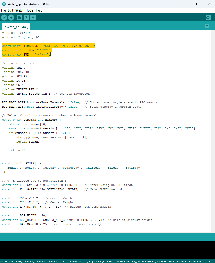

   As for the code, as you can see, it is designed in a way that allows you to easily change the basic graphic parameters, so you can easily create a custom-looking clock face according to your own ideas.
It is important to mention that the exact time is downloaded via the Internet according to the time zone in which you live. For other time zone definitions have a look at thePosix Timezones Database . You also need to enter the credentials from your local Wi-Fi network.

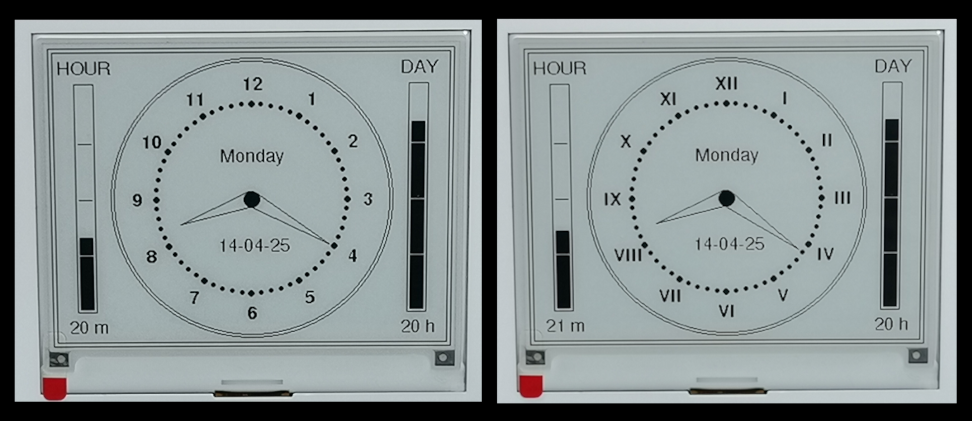

   Now let's see how the device works in real conditions. After switching on, a certain amount of time should pass while the clock connects to Wi-Fi and downloads the correct time. Then the clock appears in an analog style drawn on a white background. It shows the correct time, the day of the week, as well as a full date in the format day/month/year.
On both sides of the clock there are two progress bars. The right one shows the elapsed time of the current day in graphical form, and the lower part shows the numerical value of this information. Similarly, the left progress bar shows the elapsed time of the current hour, also in graphical and numerical form. For a better visual representation of the elapsed time, the two progress bars are divided into four parts, with one part on the right bar representing 6 hours, and on the left bar, 15 minutes.
   As I mentioned earlier, the display module contains several buttons, so I used two of them for additional options. By pressing the upper button, the numbers that indicate the hours are transformed from Arabic to Roman.
 By pressing the button again, they return to their original state. Now, by pressing...
