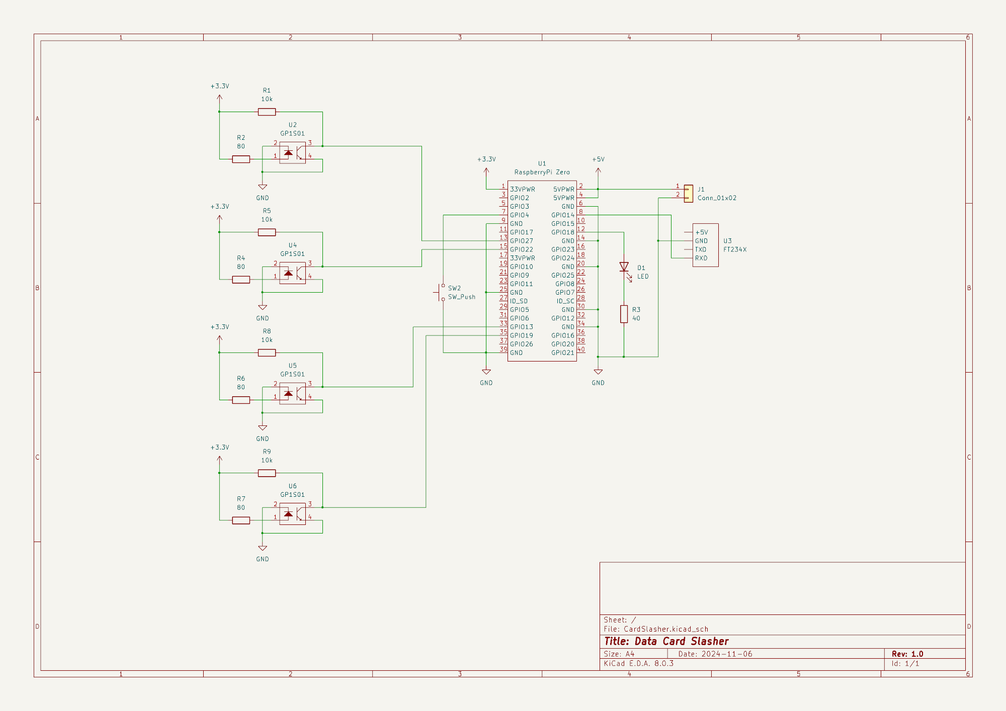

This controller has two magnetic card readers. The player plays this game by sliding the magnetic cards. This is a USB reader, but there is no mechanism to detect the direction of the slide. That means this reader can read the magnetic cards by sliding it from either side. So I installed photo interrupters on both ends of the card reader. This allows the controller to detect the direction from which you slide.
The controller sends slide data to the PC by serial communication.

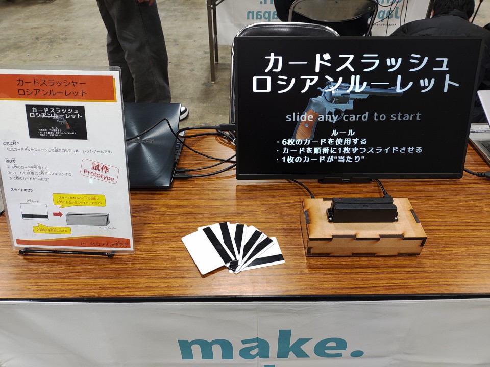

I was prototyping a controller that consisted of only one card reader. This is a Russian roulette game with six cards. One of the cards will set off the gun, the person who slid it lost. It’s a party game.
