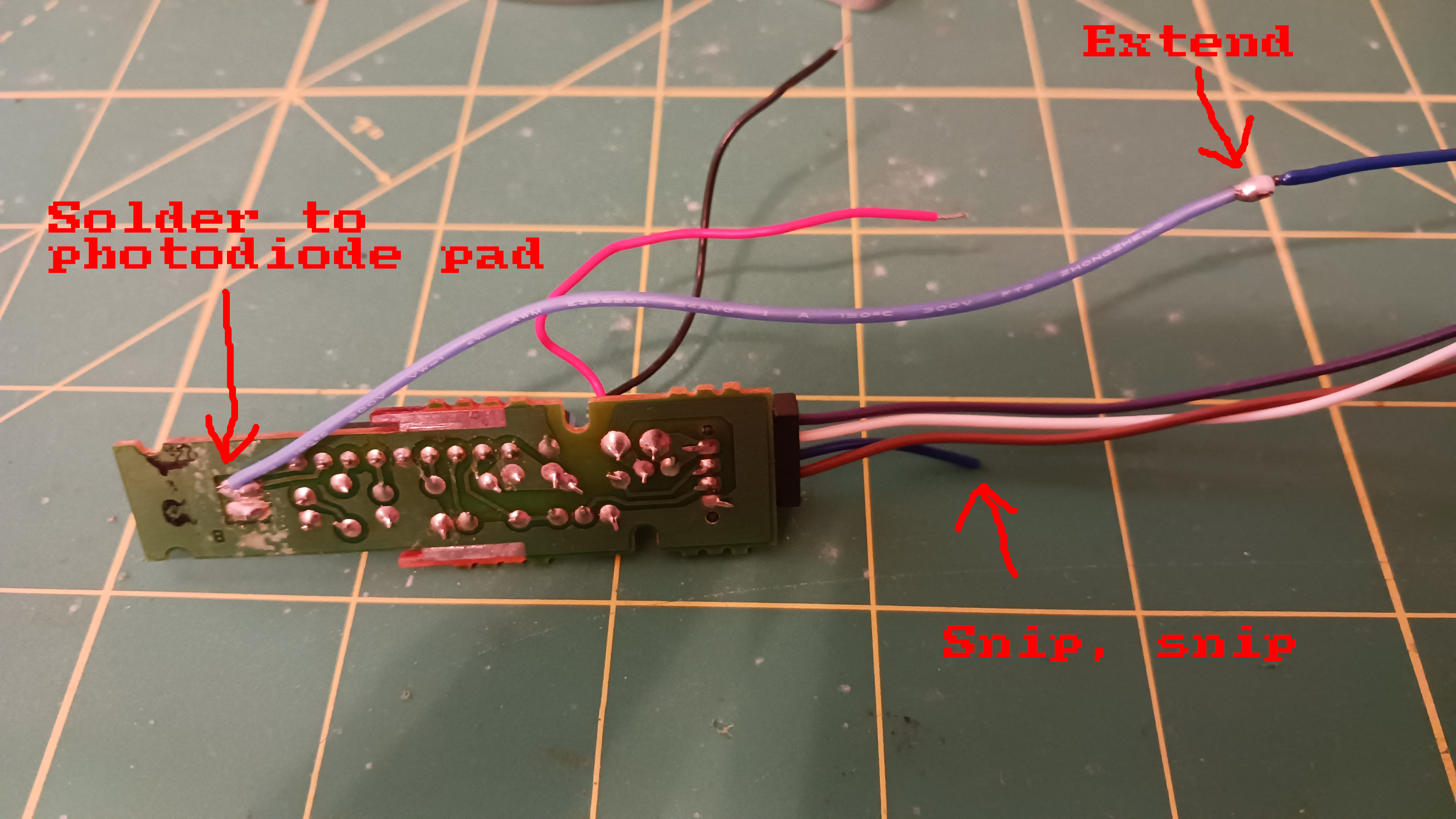

The NES Zapper has anti-cheating mechanisms built into it that prevent it from being used for anything other than a light sensor that is tuned to the specific frequency of the electron beam of a CRT TV. After making my Zapper deep dive video, I realized that I could bypass these protections by rerouting the "hit" indicator signal directly to the photodiode itself.
Because of this mod, the hit indicator now gives me an analog signal representing the intensity of the light striking it. That means I can encode audio into light by modulating its intensity, and shine it at the Zapper. Then I can feed the signal from the hit indicator line directly into an audio amplifier and the sound will be reproduced.

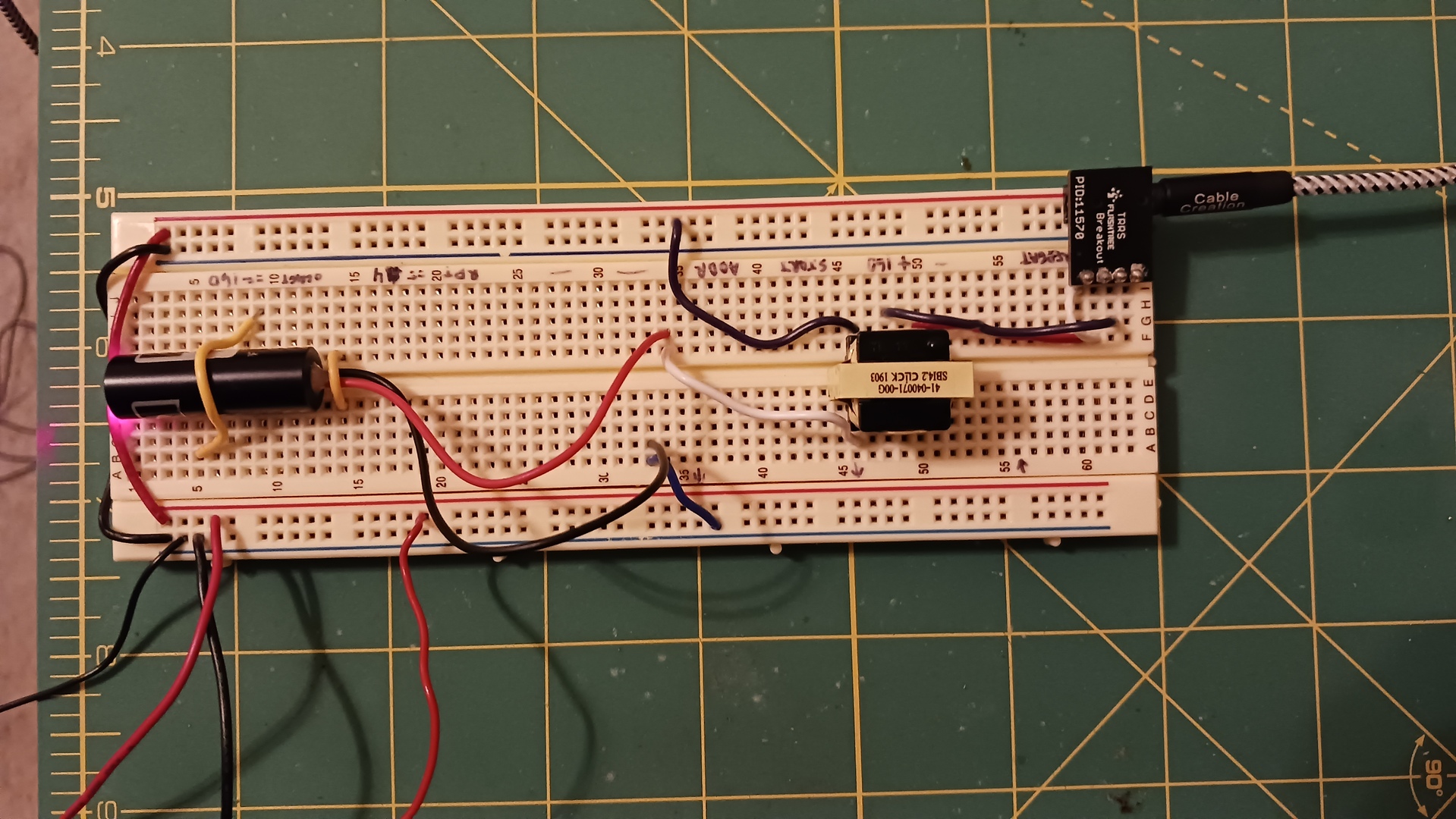

The transmitter

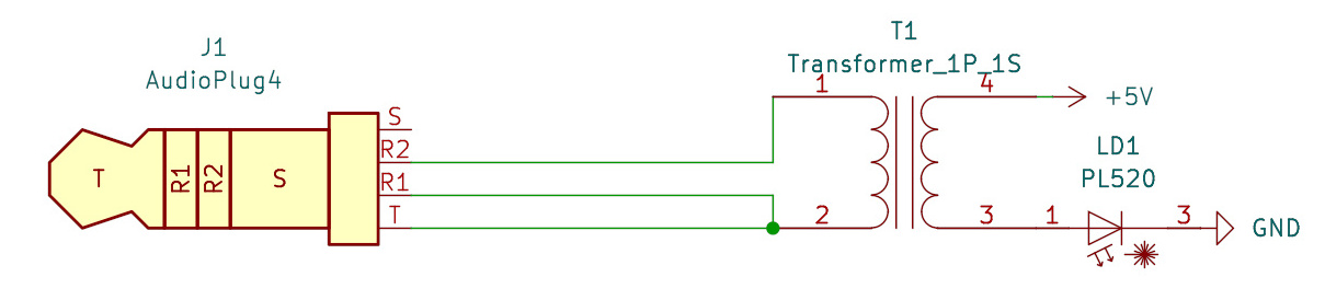

Here is a schematic for the transmitter. It is quite simple. The audio comes in through a TRRS jack, from a microphone, phone, or whatever else you want to use. That signal is passed through a transformer, which removes any DC components from the signal.
The other side of the transformer is in series with the power supply for the laser. Because it is coupled with the audio input, it modulates the intensity of the laser beam, encoding the audio.

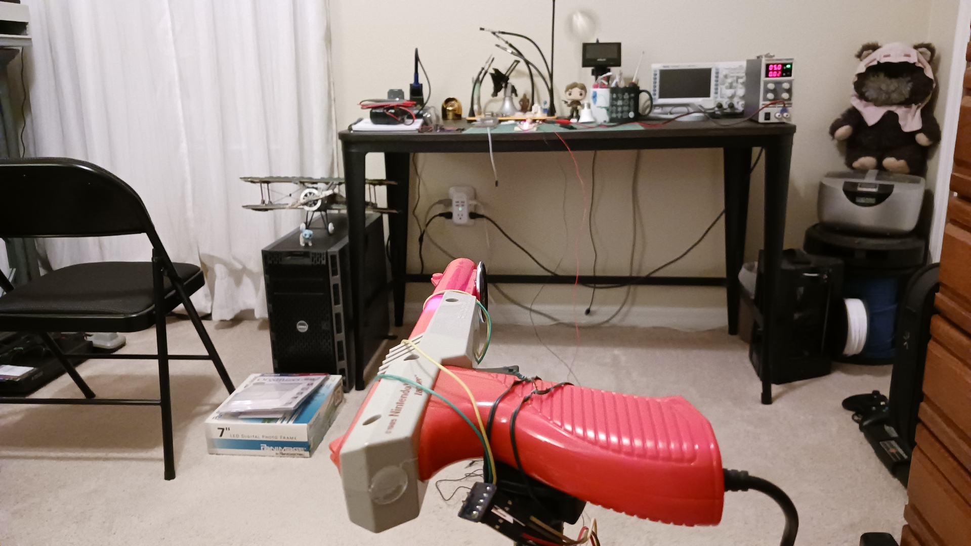

Check out the video to see a demo of the Zapper Phone in action.
While the audio quality is very good, the Zapper Phone makes a very bad phone. It requires a direct line-of-sight with a laser, and it has to be aligned almost perfectly to work. But I think it's interesting that this old dog could learn a new trick after all these years just the same.
