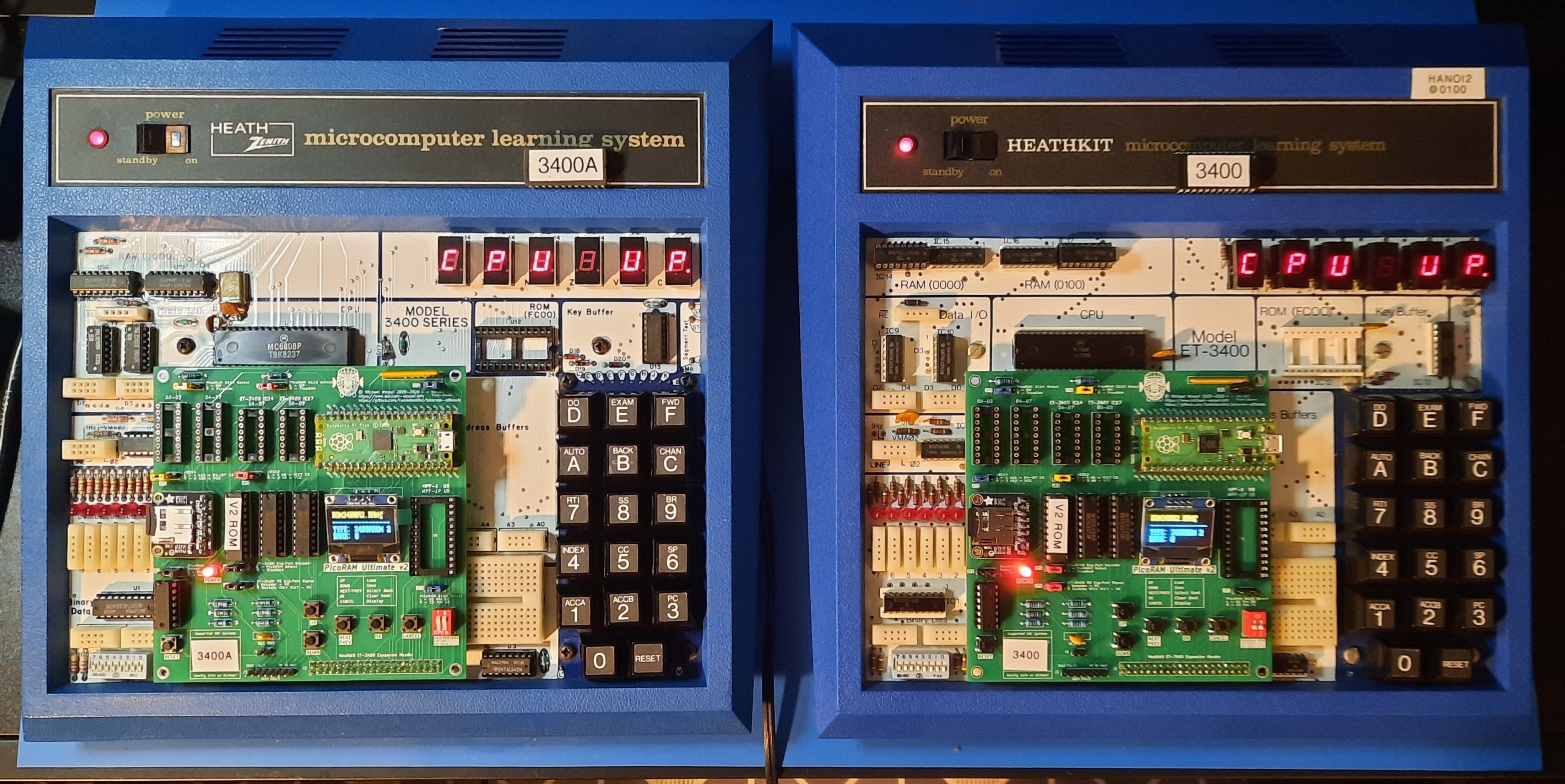

Currently supported SBCs / host machines are:

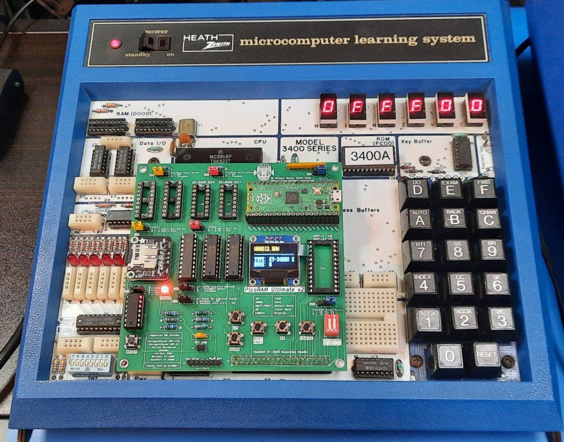

  • Stock Heathkit ET-3400: MC6800 CPU, either 2x 2112 (256 Bytes) or 4x 2112 (512 Bytes)
  • Stock Heathkit ET-3400A: MC6808 CPU, 2x 2114 (512 Bytes only!)
  • Heathkit ET-3400 memory expansion mode: MC6800 CPU, 4 KBs via expansion header and additional GAL16V8 address decoder
  • Heathkit ET-3400A memory expansion mode: MC6808 (or MC6802) CPU, 4 KBs via expansion header and additional GAL16V8 address decoder
  • Multitech Microprofessor MPF-1, MPF-1B and MPF-1P: Z80 CPU, 1x 6116, 2 KBs
  • Lab-Volt 6502: 6502 CPU, 2x 2114, 1 KB
  • Philips MC6400 MasterLab: INS8070 SC/MP III CPU, 2x 2114, 1 KB
  • Heathkit ET-3400 & ET-3400A ROM emulation: either 2 or 4 KBs of emulated ROM, and it is possible to replace the monitor (EP|P)ROM (i.e., with your custom ROM monitor program).

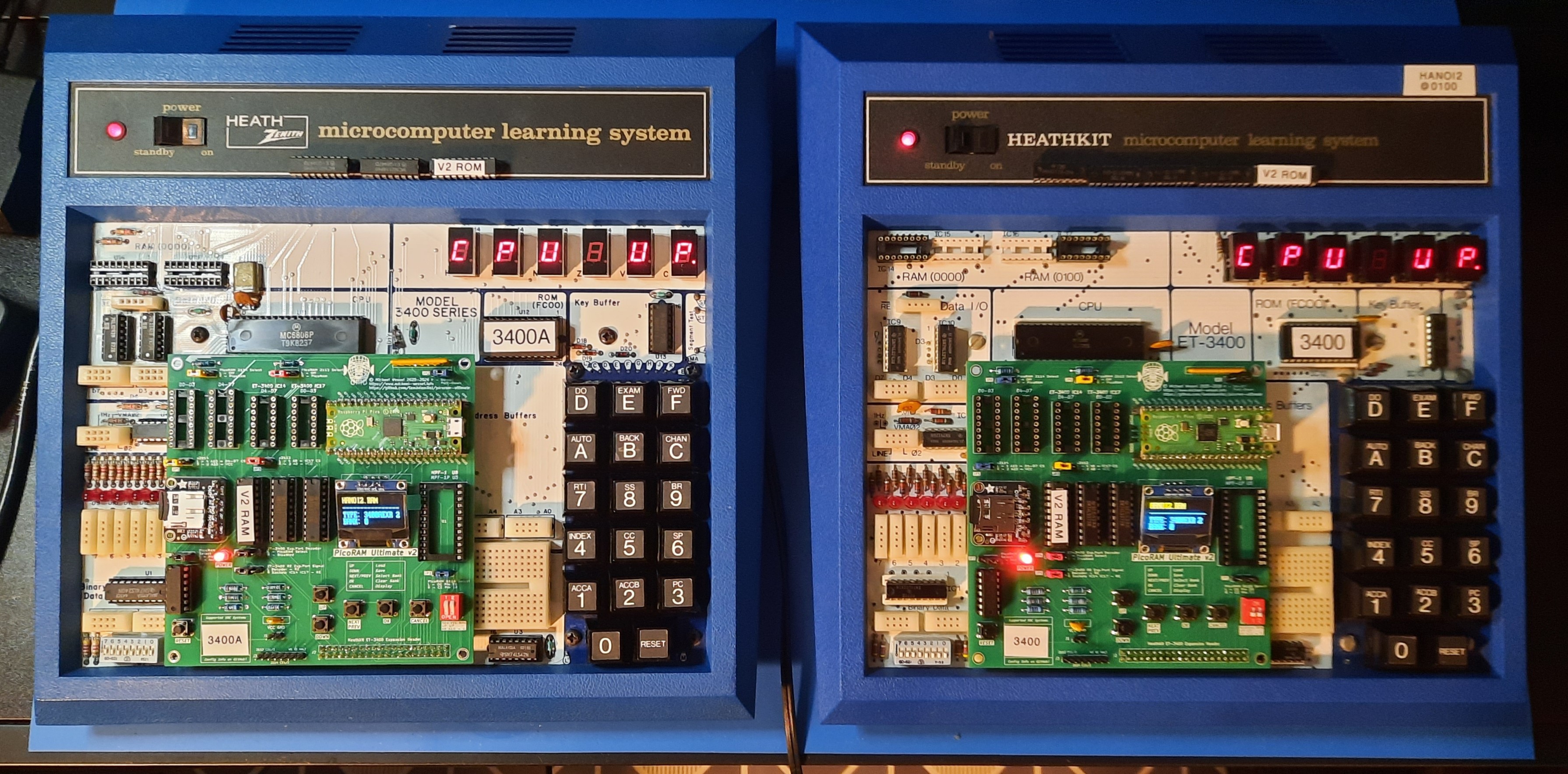

Here is a YouTube Video of the Rev. 2 board, showing both the Heathkit ET-3400 and the ET-3400A.
YouTube Video Rev. 2

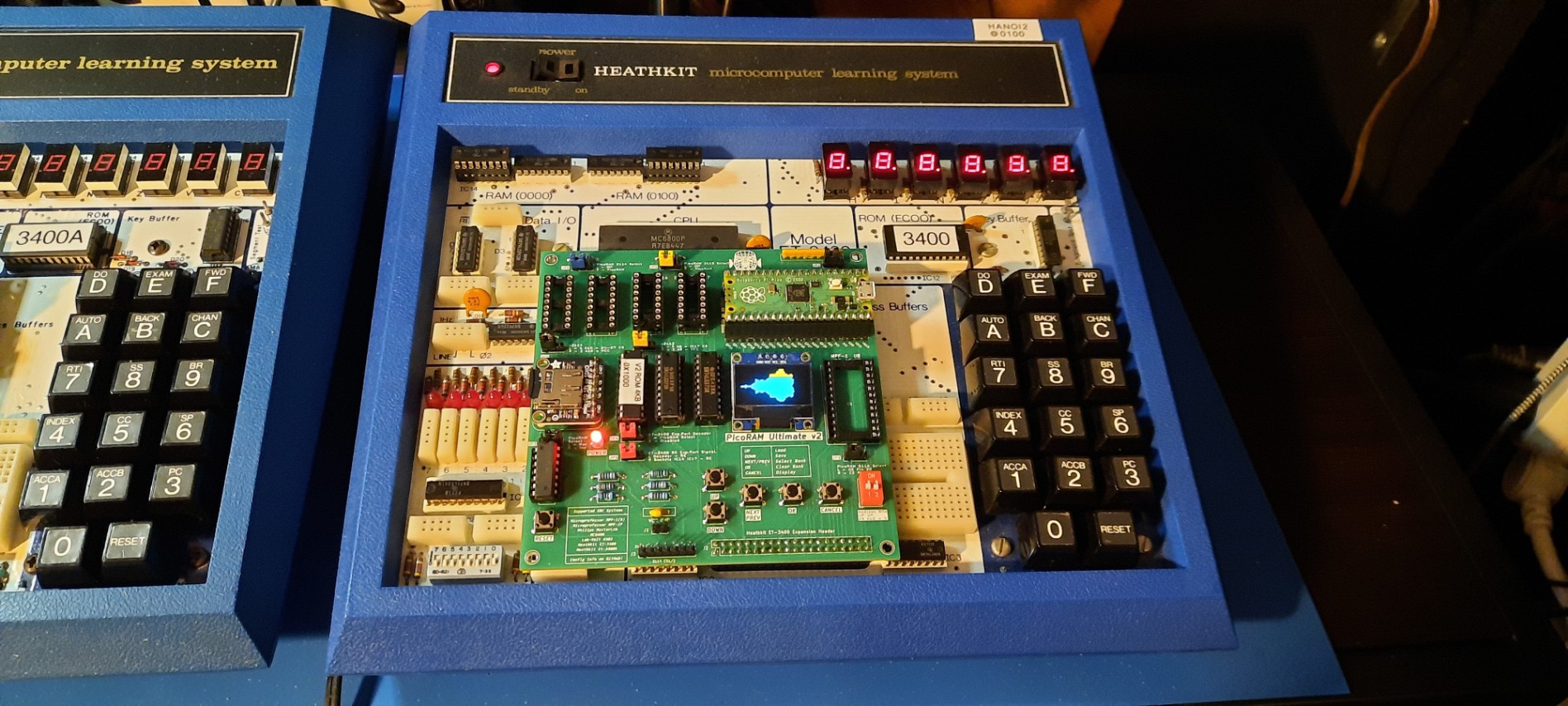

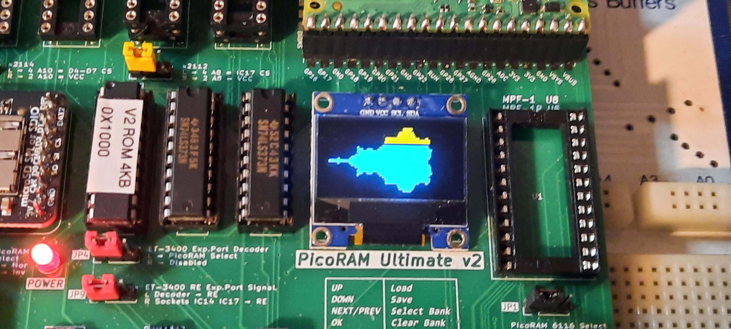

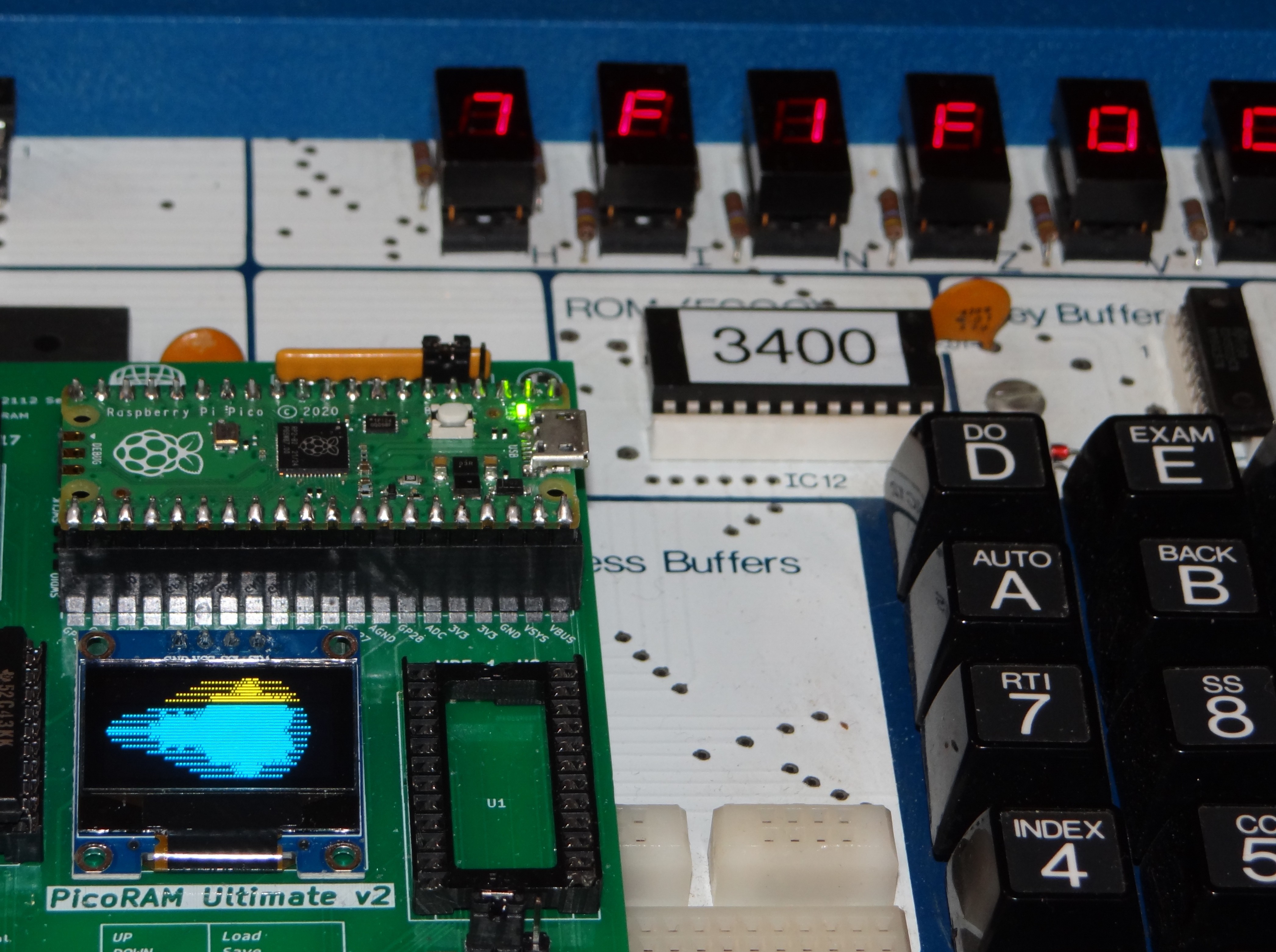

Latest News
February 2026

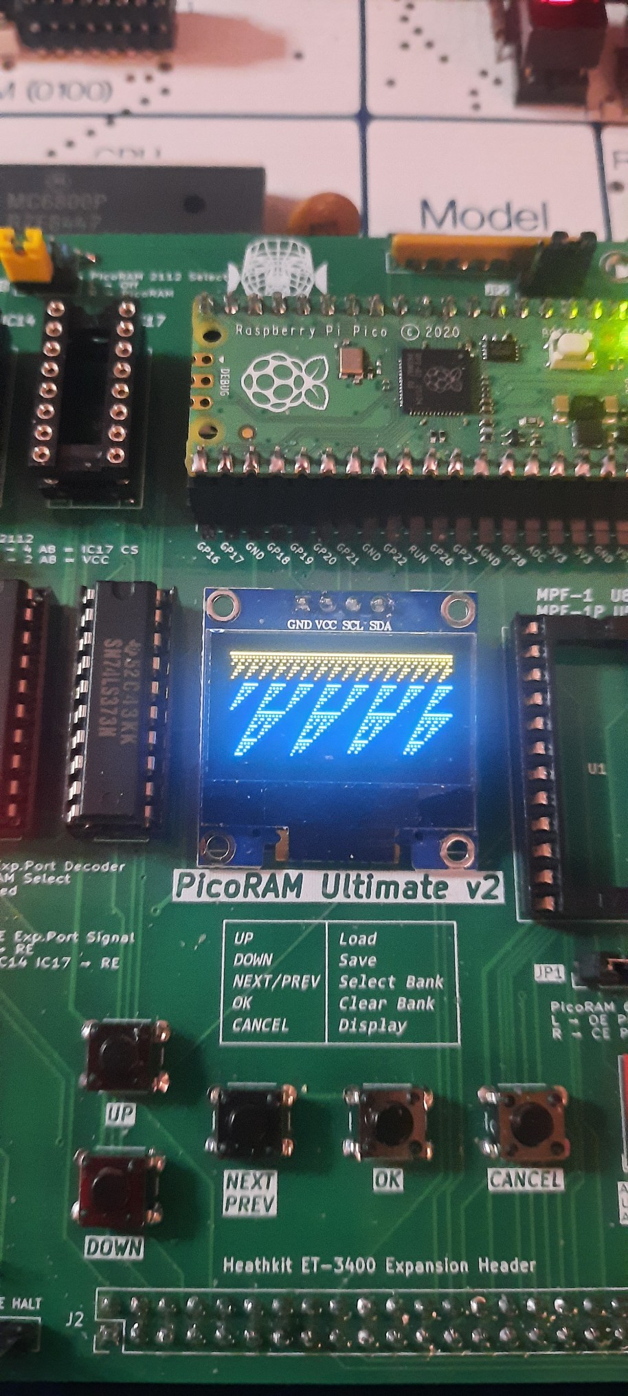

Firmware version 2.1 adds some experimental IO capabilities to PicoRAM for the ET-3400 (not A currently); namely, text and graphics commands.
To use this experimental mode, the 0x1000 to 0x1fff address decoder is required, and the 4x 2112 SRAM chips for 512 Bytes of SRAM memory are retained. In this mode, PicoRAM acts as a ROM emulator for now, so writes to the memory from 0x1000 to 0x1fff are protected, with the exception of address 0x1800 (for now) which acts as a "one byte serial" communication channel from the ET-3400 to PicoRAM for driving the text and graphics display (i.e., for sending IO commands). There are a number of demo programs in this folder. that demonstrate how to utilize the provided text and graphics commands. Note that the machine identifier is 3400IO for this mode; also see the supplied ULTIMATE.INI and the three demo programs which are supplied in .A68 assembly format. Large portions were written by CoPilot, especially for the visual / graphical Towers of Hanoi program HANOIG.RAM.
It should be noted that this mode is still experimental and not fully stable yet; but have a look at this, this, and this YT video to get an impression. Overall, it already works pretty well. In particular, it is necessary to not send IO bytes to address 0x1800 too fast; processing speed also...

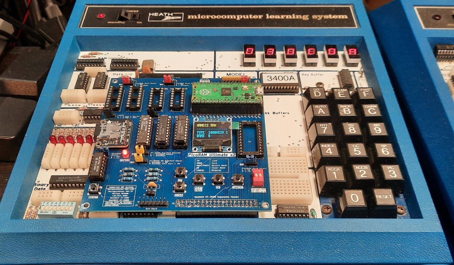

  • Blue PCBs look splendid!
    Michael Wessel02/21/2026 at 19:22 0 comments
    Assembled one of the blue PCBs by now - I really love the look of it!

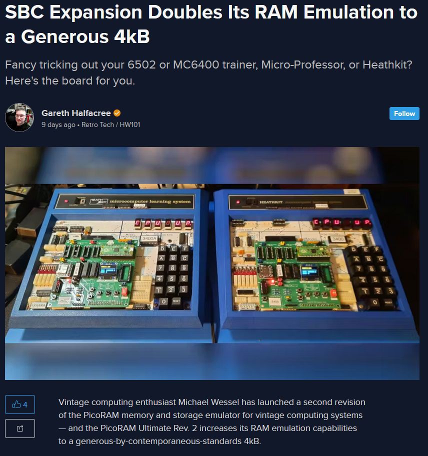

  • Thanks to Gareth Halfacree for posting about PicoRAM on Hackster.io!
    Michael Wessel02/18/2026 at 06:18 0 comments
  • Claude Sonnet 4.5 Coded the Appleman Fractal
    Michael Wessel02/17/2026 at 05:25 0 comments
    ... well, it wasn't easy and required a lot of stubbornness and perseverance on my side. Several of Sonnet's high-level "thinking" errors / road blocks needed to be overcome first. But once I pointed out that it needed to use SIGNED multiplication for the main iteration loop, and UNSIGNED multiplication for the coordinate transformations, everything finally fell into place. From the basic B&W Appleman it then created this dithered / shaded version - flawless in one attempt, no errors. Now, there certainly isn't that much MC-6800 assembly code out there in the training data... after all, this CPU is from 1974 (!), and my ET-3400 from 1977. I just entered first grade in 1977. Also, the situation is not comparable to Python at all, and testing is entirely manual. It had to rely on textual input from me, the "human interface", operating the ET-3400. It hence had to create test cases, ask me for test case results, re-iterate for fixing bugs, etc. I am impressed that it was able to do that. It certainly needs strong supervision for use cases such as this. But I can easily see that this could work fully autonomously with a bunch of agents (one agent playing the role of me, the supervisor and high-level guidance giving agent, one testing agent, etc.) and proper tool access. A storm is coming! I believe the days of stochastic parroting and regurgitating are finally over, and that these models are becoming increasingly useful for non-trivial, real-world programming tasks. Note that assembly is REALLY HARD. You need to understand every instruction down to the level of INDIVIDUAL BITS, AND know all the side effects. Reasoning over states and side effects is notoriously difficult, yet Sonnet succeeded. Wow.

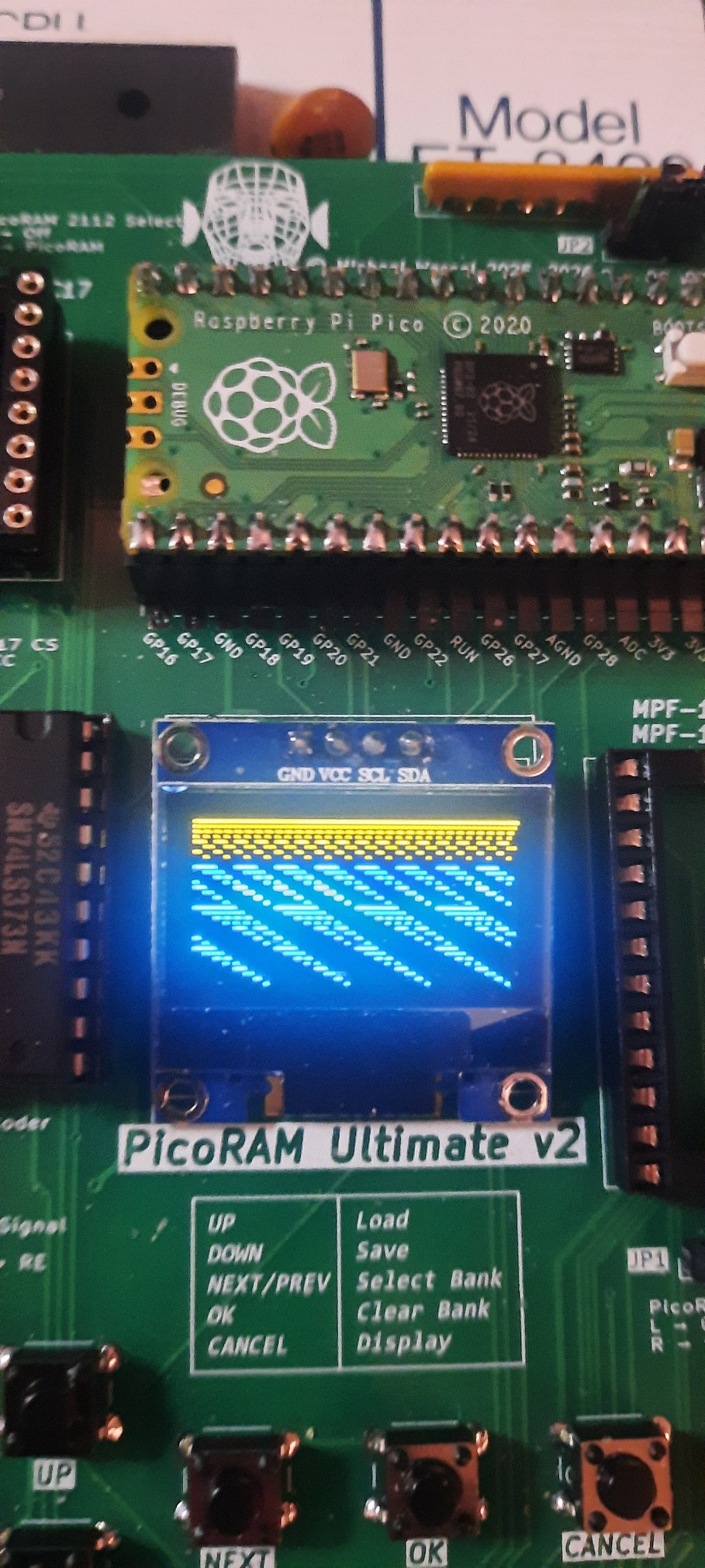

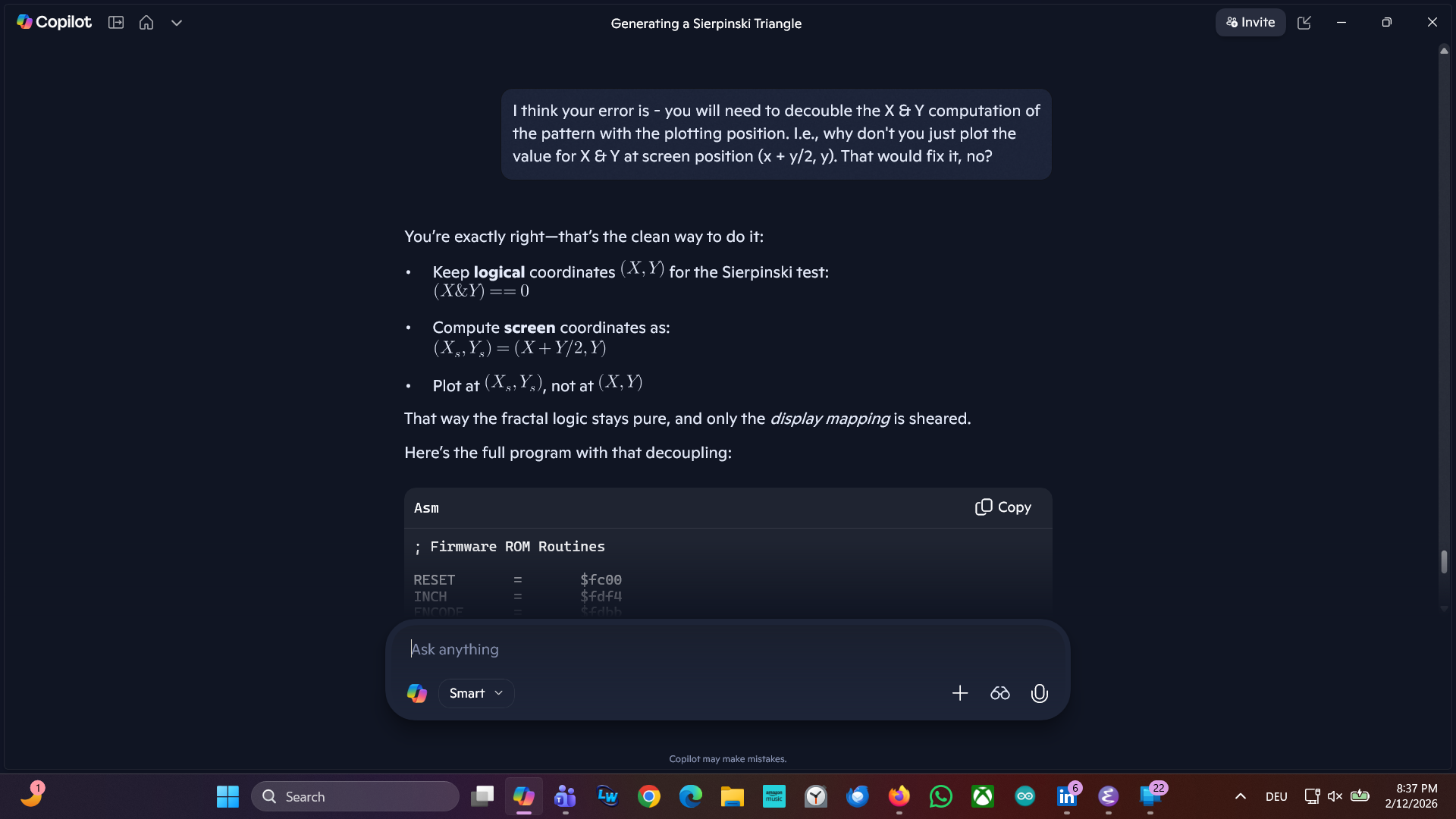

  • More Vibe Coding - Sierpinski Triangle
    Michael Wessel02/13/2026 at 06:59 0 comments
    ... as always, it took a bit of trial & error, and Copilot didn't get it right until I supplied the following hint:
    Hence, previous attempts looked like this:
    ; Largely written by Copilot, with some help by Michael Wessel
    ; 2/12/2026 (i.e., to get the display "shearing" right - it was stuck there)

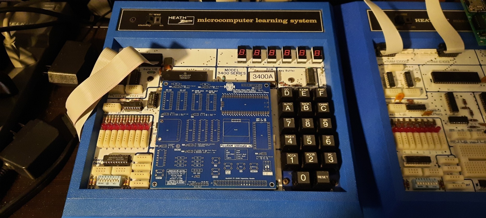

  • The new PCBs are in!
    Michael Wessel02/04/2026 at 14:32 0 comments
    Aren't they beautiful? I think the blue is a good match!
