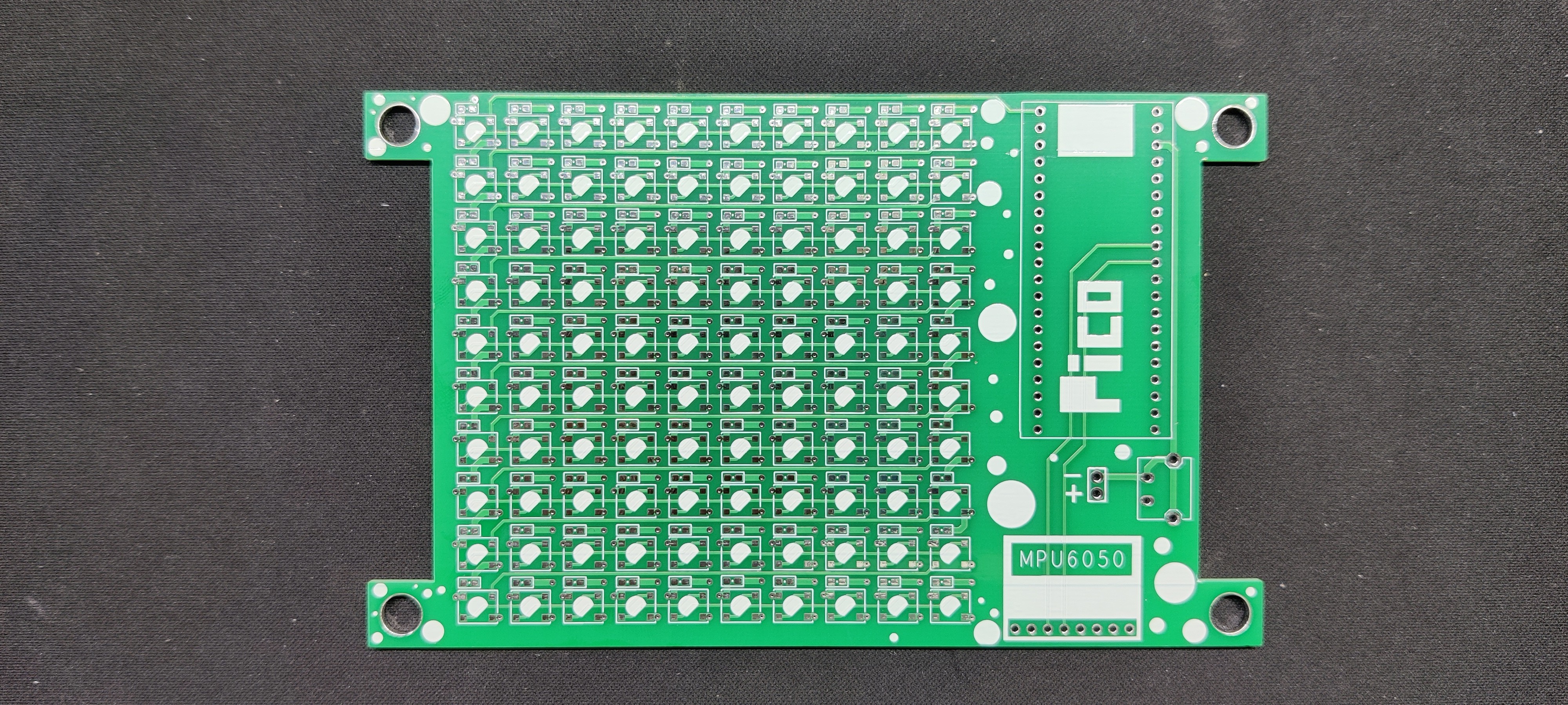

In this project we are utilizing one of our previously built custom RGB matrix boards, which consists of 100 WS2812B LEDs arranged in a 10x10 Matrix, a PICO is also added to the board for controlling the Matrix.
You can check out more about the Matrix Project from the below link to get more detail about its build process and code.
https://www.hackster.io/Arnov_Sharma_makes/raspberry-pi-pico-matrix-project-da5f89
Here, we are using the Matrix coupled with the Raspberry Pi PICO W, which will allow us to connect with the internet in order to get daytime readings.

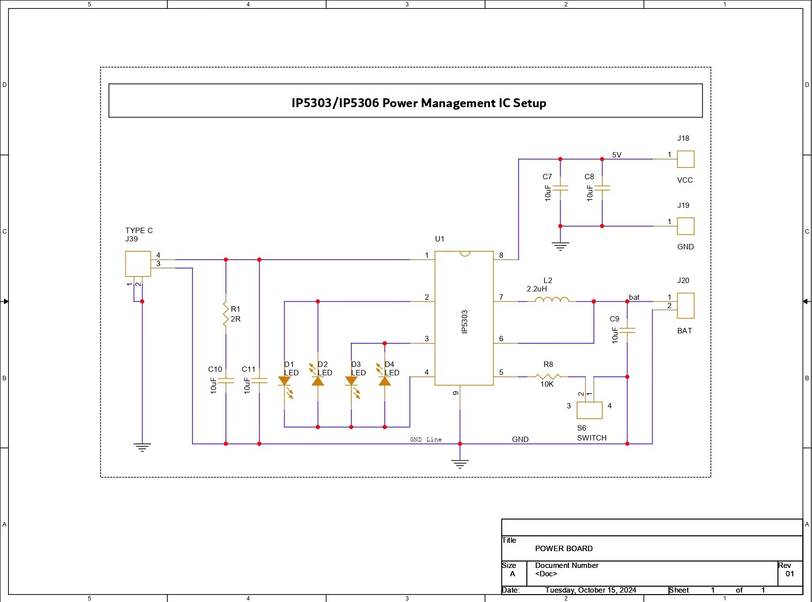

POWER CIRCUIT
For the Power source of this project, we are using a Custom Power Circuit that revolves around the IP5306 Power Management IC, that delivers a consistent 5V/2A of power from a 3.7V LiPo Cell we are using in this project.
After building the basic layout according to the datasheet, we exported the netlist from our PCB CAD software and created a board layout file in which we placed all of the SMD and through-hole components in the correct sequence, connected all of the traces according to the schematic, and finished the board.
After finalizing the Board Layout, we exported the gerber data and shared it with HQ NextPCB for samples.
