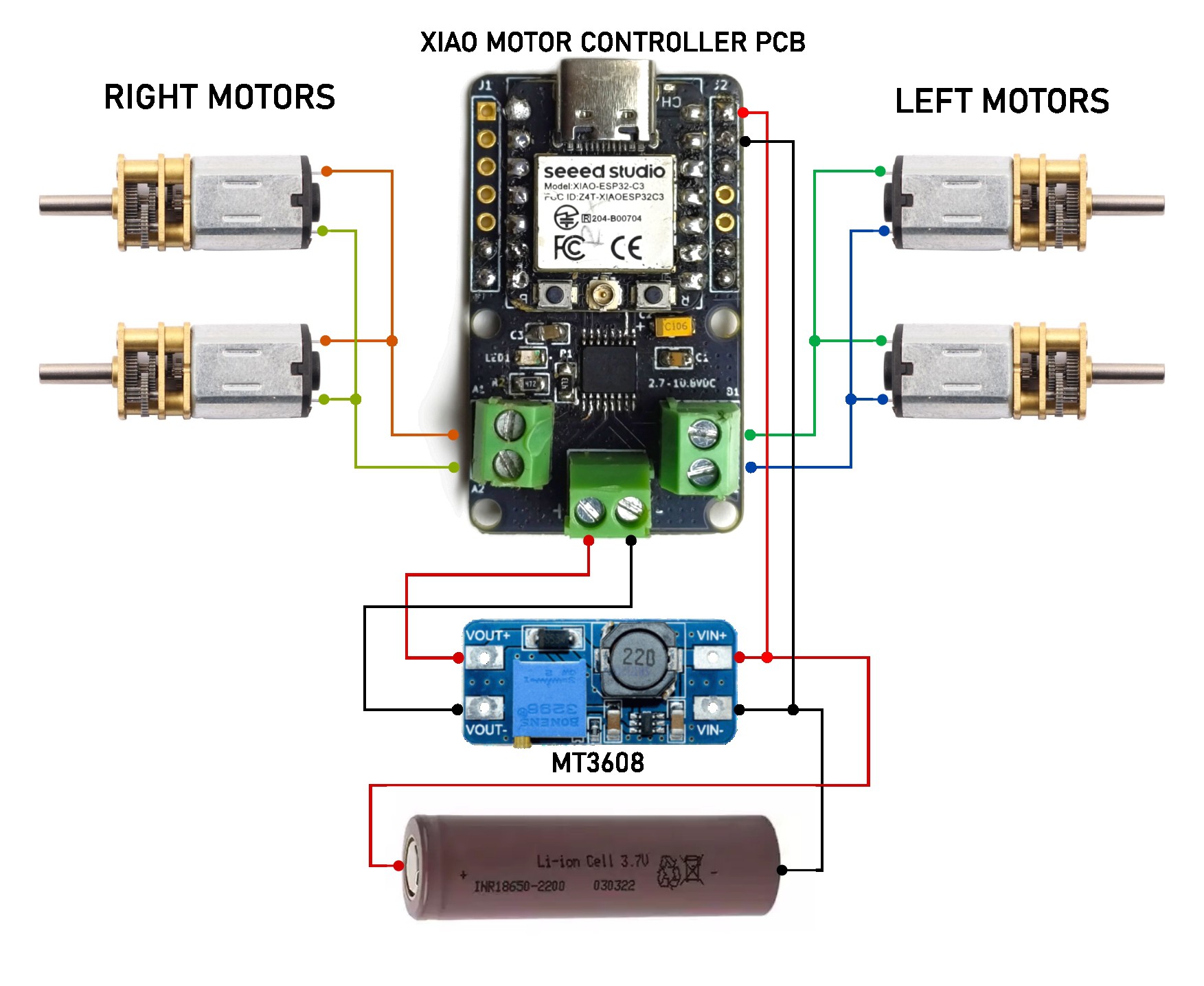

At the build's core is a custom motor driver PCB, specifically designed to control two dual DC motors for true 4x4 drive. Everything is mounted on a fully 3D-printed chassis,

Here I used a Dual H-bridge motor driver for the PCB I designed for Seeedstudio XIAO ESP32C3, it based on the DRV8833 motor driver IC. I also used screw terminals for connecting motor wired and power. You can power the driver between 2.7V to 10.8V, so the higher voltage means more speed. I designed this PCB in Flux. ai and ordered the PCB with

So let's start the assembly with installing the motor, put the all four motor in the 3d printed slot, and secure it with motor holder and screws. Also, don't forget to solder about 8 cm wires to the motor
Connect all 4 motor wires to the motor controller PCB and screw in the PCB using four M2.5 Screws
Solder a 2-pin JST connector and an additional two wires to the input pad of MT3608. Also, solder some wires to the output. The reason I am using MT3608 is that it functions as a voltage booster, allowing us to increase the 3.7V from the battery up to 10.8V for the motor driver. We will be powering the Xiao directly from the battery output. Please make sure not to connect the boosted voltage to the Xiao’s power input, as this could damage it.
Now, put the MT3608 into the 3D printed slot. Use glue if you need
Connect the motor power and Xiao power from the MT3608 input and output pads
Install the antenna port to the side of the wall and connect the other end to the antenna port of the XIAO
Install all 2 of the M4 thread inserts onto the 3d print using a soldering iron
Solder the JST connector to the battery and place it in the 3d printed slot
Put cap and close it of with 2 M4 screw
