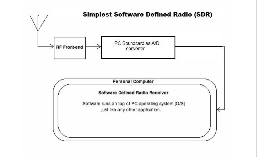

A vacuum tube radio, also known as a valve radio, is an early type of radio receiver that uses vacuum tubes to amplify and detect radio signals. These radios were widely used from the early 20th century until the 1960s. Nowadays with just one Vacuum Tube and Signal Generator you can make a super simple, yet sensitive and selective Shortwave/SSB Radio Receiver, thanks to the use of PC and SDR processing software. In fact, this project represents a kind of Software-Defined Radio where components that have been traditionally implemented in hardware (e.g., mixers, filters, amplifiers, modulators/demodulators, detectors, etc.) are instead implemented by means of software on a personal computer or embedded system.
 This allows for more flexibility and the ability to handle a wide range of frequencies and protocols simply by updating the software. Another advantage is that the radio uses a cheap 6J1 tube which is capable of operating at an extremely low voltage of 6.3V which we also use for heating. This Radio is actually a modification of the DRM Direct Mixer project published by Burkhard Kainka, but now  using a VFO instead of a constant frequency crystal oscillator and also adding an antenna matching circuit to the input oscillator.

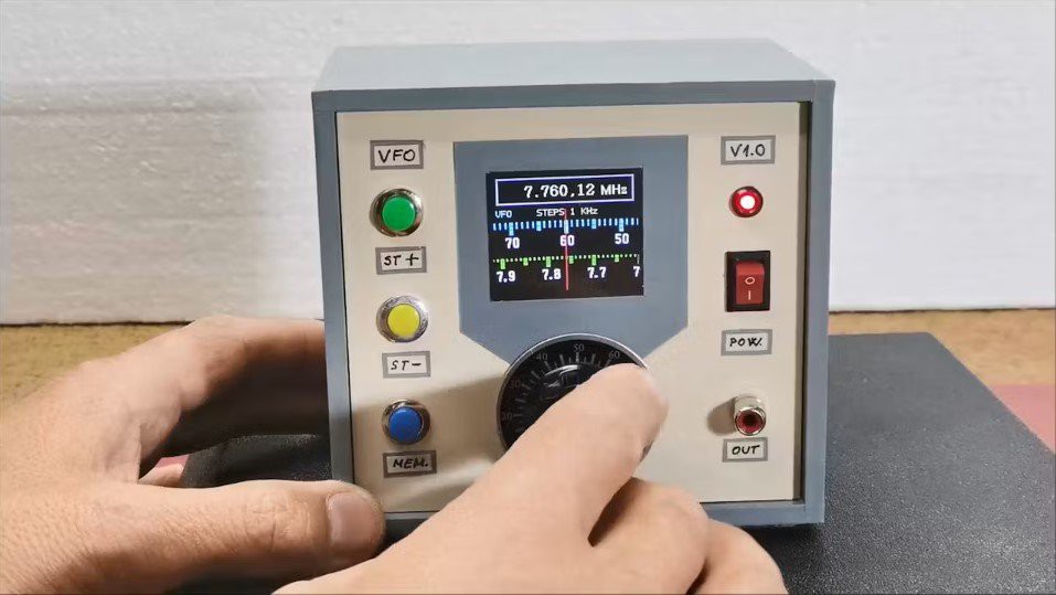

The 6J1 tube acts as a mixer with the oscillator signal been injected via the screen greed. In the project I use the frequency oscillator whose construction is described in one of my previous videos, but you can use any other frequency oscillator. .

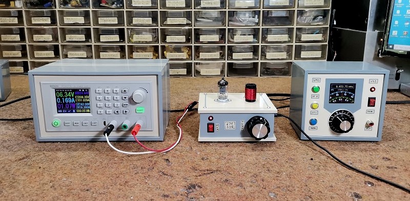

Now let's look at the way of making it and the components of which it is composed. The receiver is made in a simple way by directly soldering the components to the tube base, a technique that was also used on commercial radios until the middle of the last century.
  The device consists of a cheap 6J1 tube, several capacitors and resistors and an input part consisting of a coil with 25 turns on a body with a diameter of 2cm, and a variable capacitor with a value of 400pF. The frequency range of reception depends on the value of the last two components and for the given data it is from approximately 5 MHz to 15 MHz.

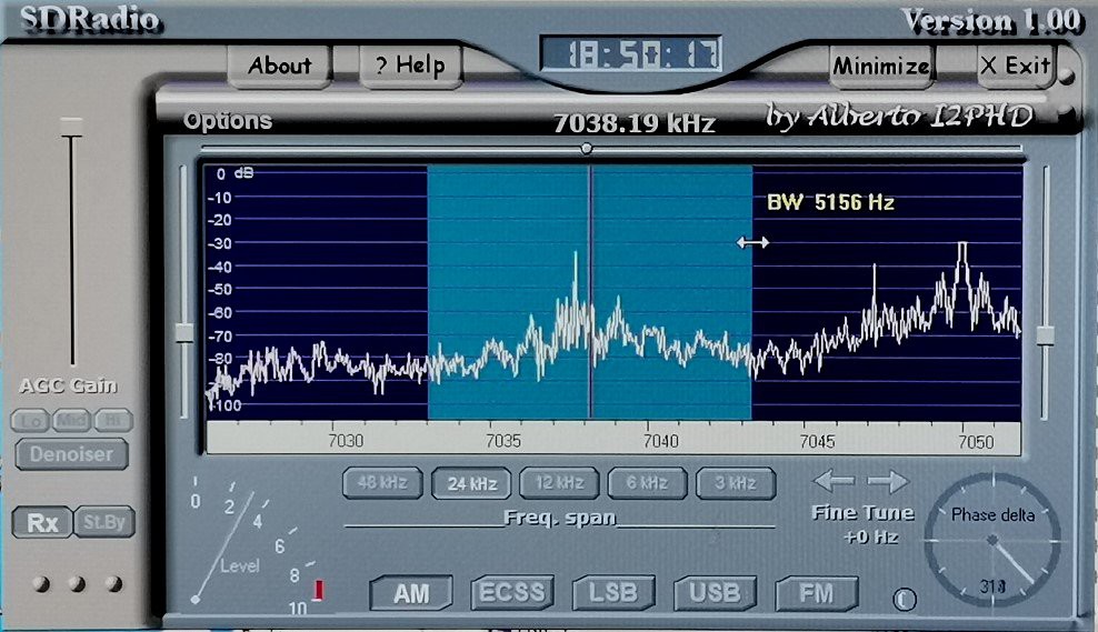

   The SDR software I use is "SDRadio" by Alberto I2PHD, it is free and you can download it at the given address.  It is very simple, does not require powerful hardware and contains only the basic settings and functions needed for such a simple device.
On the software we can monitor the reception signal very clearly and precisely, and we can also set the type of demodulation, namely AM, LSB or USB, as well as the bandwidth of the received signal. The stability of the frequency of the received signal mostly depends on the VFO generator, which in this case is very stable and precise.  That's why we can perform demodulation of several digital radio signals with different software.
  And now let's see how the device works in real conditions. The receiver should first be tuned to have the best reception around the desired frequency. For this purpose, we adjust approximately the frequency on the VFO, and without the antenna connected, we turn the variable capacitor until we get the strongest reception, that is, noise. Now we connect the antenna and start searching for stations. When we encounter a station, we again move the capacitor to the best reception. On the video I demonstrate reception at different frequencies, bearing in mind that reception varies greatly with the propagation conditions of the SW band.
