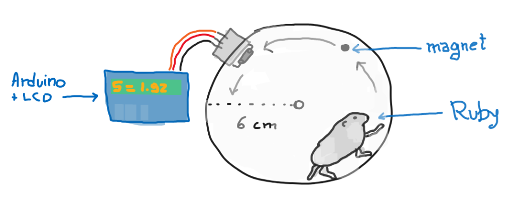

The first prototype was made with an Arduino UNO:
We measure speed using the basic formula:
Speed = Distance / Time
We know the wheel's radius (6 cm), so we can compute its circumference using:
C = 2 * π * r
Each time the magnet passes the reed sensor, we count a full rotation. By measuring how many rotations happen every 2 seconds, we can estimate Ruby’s speed.
To count the wheel’s rotations, we use a reed switch sensor, which detects magnetic fields. By carefully placing the sensor and attaching a small magnet to the wheel, we can count each time the magnet passes in front of the sensor.
The magnet’s position must be chosen so that it passes close to the sensor once per full rotation.
Pay some attention because the magnet can pass near the sensor slowly, which may result in multiple readings. To avoid this, we used a comparison with the previous value in the code to detect only the falling edge of the magnet's passage.

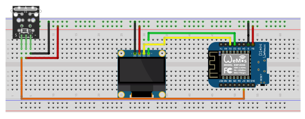

After the first prototype with Arduino I've created a version for Wemos microcontroller with a small SSD1306 display (128x64 pixel).
The simplified sketch (available in the file section and also in my repository on Github) handles all core functions of the smart hamster wheel: reading the sensor, calculating speed and distance, tracking activity time, and displaying the data on an OLED screen.
This is the final configuration schema:
Display and Sensor Initialization
  • The SSD1306 OLED display is connected via I2C on pins D2 and D1.
  • The reed switch sensor is connected to pin D7 to detect each full wheel rotation.
  • Wheel radius is set to 6 cm, and the circumference is computed in meters.

3. Reed Sensor Debounce
Detects transitions from HIGH to LOW on the sensor.
Ignores noise or repeated triggers if less than 200ms have passed since the last trigger.
Increments two counters:
  • c: total number of wheel spins (for distance)
  • q: spins in current 2-second window (for speed)
