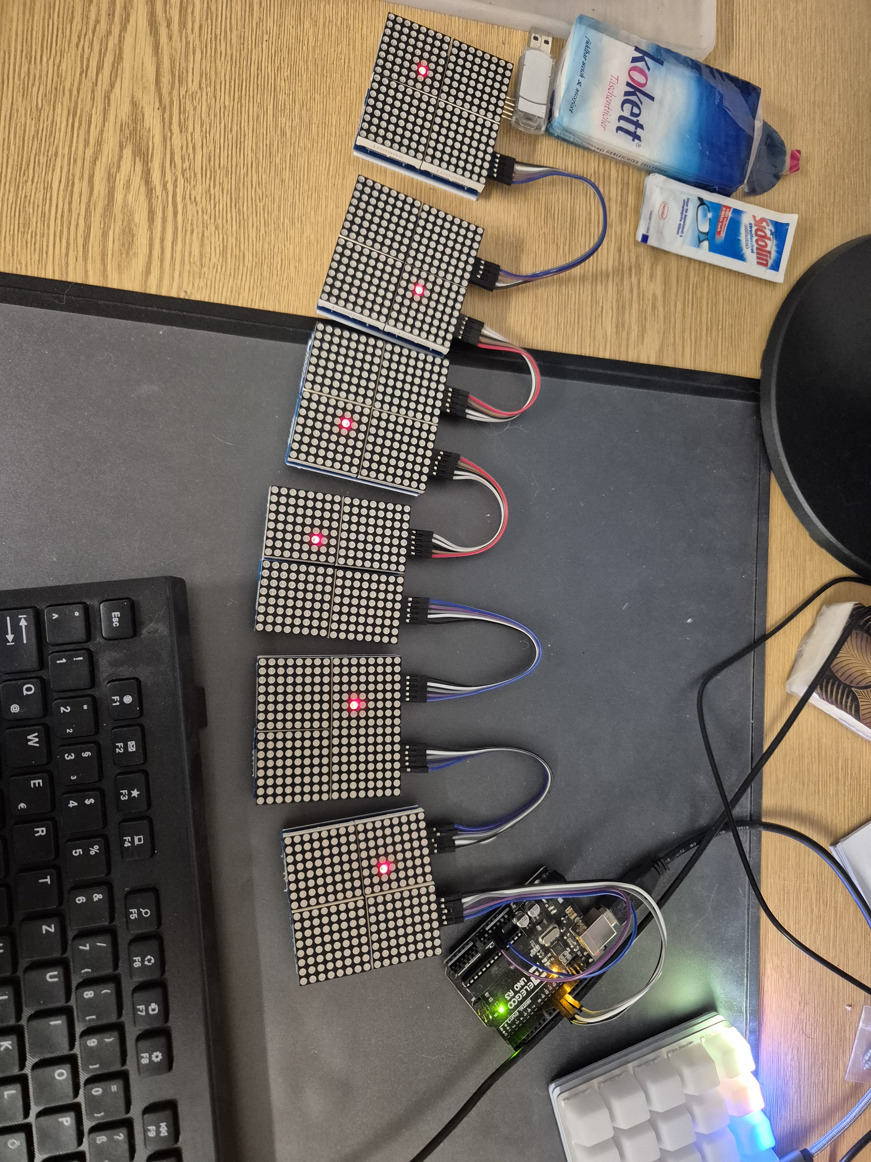

To see, if my idea work in principle, I build it all using MAX7219 modules from AZ delivery.
Here a picture of the final test setup:
The test showed:
- My Idea in general is working :-D
- The library that i found available on github was not sufficient.
- It used bitbanging for the communication
- It was only able to handle up to 8 MAX721
