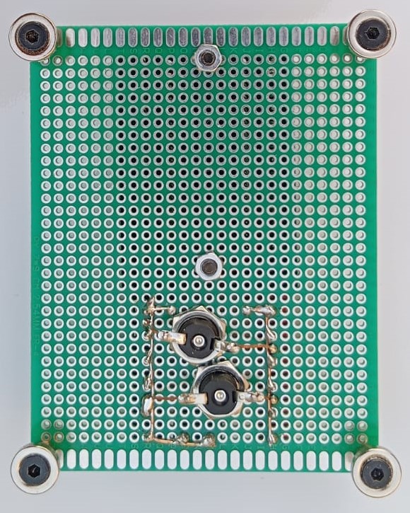

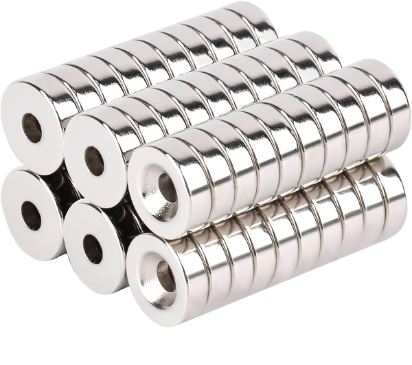

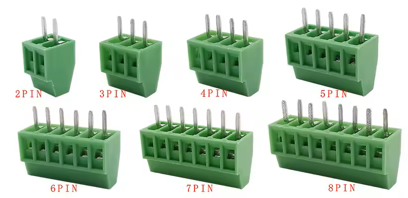

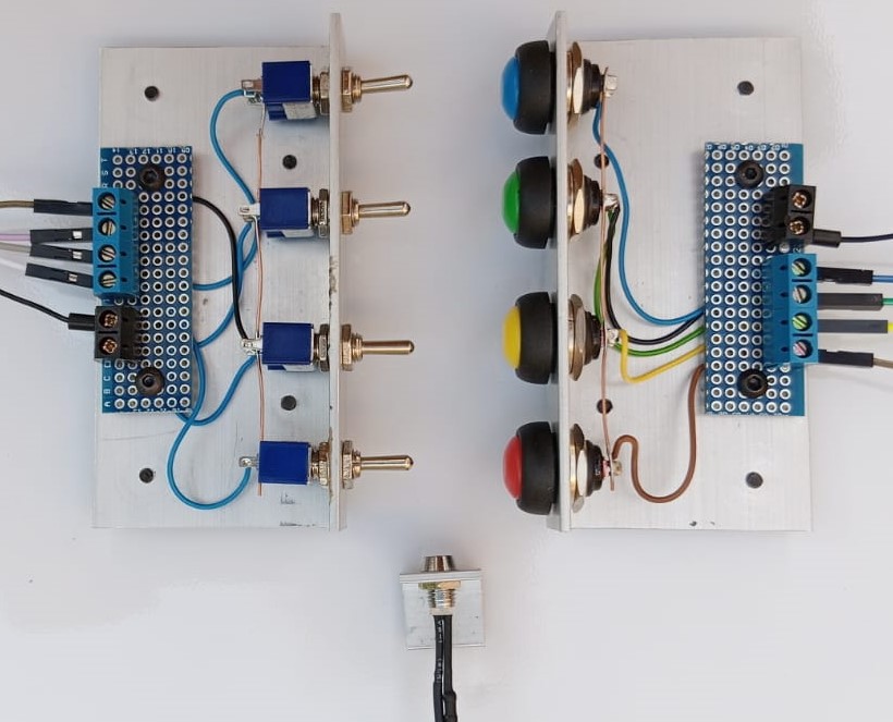

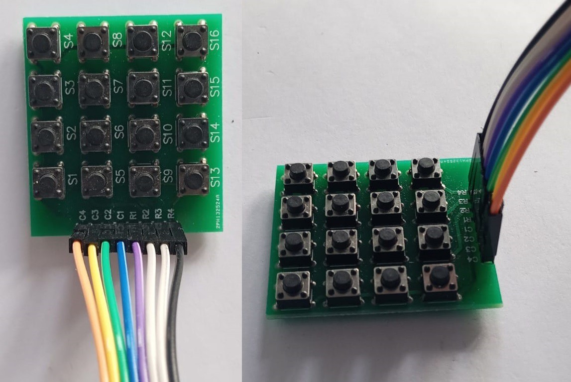

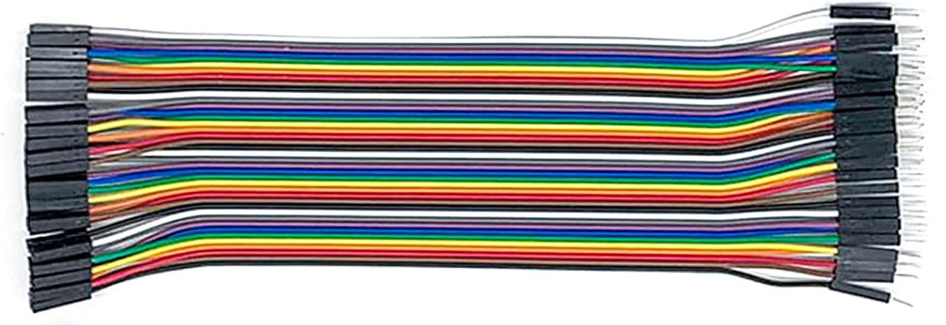

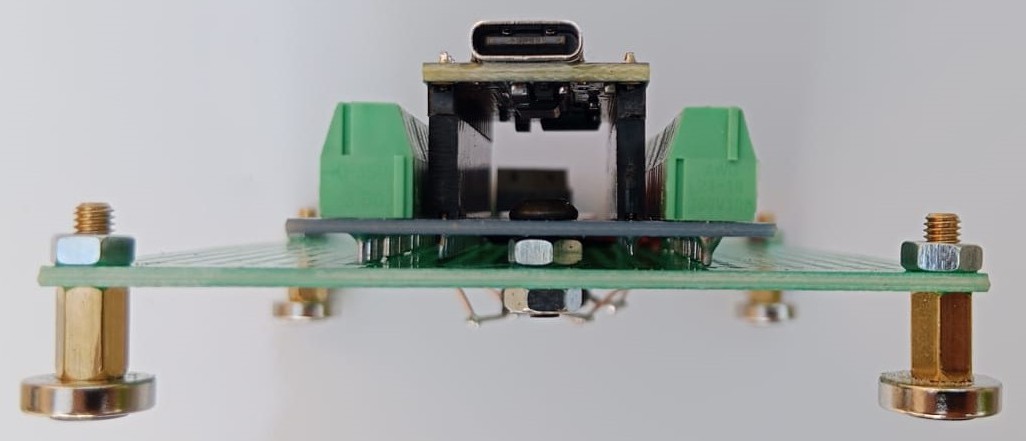

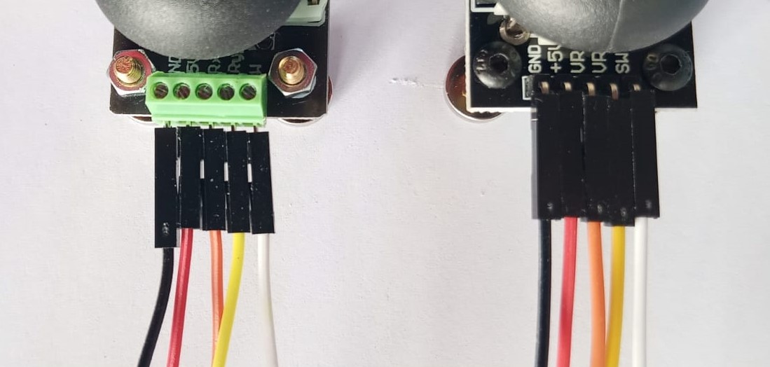

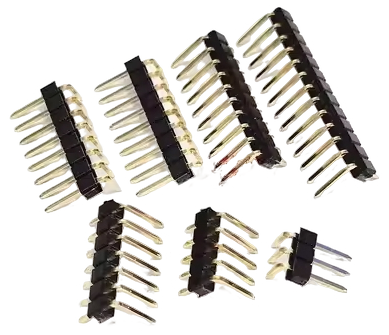

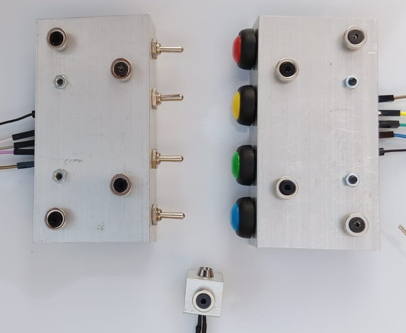

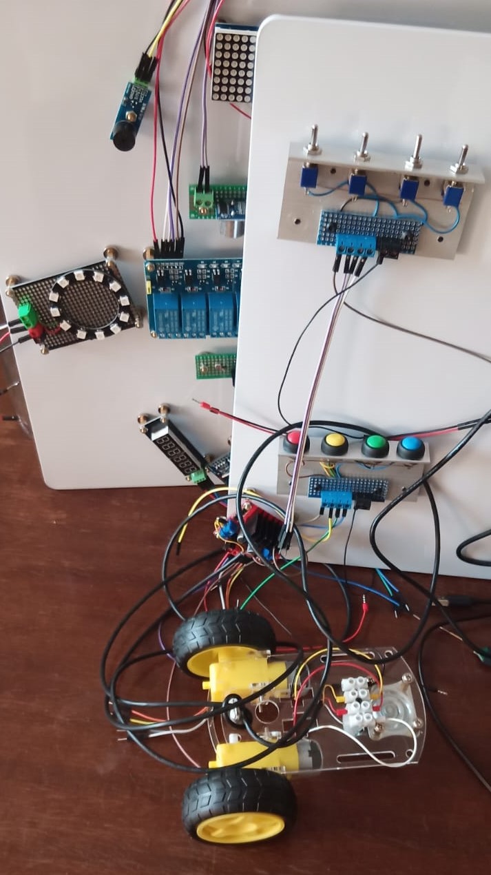

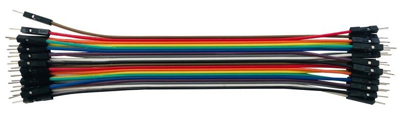

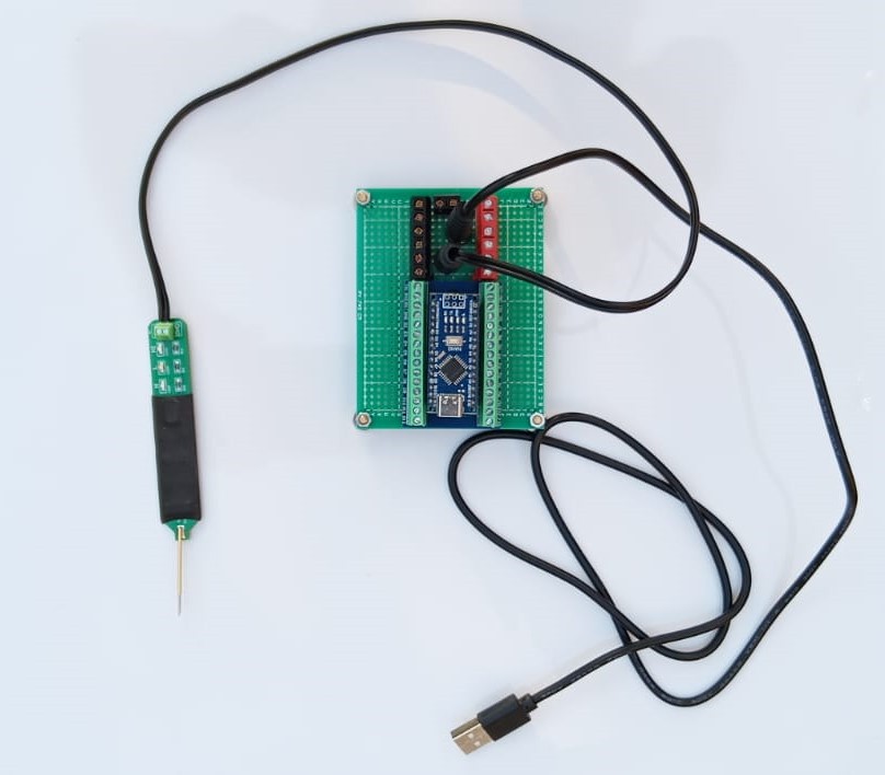

MagnaMods
Magnetic Modules: the screw terminal based, magnetic mounted experiment kit. Made from affordable and broadly available parts.
Public Chat
324 views
0 followers
Breadboards can have some serious disadvantages: • Loose or intermittent connections can occur, especially after repeated insertions. • Contact resistance is relatively high and can vary. • The circuit wiring is not trivial; making errors is easy. • Most breadboards can only handle a few hundred milliamps per rail. • Components can pop out easily if the board is moved. • Loose DuPont cables can be put back in the wrong place. • Hard to scale up complex circuits; things get messy and error-prone. • Troubleshooting large breadboard circuits can be frustrating. MagnaMods intends to solve these issues: • Wires are permanently attached to the modules, red and black only used for power. • Quick setup connect the wires to the Arduino. • Magnets on a whiteboard keep the modules in place. • The whitebord enables drawing schematics, before connecting. • Crew terminals make connections sturdy.
I don’t like breadboards, for those who didn’t notice. So I developed an alternative.
Most of my projects are Arduino based. The reason for this is that there is a wide variety of modules available that can be effortlessly connected to an Arduino. This suddenly makes it very easy to design and build your own electronics. However, this electronics still needs to be tested.
Magnetic mounts
Almost all electronic modules have M3 mounting holes. That makes it very easy to screw magnets under these modules and place them on a whiteboard. Having a whiteboard means that you can draw the required connections first, before connecting them. Having magnets, will fix the modules, so that they will stay in place. You can even use the whiteboard to store alle the modules and put it away vertically.
Connection method 1
Screw terminals are a great way to connect modules. The pin connectors are removerd and replaced by standard 2.54mm pitch screw terminals. Standard male-to-male DuPont cables can be used to connect two screw terminals. A red cable is always +5 volt and a black cable the ground; this color coding avoids mistakes. The cables can be left attached to the modules, this store them and reduces setup time.
Connection method 2 (alternative)
Instead of screw teminals, 90° Pin headers in combination with emale-Male DuPont cables can be used.
Probably cheaper, but the cables can be easily pulled out. Both methods are shown below.
What not to use
Two things must be avoided. Using modules with no mounting holes, because no magnets can be used. A second thing is that straight pin connectors must not be used. They will guide the wires straight up in the air; but the Arduino is certainly not there.
Storage
Since all modules are magnetic, vertical storage is no problem. Because whiteboards are used, the scematic can be drawn (and checked!) prior to connecting the modules. This is a big advantage!
Modules with small holes
Some modules have M2 holes instead of M3 holes. Mounting the magnets on modules with M2 holes, can be solved in a simple way. M2 Male-Female standoffs are mounted on the module. Than M3 Female-Female 10mm standoffs are used to mount the magnets. When the M3 standoffs are drilled  5mm deep with a 3.2mm drill, the M2 standoffs can be pressfitted. Locktite can be used when necessary. This is shown in the picture below.
Arduino Nano module
Making the Nano module is very straight forward.The pictures speak for them selves. Power for the red and black power terminals is taken from the underside of the Nano terminal board. Two wires are used to feed the terminals. The colors Black and Red are reserved for the Ground and +5V power and not used for anything else. In all other cases red is replaced with brown.
The Nano module with the power cable and logic probe.
The side view of the Nano module
Bottom view of the Nano module
Switch Modules
Modules with switches are hardly for sale and those that are for sale are of poor quality. This makes it necessary to assemble these modules from separate components. The base is formed by an L-profile of 50*20mm. Holes are drilled in this profile for the switches, the mounting of the print and the magnetic feet. The crew terminals are then connected to the switches, as shown on the pictures. The LED module is made in a similar way.
Top view of the switch and LED modules.
Bottom view of the modules
Finally
All materials are standard materials, no custom stuff is used. Hand tools are sufficient to make and assemble. The system can easily be extended; adding new modules can be done without any problems.
I am using this system for use in a makerspace for children. So pinout pictures for all modules are made available and I also added some custom modules for the use of switches and LED’s. Arduino Nano’s are used, and they are punt on a perfboard so that power terminals and plugs can be easily added.
And there you...
Software.zip
Handy software routines
x-zip-compressed - 5.84 kB - 06/12/2025 at 18:48
Download
Modules_MagnaMods.pdf
Extensive Pinouts for the modules, with the used Libraries.
Adobe Portable Document Format - 2.06 MB - 06/12/2025 at 18:47
Preview
Materials_MagnaMods.pdf
Used materials for the MagnaMods.
Adobe Portable Document Format - 771.00 kB - 06/12/2025 at 18:46
Preview
Module_Template.docx
MS Word template for making new pinouts
document - 102.43 kB - 06/06/2025 at 09:11
Download
Pinout_Template.pptx
Powerpoint template for making new pinout drawings of modules.
presentation - 54.48 kB - 06/06/2025 at 09:10
Download
View all 6 instructions
