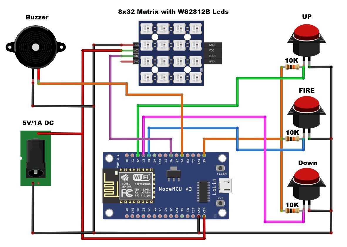

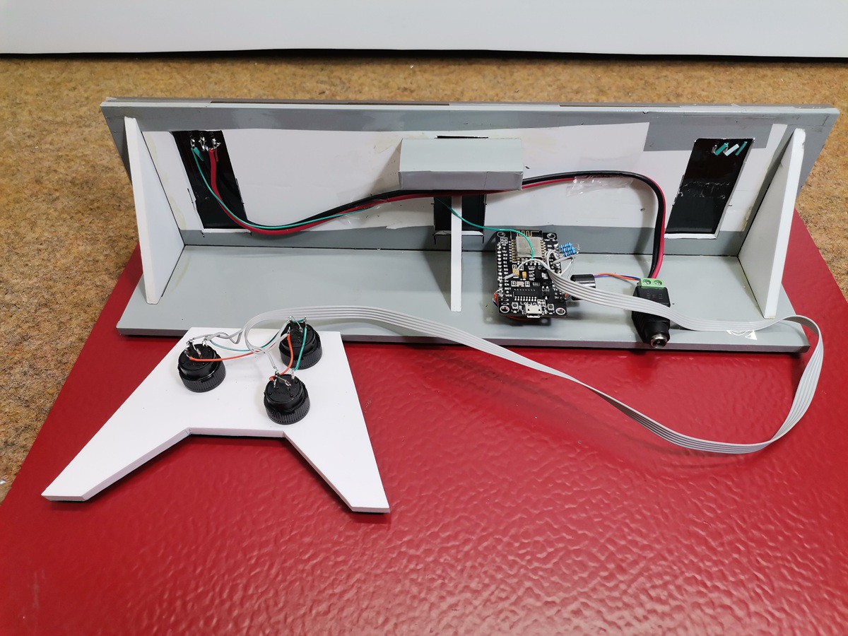

The game is extremely simple to make and consists of only a few components:
- ESP8266 microcontroller board
- 8x32 Led Matrix with WS2812B leds
- 3 Buttons
- and Buzzer
   I simplified the device's construction as much as possible, the matrix was first glued to the substrate, and then I placed frosted glass in front of it for a better visual effect with some light diffusion. Then I made a simple two-dimensional joystick that contains three colorful buttons with built-in LEDs, but standard buttons can also be used.

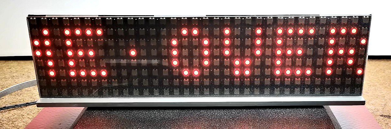

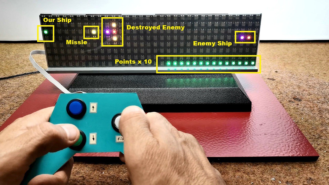

   First, let me explain how the game works. When you turn on the display, a scrolling text appears with the content "Press Fire to Start".
Now if we press the FIRE button, by generating characteristic sound the game starts.

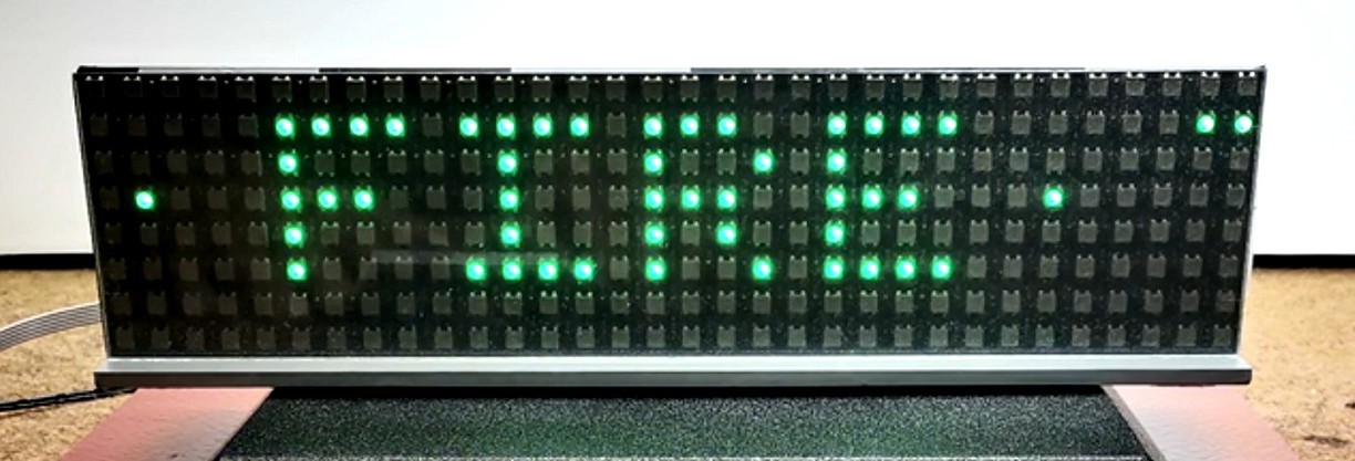

 Our weapon is located on the left side of the display and is green. With each press of the up or down buttons, the weapon moves one space. On the other side, on the far right, enemy ships marked in red appear randomly, with a magenta missile on their tip. If we destroy the enemy, the missile remains until the end and we must avoid it so that it does not destroy us.
At the bottom right of the display, as many green dots appear as we have destroyed enemy ships. If an enemy ship hits our weapon, the game ends and the Game Over message appears on the display with appropriate sounds.

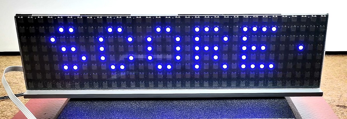

If we press the Fire button, a Score appears where for each destroyed enemy ship we get 10 points. By pressing the Fire button again, we return to the beginning and pressing the Fire button again starts a new game.

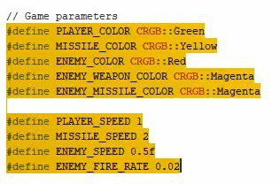

   As for the code, it should be noted that it is not as simple as I initially imagined, but it is highly customizable and at the beginning of the code we can change many parameters, of which the most important for the gameplay are: PLAYER_SPEED, MISSILE_SPEED, ENEMY_SPEED and ENEMY_FIRE_RATE. Regarding the installation of the code, I used Arduino IDE v 1.8.16, and ESP8266 Core v 3.1.2.
