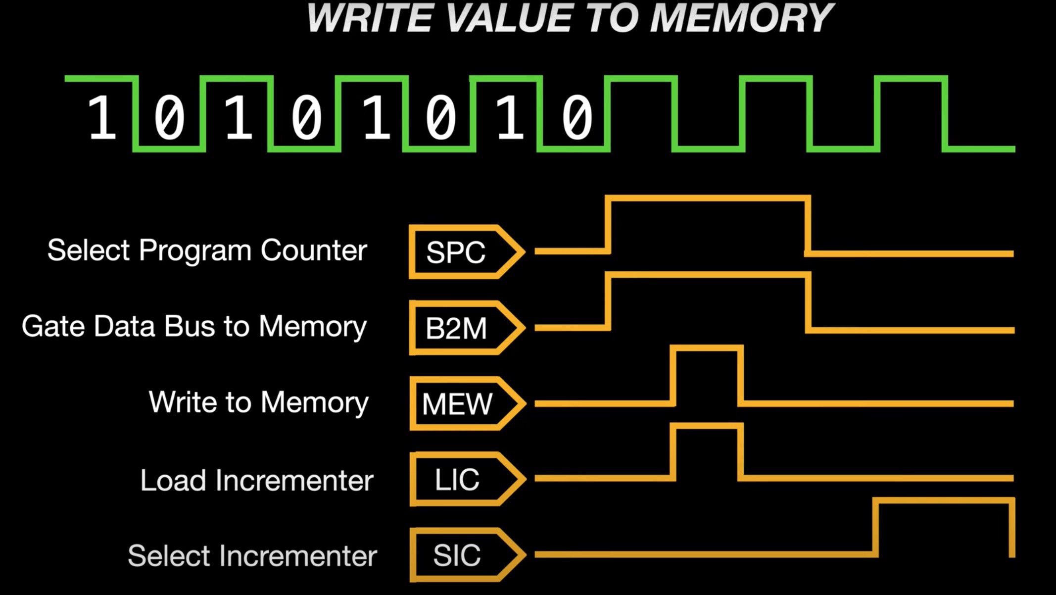

This final part was supposed to be a cake walk, since I just needed to add some sequencer steps to create the "load memory" and "advance the program counter" signals. What do they say about "Best laid plans"? Yeah, well - the board was looking like a hot mess.

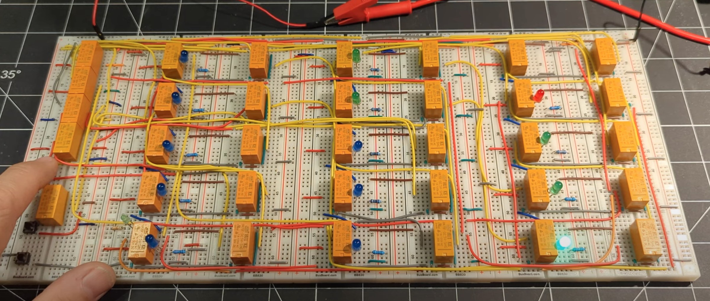

So, a makeover was in order. I channeled my inner Ben Eater (who makes this look easy), put someTangerine Dream on the old turn table,  and got into the zone. The results speak for themselves (imo)...
So now that all of the sequencer steps are there, the next part was to create those interesting pulses that are needed to direct the relay computer control lines to do the stuff they need to do, like hold open the "Select Program Counter" while we "Load the Incrementer". And like on the Relay Computer's Sequencer Card build, we can use diodes to shape these signals.
And once those pulses were created, I combined everything into one big breadboard, and dubbed it "The Monolith".

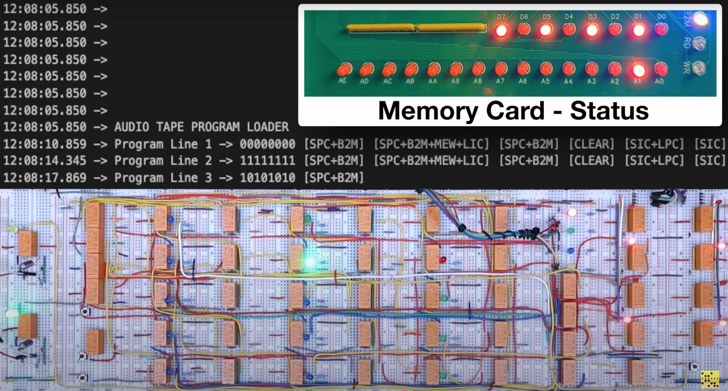

Above we can see testing in progress, and can compare the value output from the Arduino testing (10101010) with what is actually appearing on the memory card in the relay computer. The memory address is also showing as "2" which is correct since this is the 3rd position in memory.

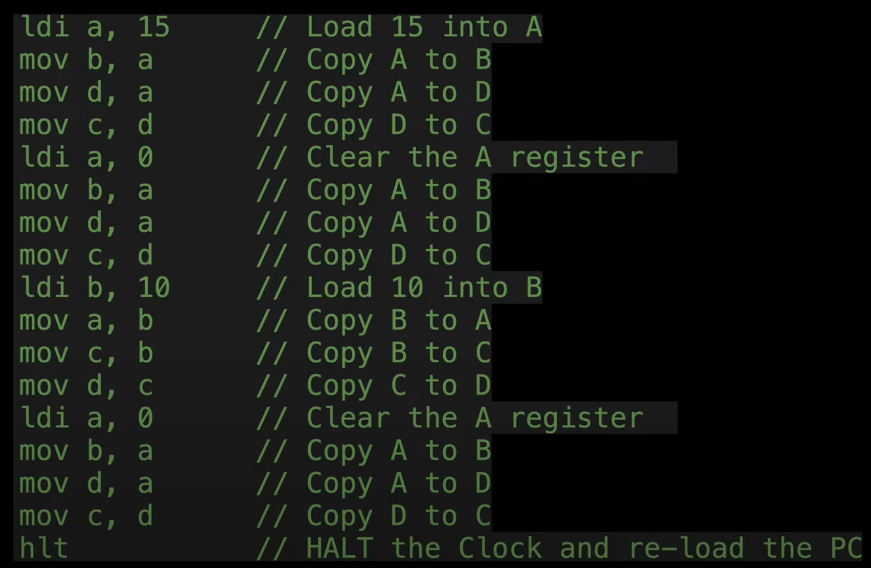

I only have 8 card slots in my backplanes, and I could add more, but I've realized that I need to create a new backplane so no sense in wasting edge card connectors. So I restricted the testing to something that could be done with 8 cards, which was to simply load registers with values and move them around a bit.
The above also contains a "HLT" or Halt instruction, which activates the "HLT" control line in the relay computer. So I just added a reset option to my clock that is driven by this HLT signal.
And after writing the program code to the audio cassette, it was time for the final test...and...(spoiler alert!) it was a resounding success (as can be fully viewed in the video above).
