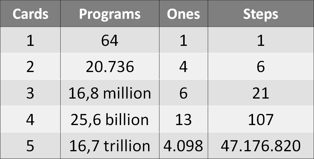

Searching for the maximum number of steps
In 1961 Tibor Radó introduced the Busy Beaver (BB) problem in his article On Non-Computable functions. Tibor Radó's introduction of the Busy Beaver problem created a fascinating connection to both earlier works. The Busy Beaver function BB(n) asks: "What is the maximum number of steps a halting n-state Turing machine can take before halting?" Where n represents the number of states in the program. Radó proved this BB function is uncomputable, directly linking to the Halting Problem. The only way the Halting Problem could be solved, is by simply running any machine for BB(n) steps and declaring it non-halting if it hasn't stopped.
The transformation from Radó's 1961 theoretical paper to an actual computational challenge began almost immediately. Tibor Radó defined the Busy Beaver Competition in 1962, just one year after introducing the mathematical concept. This marked a crucial shift from pure theory to practical exploration of the limits of computation. The first major milestone came with Shen Lin and Tibor Radó's 1965 collaboration, where they published an article on proving BB(3). Tragically, Radó died later that year, but their work established the first rigorous methods for actually computing busy beaver values rather than just proving their existence. The challenge has attracted both professional mathematicians and amateur enthusiasts. BB(1) – BB(5) are currently found and the search for BB(6) is ongoing.

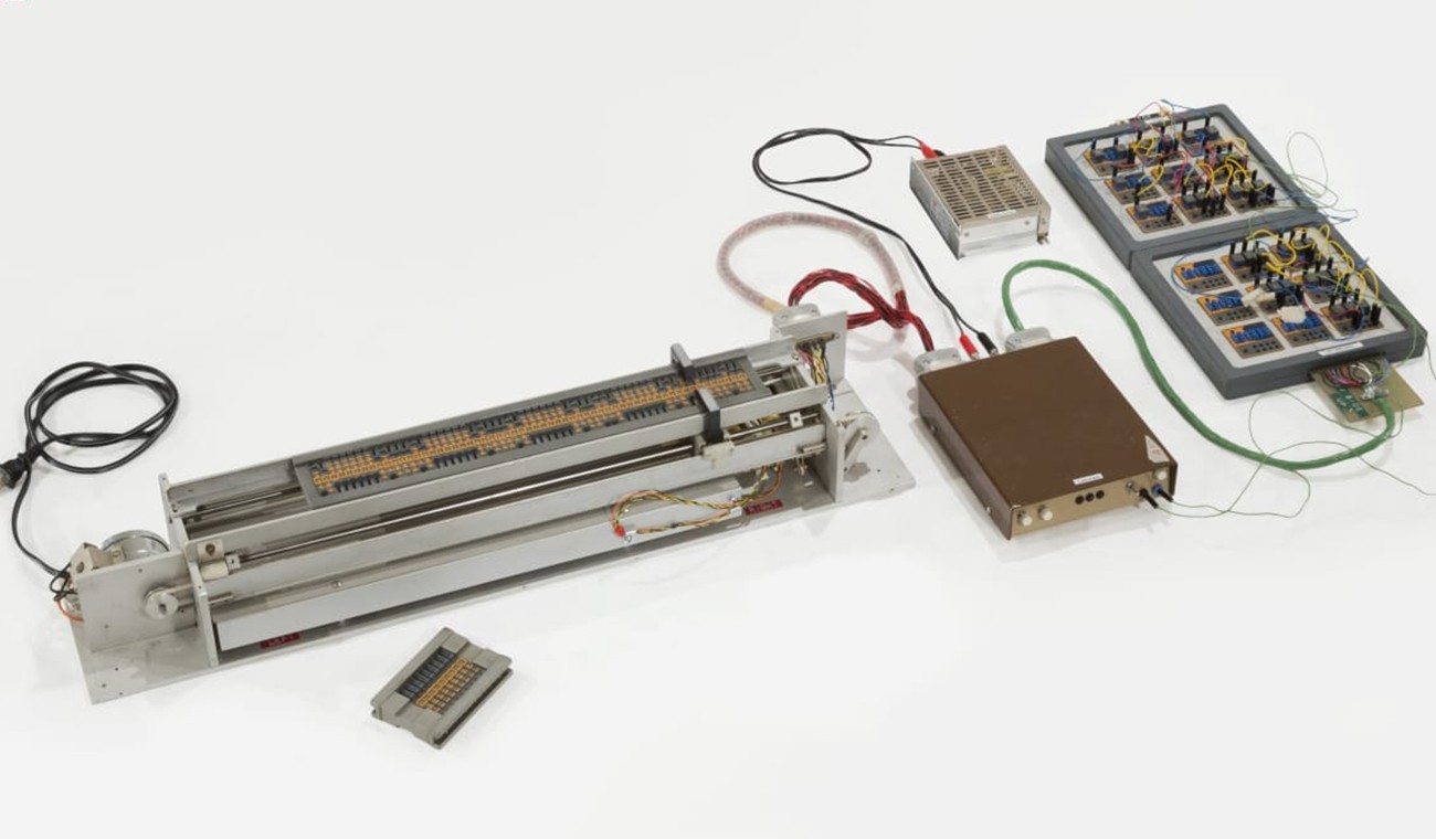

In 1972, Washington University professors Wesley Clark and Bob Arnzen likely made the first physical version of Turing's conceptual machine. Clark used the TOWTMTEWP (The Only Working Turing Machine There Ever Was Probably) as an educational tool, demonstrating basic computer theory for his students. Today, the TOWTMTEWP is housed in the collection of The Henry Ford museum, a testament to its significance in the history of computing. Unfortunately, it is currently not on public display.

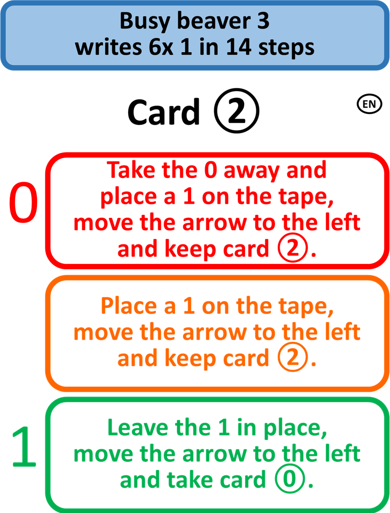

  • and the several busy bever programs, represented by (internal) state cards.
A tape on which three symbols can be written is used:, the 0, the 1 and the blank. That makes it easier to distinguish between written data and the blanco tape.

    The cards
    The cards are written In Dutch and English and put into a PowerPoint file, that can be found in the  file section. They can be entered (custom option) and ordered here: Order cards here. Please contact them first for the shipping costs to your country. The size of the cards is: 7,6 x 9,8 cm.
