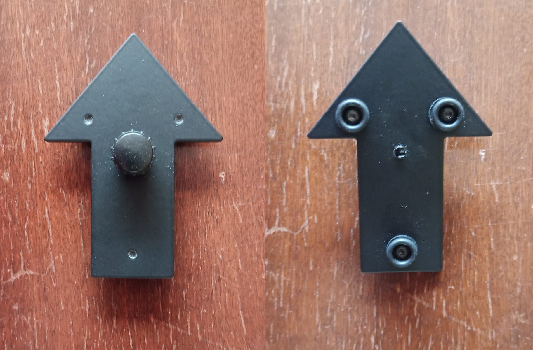

4The read/write head
The read/write arrow is made from a aluminium strip 8cm x 6cm x 3mm. The CNC source and G-code can be found in the file section. Three M3 holes are drilled, to place the arrow on rubber feet and a M4 hole is drilled for the knob. However, this arrow could also be 3d printed.

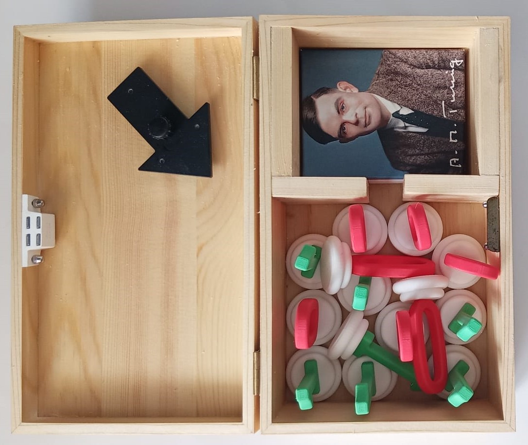

5The box
For the storage of pawns, arrow and cards I bought a wooden box ( 25 x 15 x 9 cm) from Aliexpress. Inside some wood is glued, to avoid the card deck opening during transport.
