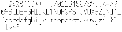

This project was mainly an excuse to play with a new display. I've done a fair bit with LCD's and the ePaper interface is extremely limited and the refresh rate very slow, so this wasn't about frame rates/fast updates for a change. I've also done a lot with displaying text on an LCD, with a variety of bitmap fonts, many of which I've crafted myself.  The *paper* aspect of this display led me to create a "stroked" font. This consists of line segments and arc quadrants encoded in a fairly compact form, 740 bytes.
Stroked Font
The Arduino doesn't have the RAM to create a frame buffer, but things like rendering the forecast icon and drawing the lines and arcs in the stroked font are much easier if you can access a buffer of pixels.
I took the idea of a "sparse" algorithm from things like my ElitePetite and LittleZone and wrote a new one, simpler and not focused on speed -- SparseInk.  This provides a "virtual" frame buffer which compresses the few pixels that are actually on, and is row-oriented, so sending the pixel information to the display is straight-forward. Additionally, the display is built from the top down, in bands, so the number of pixels stored at one time is small. The stroked font lines are a single pixel wide so the text is sometimes repeated offset by a pixel in the x and/or y direction for emphasis (bold).  There is also a slanted (italic) effect. Text and icons are dithered with grey pixels to reduce their intensity.
