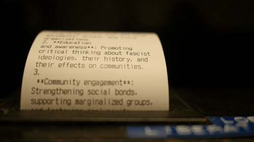

To protect the user, LALA1.0 stores its models entirely within its internal memory, so the queries never leave the device. The responses are printed on easy-to-destroy receipt paper, with no records kept in memory, ever. It even comes with a built-in thermal output eraser.

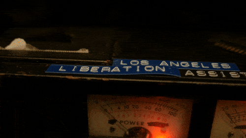

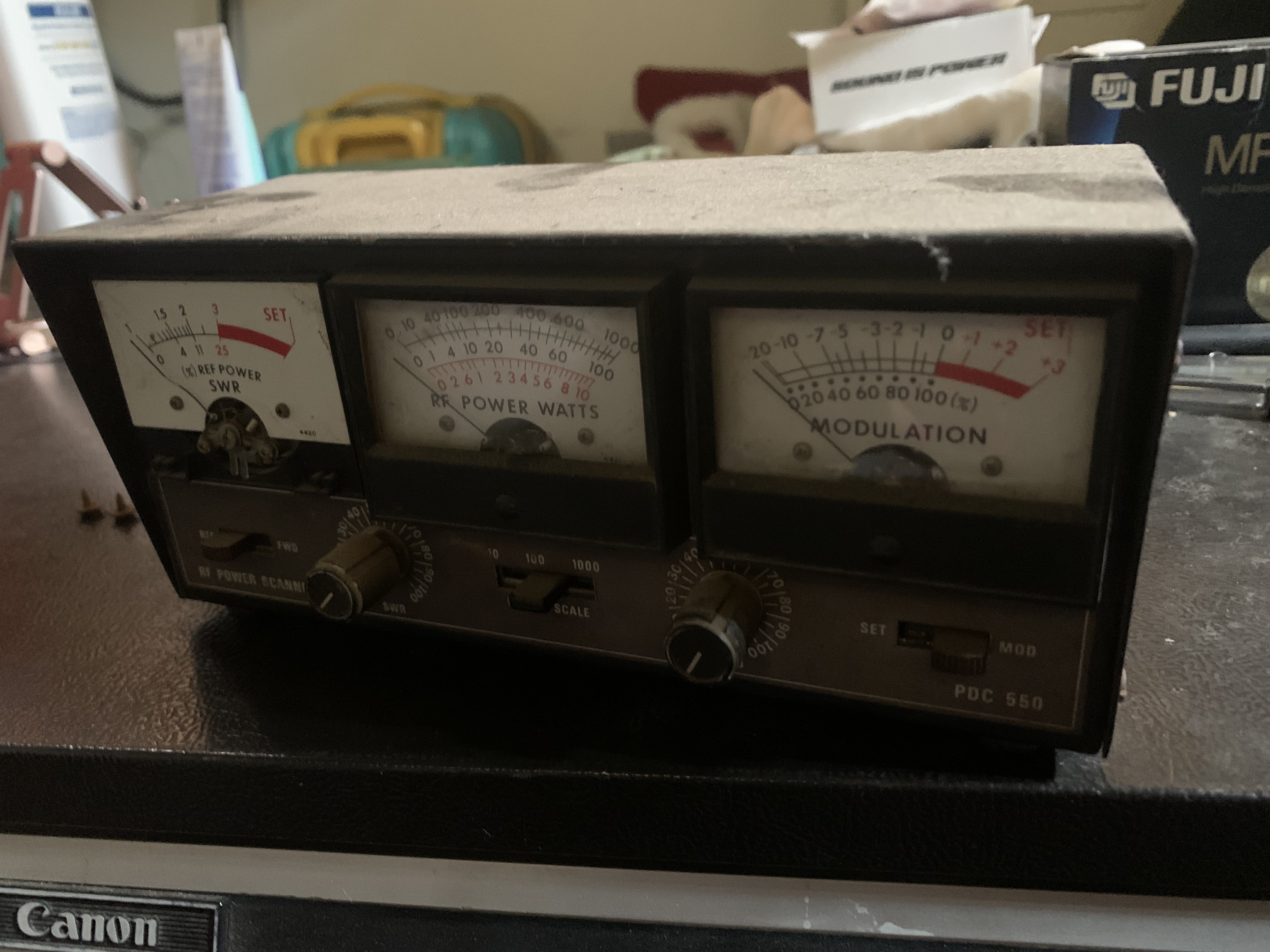

    The primary enclosure is a PDC550 CB band RF meter which comes to us by way of the 1970's, thanks to the Para Dynamics Corp. of Scottsdale AZ:
    PDC550
    It is a charming little meter, smaller than a loaf of bread, with a sturdy all-metal case and a serious appearance. This unit came to me via a flea market for the price of $5, with the leftmost meter missing its cover and having a bent needle. I bought it with no particular plan in mind, a dangerous act for someone who already has a big pile of frankly similar objects also collected with no particular plan in mind. But as always, when I discovered a use for it, I was grateful to my past self for bringing it home. It had the stern visage I was looking for, and the sturdiness of a device that might actually be able to survive some action. The main question was whether I could stuff a Raspberry Pi 5 into it.

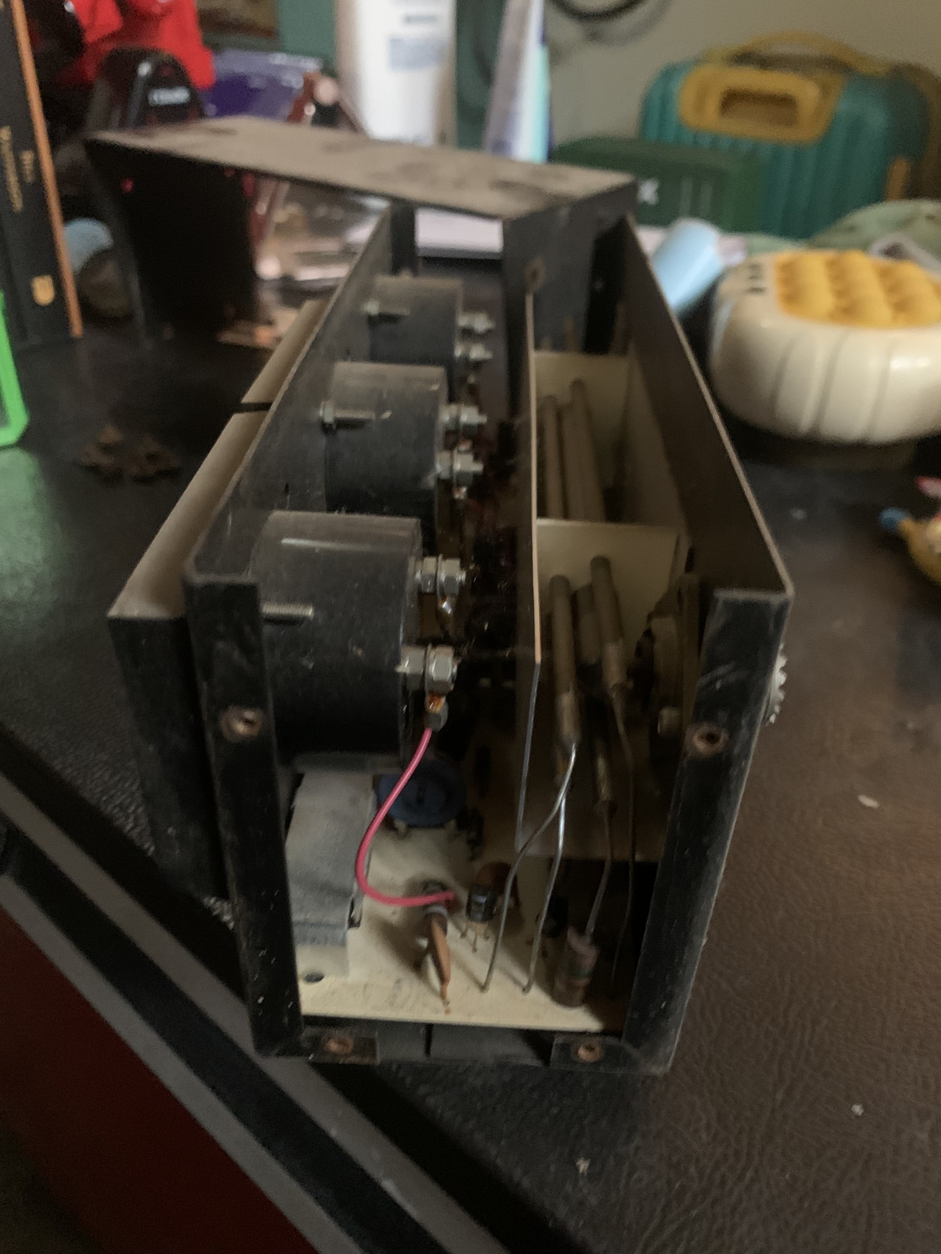

    Removing the top of the case revealed a fairly tight interior, with the analog meters occupying nearly half the space (seen here on the left), a big block of RF componentry occupying the other (right) half, and a circuit board on the bottom that carries the front panel's switches and knobs.

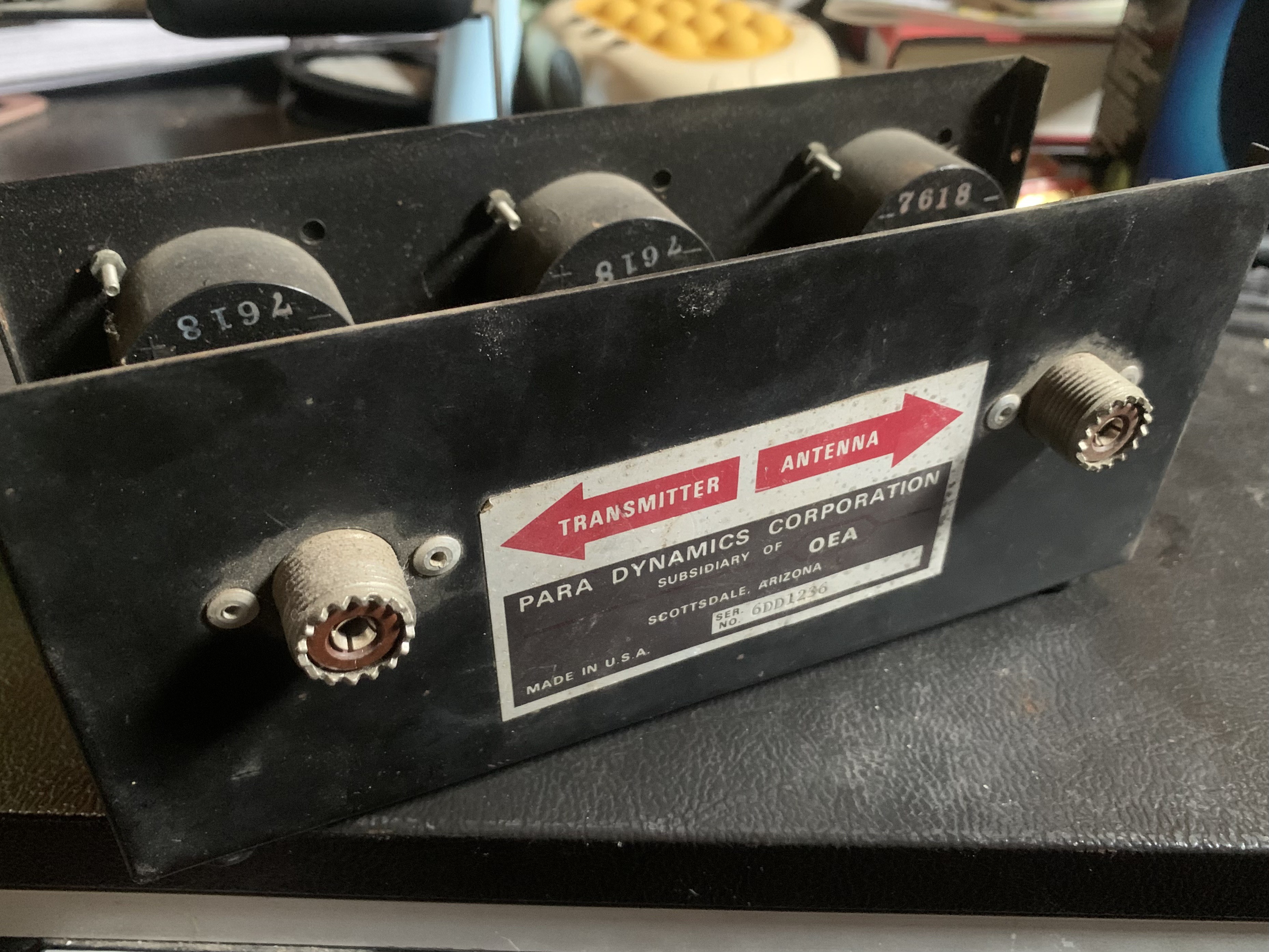

    First, I drilled out and removed these antenna jacks on the back:

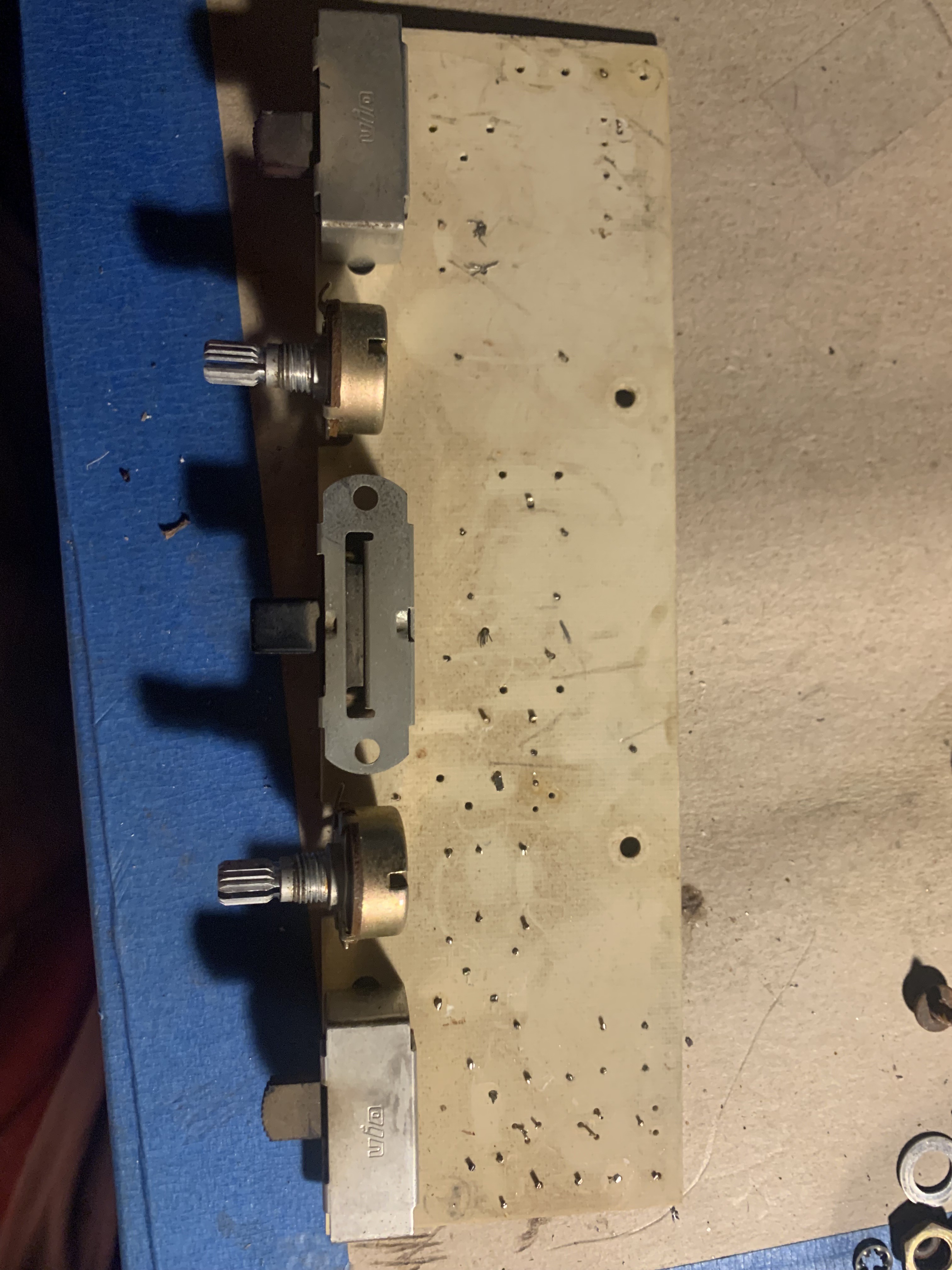

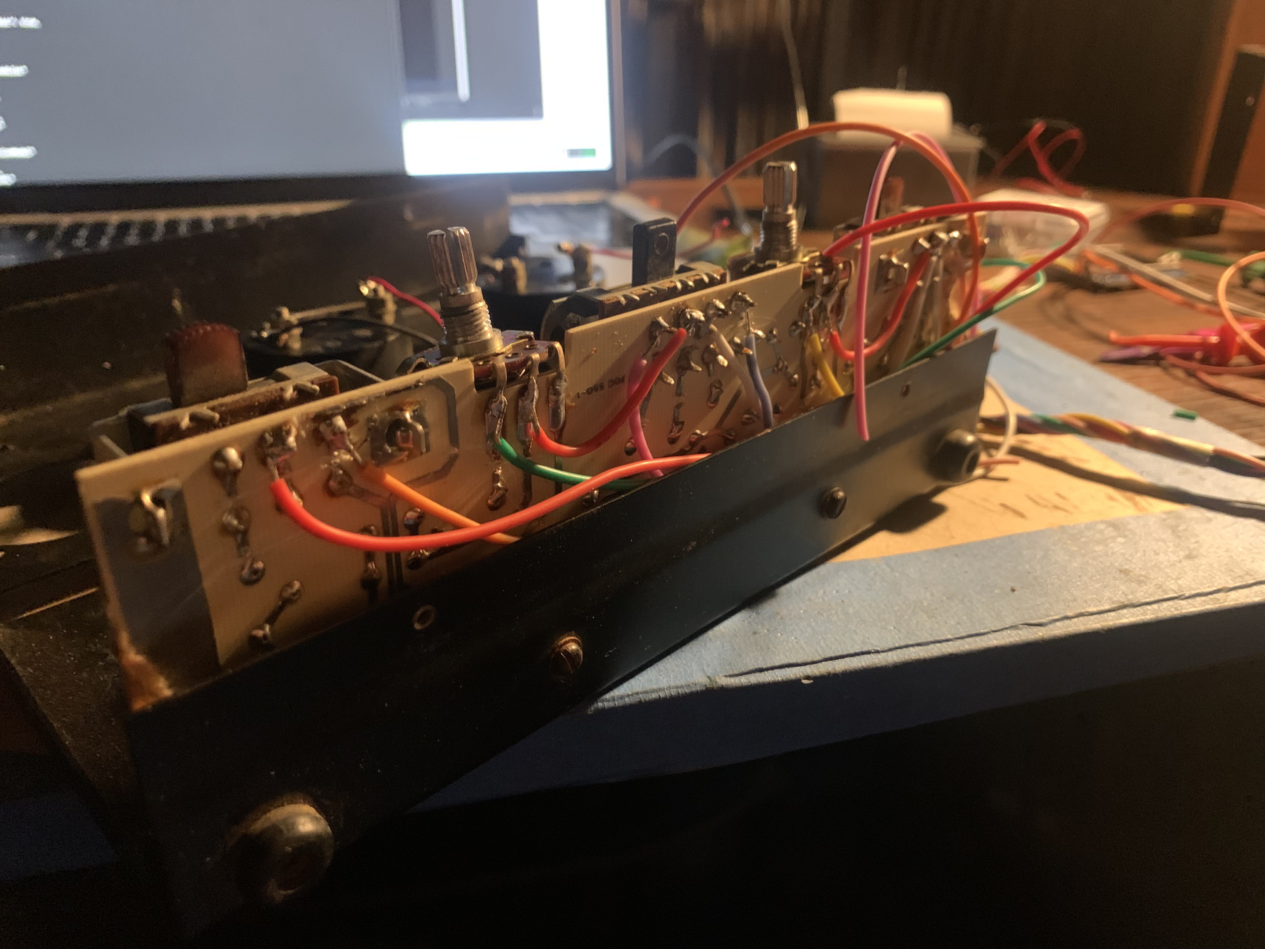

    Then, I took out the circuit board and snipped off all the components (except for the front panel stuff) in order to make extra room in the case:

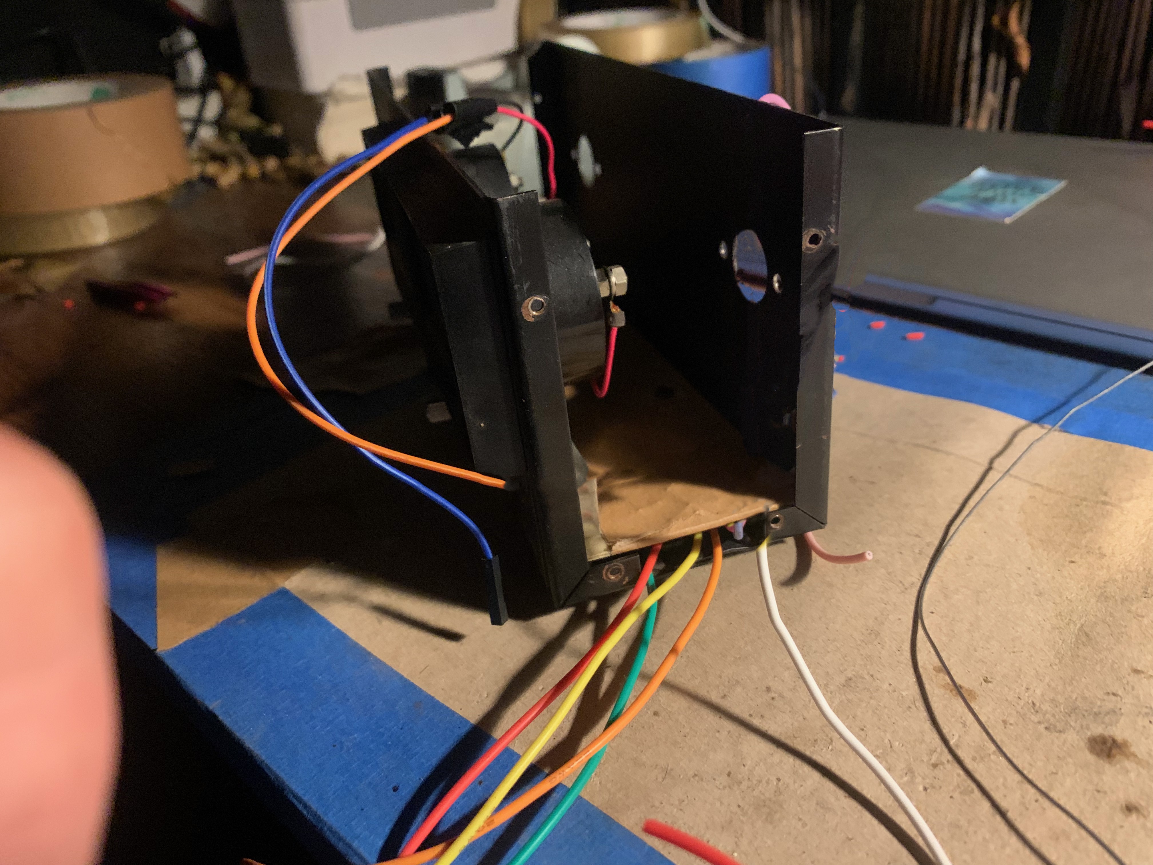

    ...and soldered new leads to all the switches and knobs before reinstalling the now bare board. This allows the original switches and knobs to be used by whatever new hardware we'll eventually install:
    I removed the busted left meter, and Impressively for fifty year old hardware the other meters worked just swell when i tested them with some PWM from the Pi:
    Now that the case was put back together, I could get a better sense of the space I had to work with. The Pi seemed like it would be a rather easy fit:

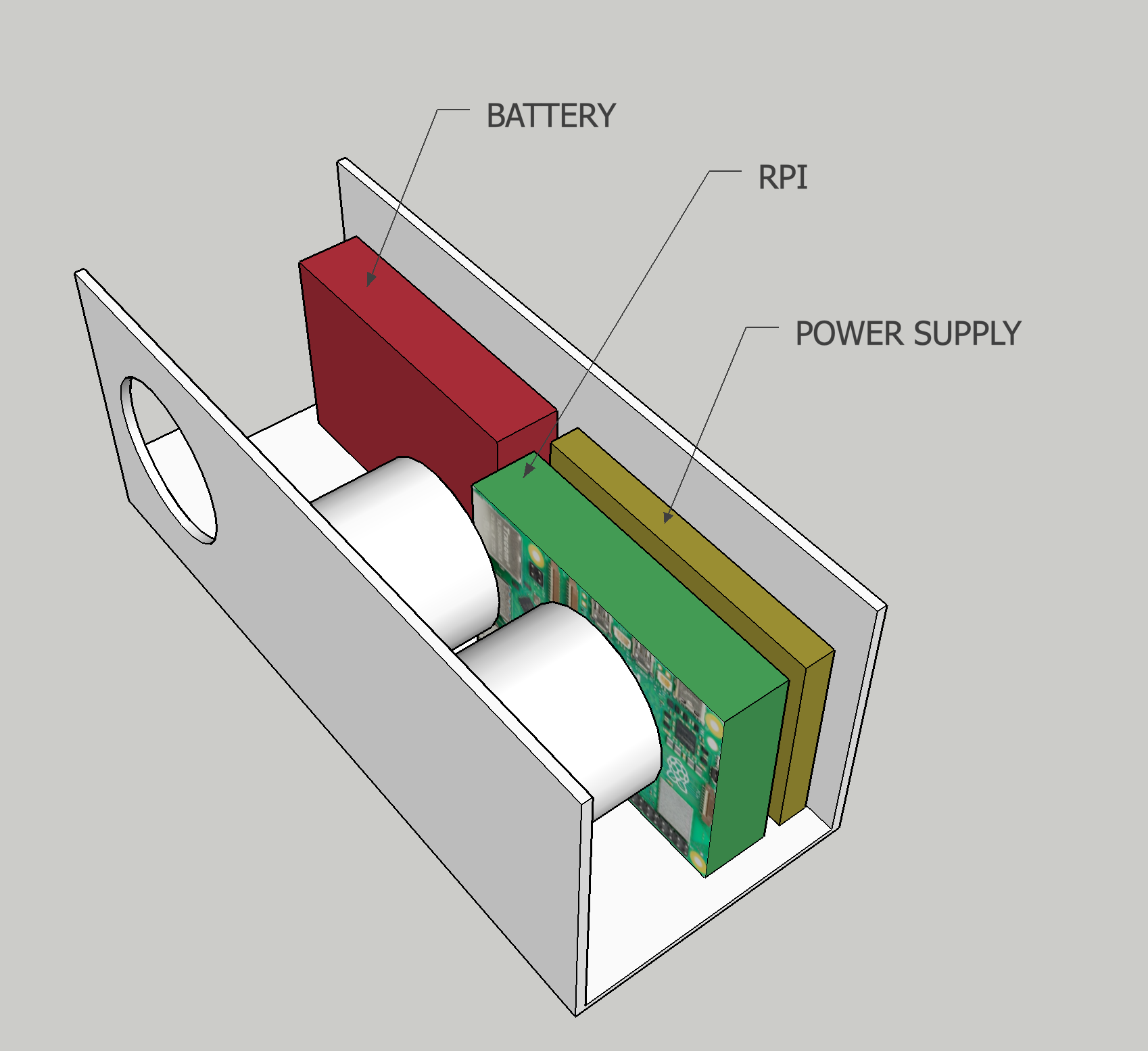

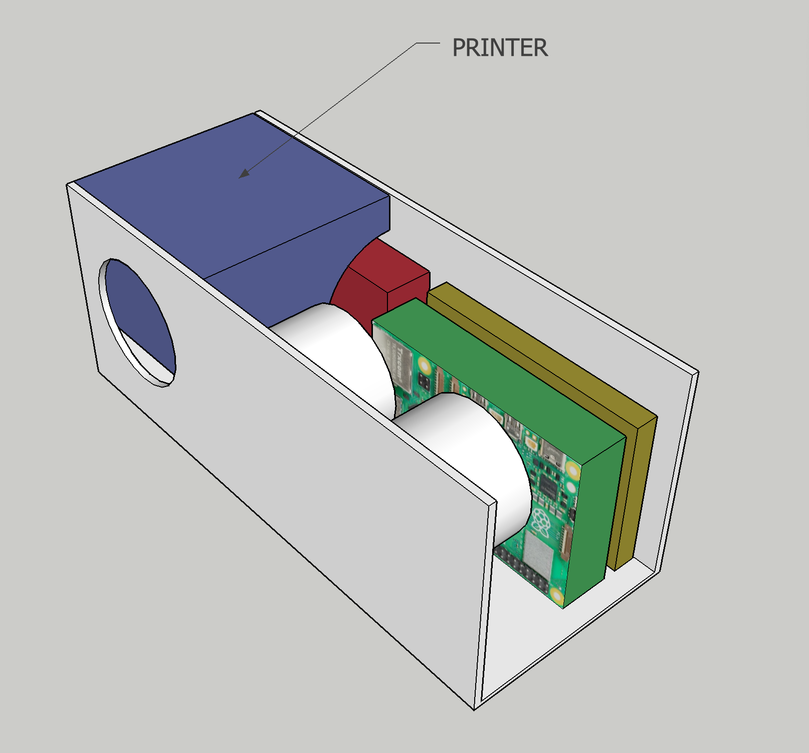

    Here's a clear view of my plan for how the Pi, the power supply and the battery would fit into the case:

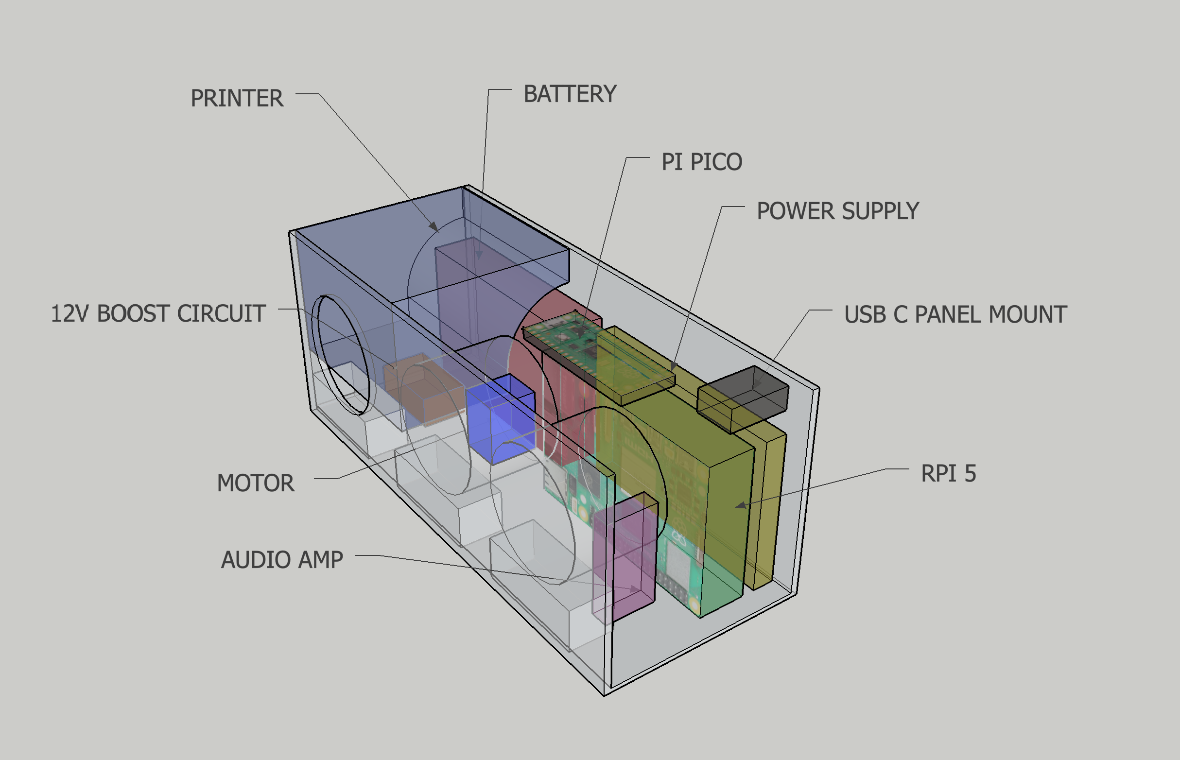

    The majority of the remaining room on the left side in front of the battery will be taken up by the thermal printer, which occupies the space that was freed by removing the damaged leftmost meter:
    I should pause here to admit that I made these renders after the fact, just for this documentation. In real...
