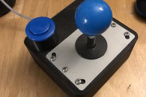

There is a 3d printed case from PLA that I designed in Fusion 360. It uses metal threaded inserts to fix the cover and rubber half-spheres as feet.
The microcontroller inside emulated standard HID to act as a keyboard. Therefore no software or drivers are necessary on the PC side.
The coolest part was making the lettering. I printed letters as valleys. Covered the top with dish soap. Let it dry and applied silicone adhesive. This is the kind that is usually find inside electronics. I smeared it with a finger while wearing gloves. And when silicone has cured it was removed.

    Apply soap around letters
    Smear silicone. Adding masking tape helps
    Wait for silicone to cure
    Remove silicone with your fingers. Wash in warm water
    Install button and board
    Use heat inserts and m3 screws to attach the bottom cover. Or simply glue it
    Push something into git !

murraythegoz wrote 07/02/2025 at 16:27 point
What microcontroller are you using?
penumbriel wrote 07/04/2025 at 12:41 point
Atmega 32u4 because it supports HID over USB
Cybnew wrote 06/21/2025 at 16:39 point
Do you have a link to the button you used?
penumbriel wrote 06/22/2025 at 00:09 point
Hi, the link does not work anymore because the Ali shop changed the listing. But it ok! Because you can use any other button with 30mm diameter. Just search for 30mm button and pick one based on color you like.
