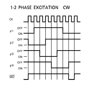

One question that came up initially is why the special frequency for the oscillator? The reason becomes clear if you work your way backwards. The stepper driver operates the motor in 1-2 phase excitation as shown below:
This effectively steps one tooth per 8 clock cycles (but in a manner that reduces vibration, which is good for its application).
The stepper motor is rated for 24 teeth per revolution, and has a 500:1 gearbox attached, plus another 20:1 factor for the worm gear drive, for a total gearbox factor of 10,000:1.
In normal tracking mode, the full 14 bit counter divider is in play, so the input frequency is first divided by 2^14 before generating the clock for the stepper driver. Putting all of these together, we can compute the final output rotation rate:
This gives a rotation of 15.41714 degrees per hour which is fairly close to the sidereel rotation of 15.04 degrees per hour. There may be some other factors that I'm not aware of, but at least at first glance, the reason for the odd frequency is they backed out what single clock part they needed to get the frequency stability and approximate tracking needed.
