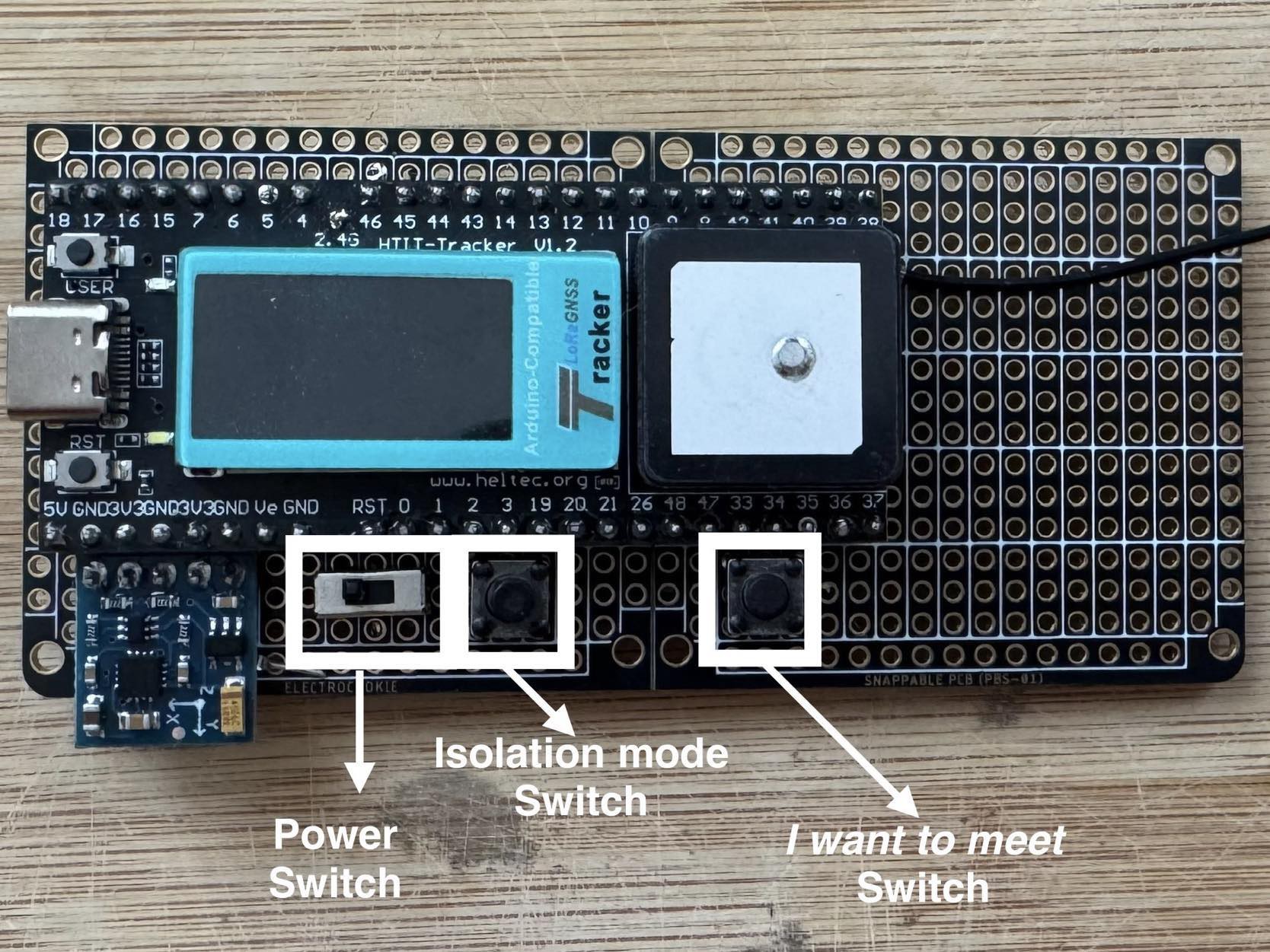

- Heltec Wireless Tracker
- GY-271 Magnetometer
- Any 3000mAh LiPO 1S/1C with JST 1.25 Connector like this one

5. Usage
5.1 User Inputs
5.2 Output (Display)

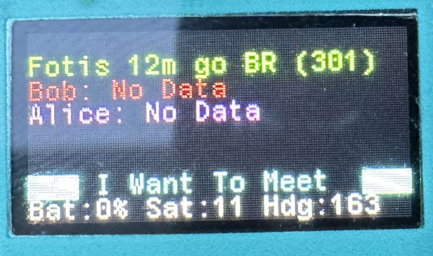

The display has a health bar on bottom that show the battery level, the GNSS status and the status of the magnetometer (magnetic compass). The main display has has up to 6 lines each one showing the distance and direction to a paired device.
There are two modes of operation:
- Active Mode: When you are looking for your friends, the device will show the distance and direction to each of them. The display is on and doing some calculations on the background and as a result is consuming more power.
- Isolation Mode: When you don't care about your friends, and just want to dance. The device will keep exchanging data, as your friends might actually care about you. In this mode the display is off and the device is consuming less power. It is recommended to be on this mode when you are not actively looking for your friends. It can be activated by pressing the small USR button on the top left corner of the device. The effect might take up to 2 seconds to take effect. In order to switch back to active mode, you need to press the button again.
- Setup Mode: The user can enter the setup up mode by pressing the button on the top left corner of the device, when the device is booting. Setup mode allow the user to calibrate the magnetometer. The calibration parameters are stored in the Non-Volatile Memory of the device, so they will be available even after a power cycle. The calibration is done by rotating the device in all directions, until the calibration is complete. The display will show the progress of the calibration and will indicate when it is done. After the setup is completed, the device will reboot.
In addition to this there is an I WANT TO MEET option which can be activated by pressing the button the bottom right corner of the device. This will send a message to all paired devices that you want to meet them. The message will be shown on their displays as well as a clear indication on you own display, that you are transmitting this message. To stop transmitting this message, you need to press the button again.
