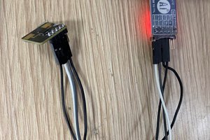

2.2 Module Wiring
Rd-03L_V2 Module
USB to TTL Converter
3V3
Vo (3V3)
GND
GND
TX
RXD
RX
TXD
