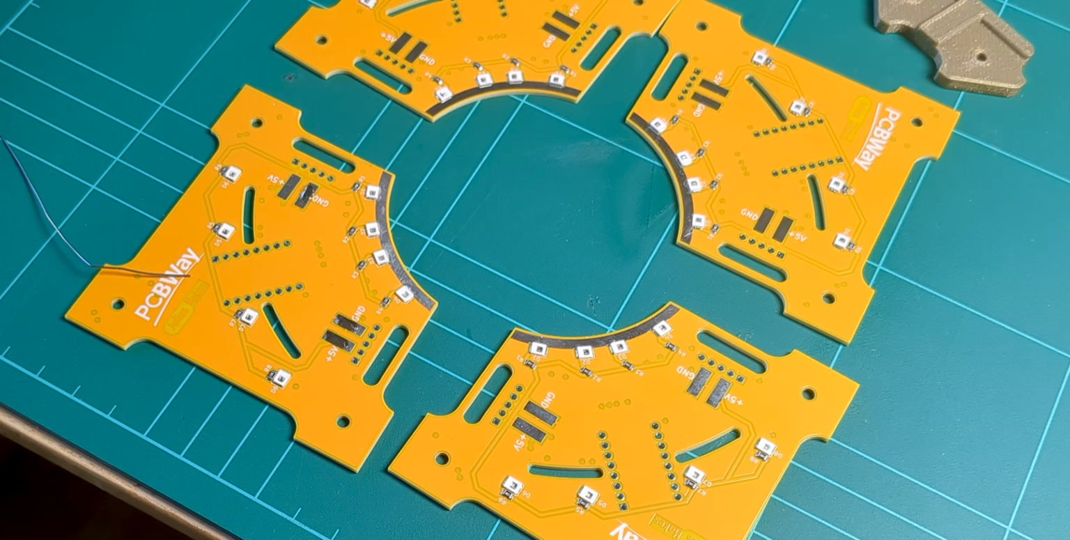

First, PCBs
To make your own, you'll need to get the PCBs ordered first, because there will probably be a bit of a wait time on that order (1-2 weeks or so). The PCBs are the ones that give this that cool real look, so there's no way around it. On the positive side, they should be rather cheap.
You will want to go to this project and either straight order it through PCBWay (you can also get the LEDs+resistors assembled, won't be that cheap anymore but zero hassle), or you can download the gerber files and reupload them to your PCB provider of choice.
Note: Don't solder wires before mounting.

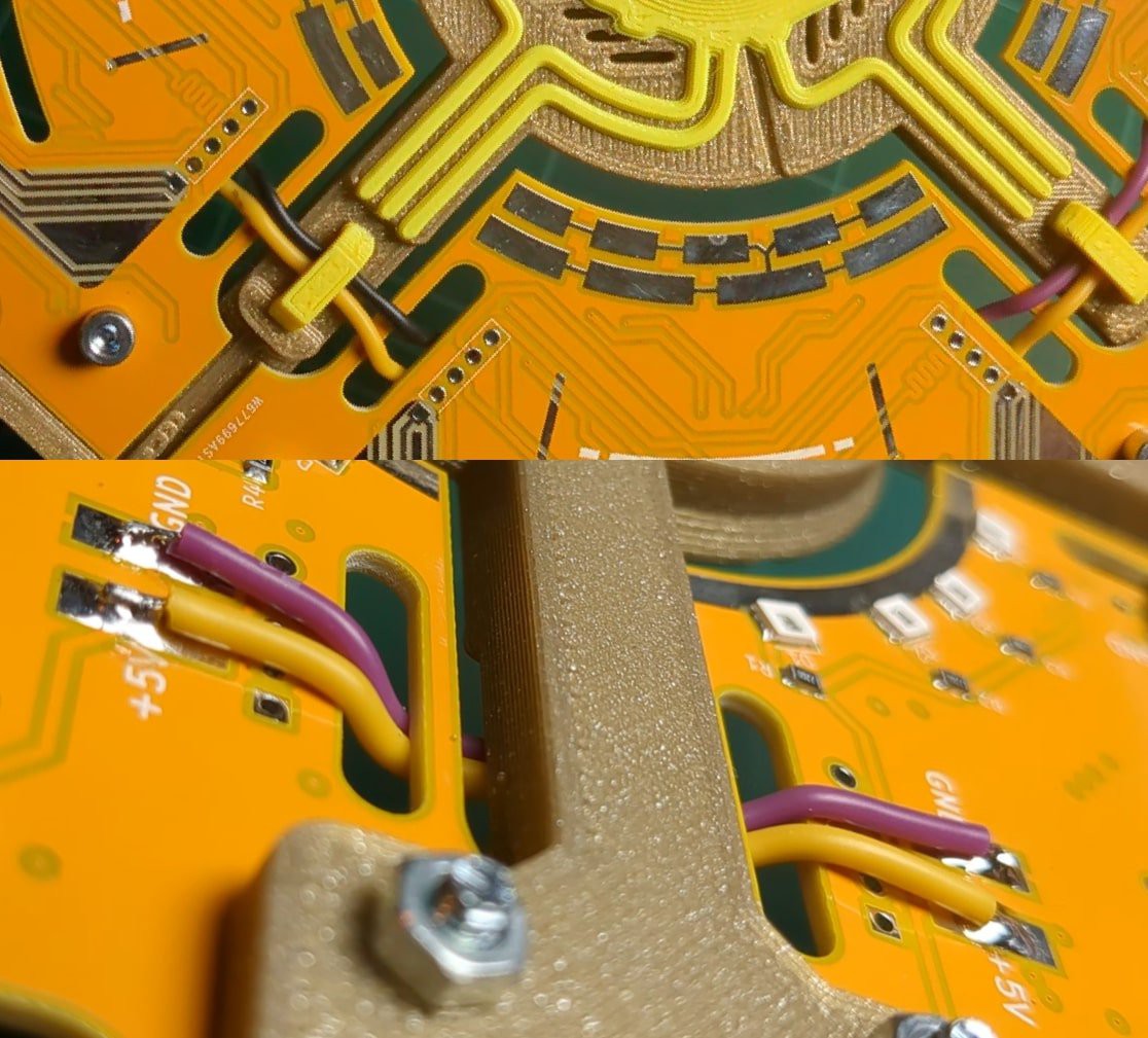

Wire Up
Great, now you are ready to wire everything together. I designed some slots in both the PCBs and the InnerPCBsMount for easy snag-free wire routing. So you'll mount the PCBs to the 3D printed "cross", then you'll have to solder one side of the wire, route it all the way to the other pad and solder the second end.
Now power it up at 5V and enjoy.
