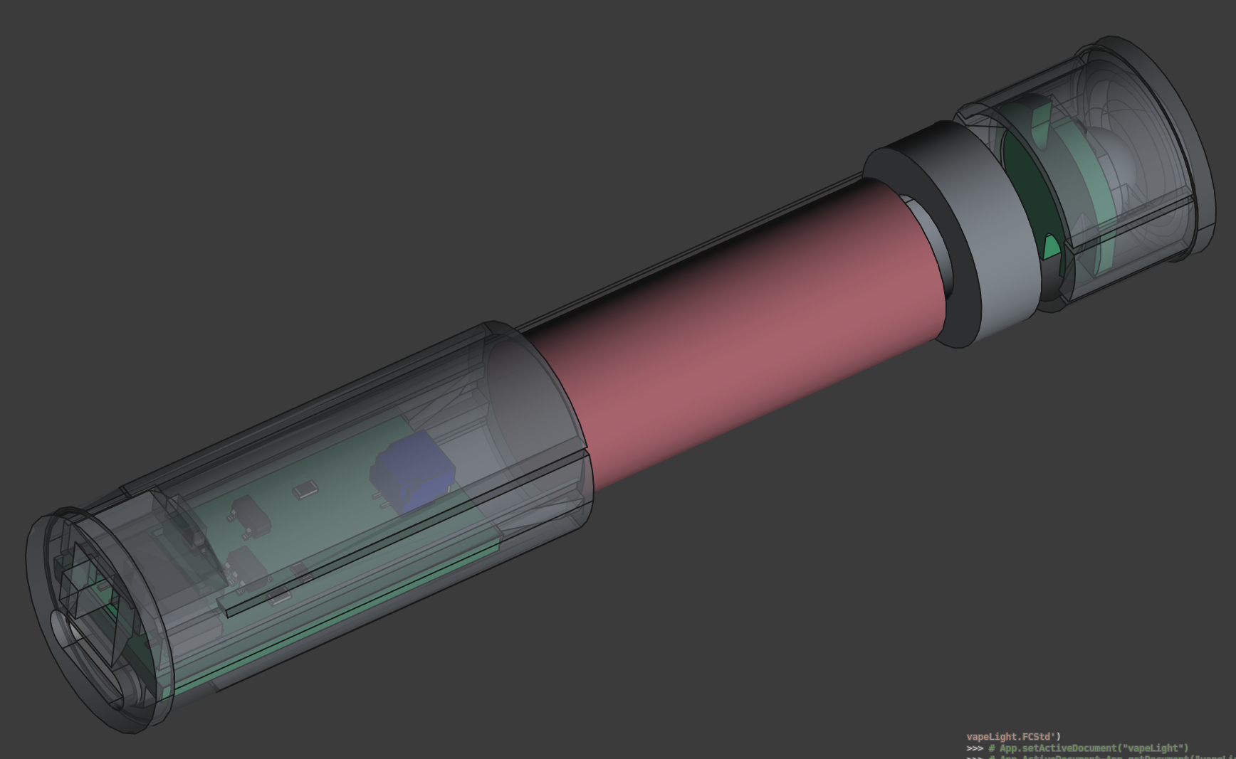

The PCBs are held in the Elfbar with 3D-printed parts. These are press-fit, so no glue or screws are required. Additionally, I made use of a spacer, to separate the (possibly) hot LED PCB from the LiPo.

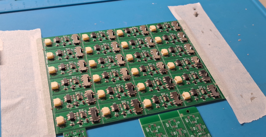

I ordered the PCBs in panels, and assembled them by hand. The LED PCB were very simple, as there is only one part per PCB, and the solder pads are huge. The charger PCBs were quite challenging however, as they are double-sided. For the side with the most components, I used regular lead-free paste and a hotplate. The other side was assembled with low-temperature paste and a heatgun.
The batteries and LEDs were connected to the charger PCB using pre-crimped wires.
