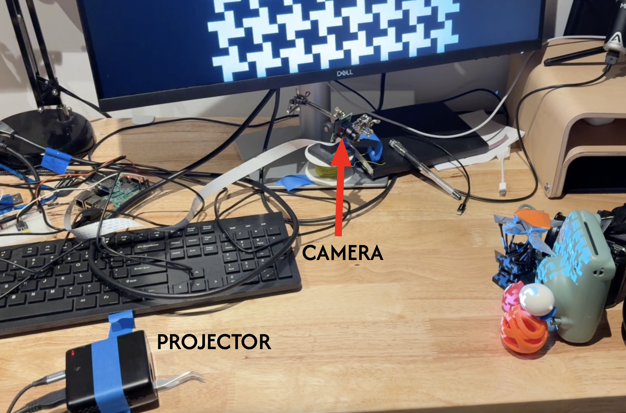

    I recently continued this work using a camera and projector, instead of the LED matrix and single photodetector.
    The video with a full explanation for this work is here: https://www.youtube.com/watch?v=TcXMf0mTh94

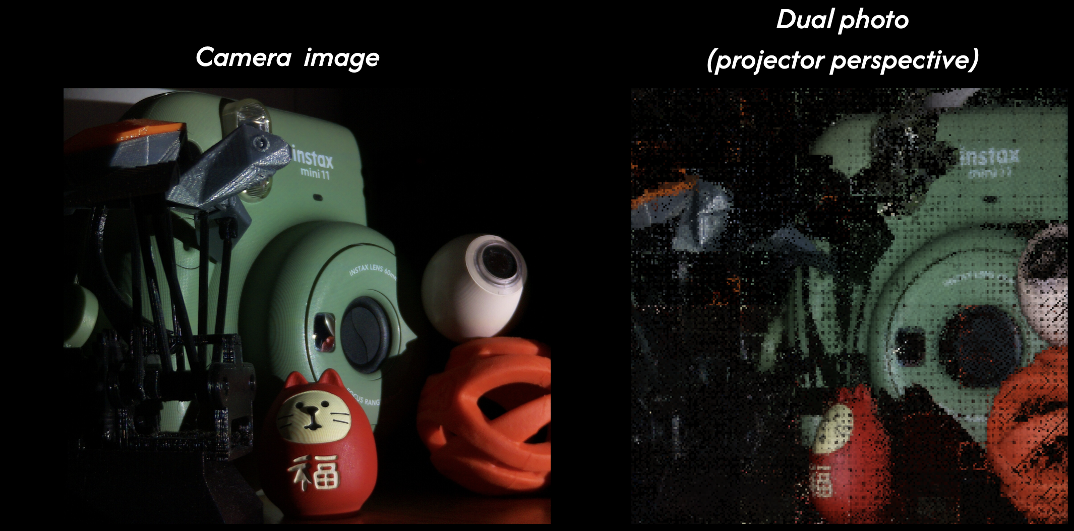

    The basic idea is to measure the light transport between a projector and camera by mapping each illumination pixel to camera pixels. With this amazing things are possible:
    1) Reconstructions from the perspective from the projector
    2) Synthetic illumination - reconstruct images to appear as though they were illuminated with any illumination pattern
    One of the keys to implementing this with a camera is binary encoded structured illumination. The video has an explanation for how this works and it is the key to data acquisition. Instead of illuminating the scene one illumination pixel at a time, each illumination pixel has a unique binary code. Each digit in the code corresponds to a different illumination sequence. 1 means that the illumination pixel is on during that pattern and 0 means that it is off for that pattern.

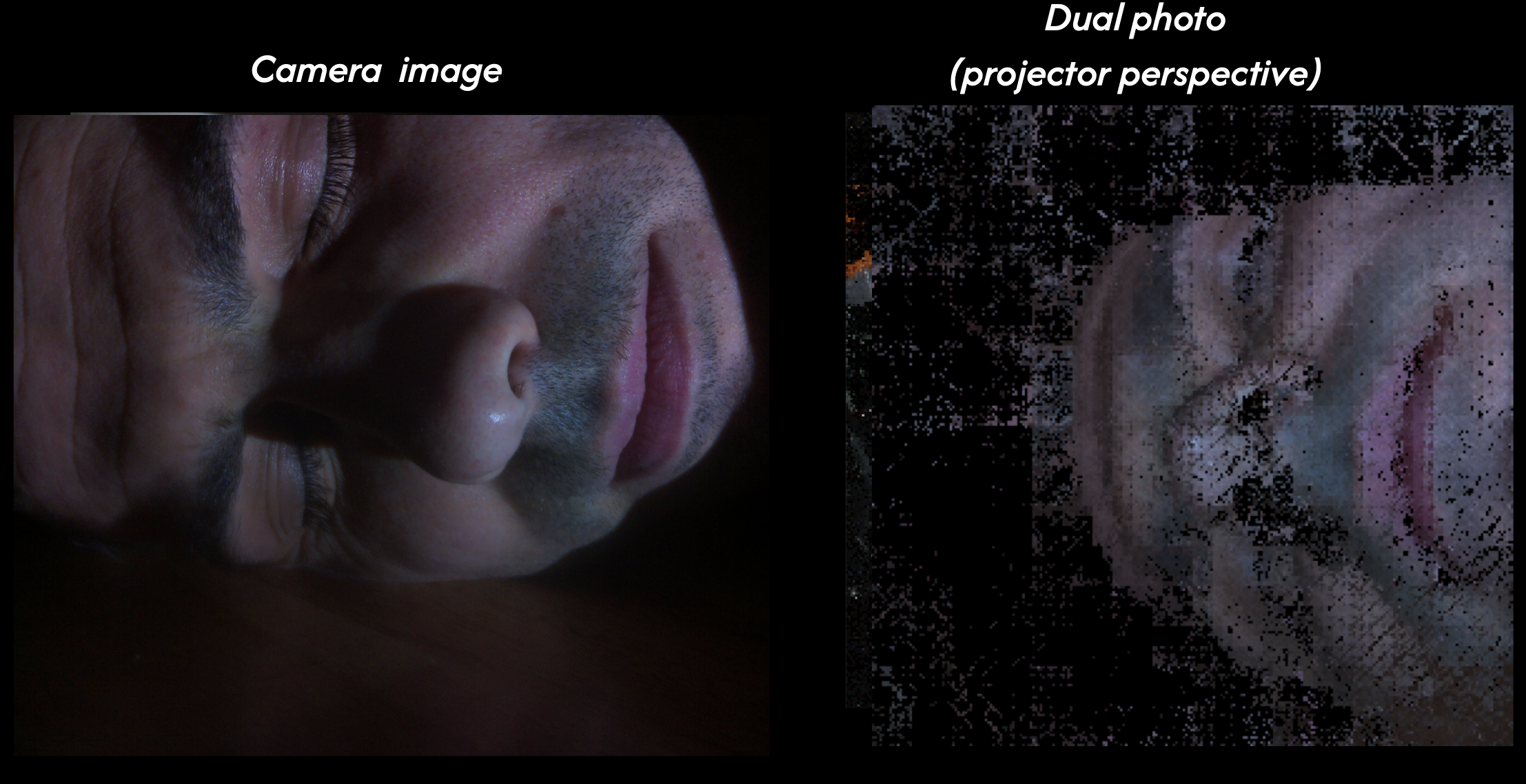

    I also did some dual photos of my face, and they are eerie.
