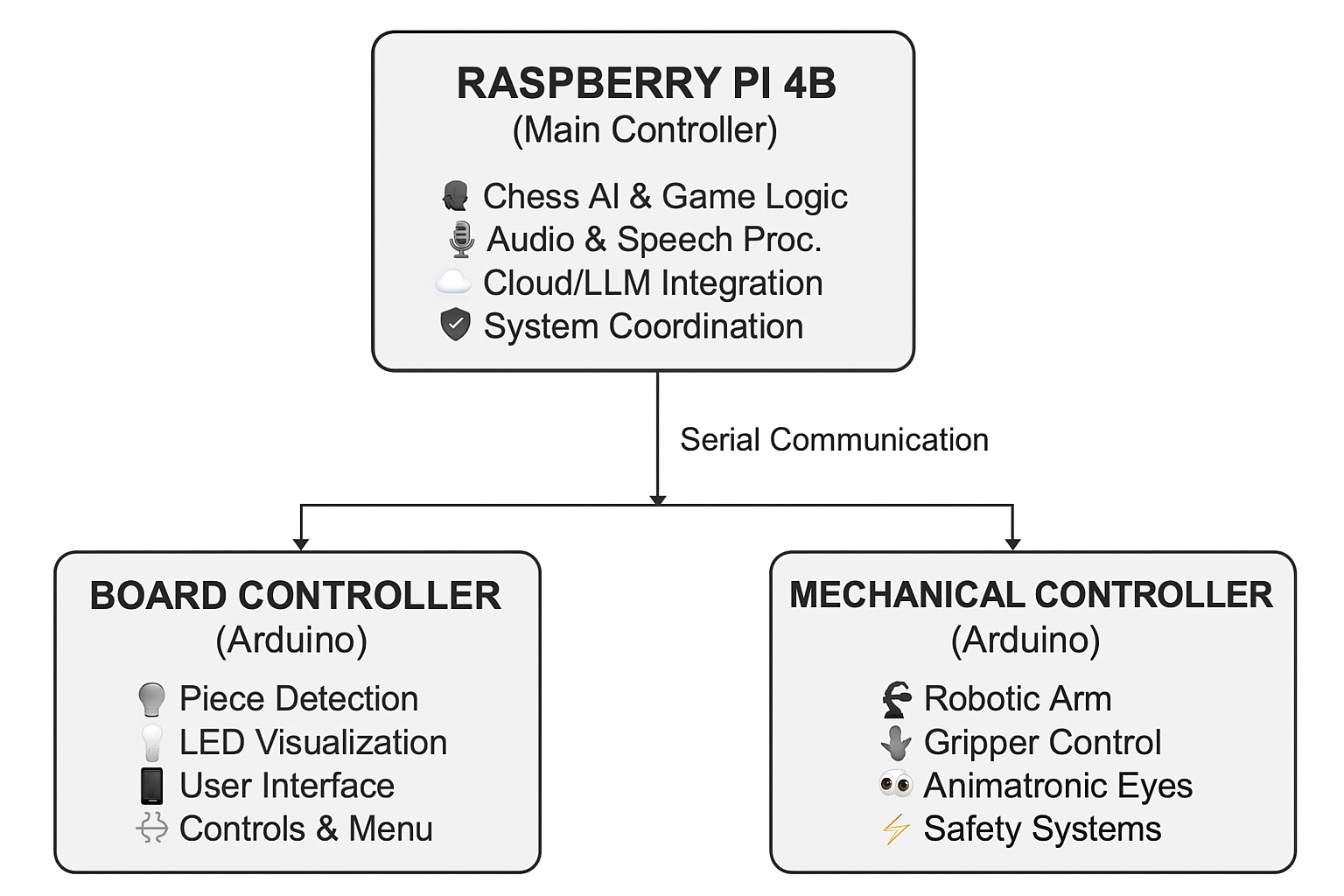

System Architecture
Distributed Multi-Controller Design
ChessMate uses a three-controller architecture where each processor handles specific tasks optimized for its capabilities. This distributed approach ensures reliable real-time performance while maintaining system modularity and expandability.
Controller Responsibilities
  • 🧠 Raspberry Pi - The Brain
    • Chess engine integration and move calculation
    • Game state management and rule enforcement
    • Audio processing for speech and sound effects
    • Future cloud connectivity for intelligent commentary
    • System-wide coordination and safety oversight
  • 👁️ Board Controller - The Senses
    • Real-time monitoring of all chess piece positions
    • Visual feedback through LED matrix displays
    • User interface management (menus, buttons, display)
    • Move detection and validation
    • Player interaction handling
  • 🦾 Mechanical Controller - The Body
    • Precision robotic arm movement control
    • Adaptive gripper operation for different pieces
    • Animatronic facial expressions and eye movements
    • Safety systems and emergency stop coordination
    • Real-time motion execution
Why Distributed Architecture?
  • 🎯 Performance Benefits
    • Real-time motor control runs independently of AI processing
    • Sensor monitoring continues uninterrupted during chess calculations
    • Each controller optimized for its specific tasks
  • 🔧 Reliability Advantages
    • System continues operating if one controller fails
    • Independent recovery and restart capabilities
    • Safety systems remain active even during software issues
  • ⚙️ Development Benefits
    • Modular design enables parallel development
    • Easier debugging and testing of individual subsystems
    • Incremental updates without system-wide changes
Communication Flow
The controllers communicate through a simple serial...

    2. LCD Display Interface (lcd_display_node.py)
    Purpose: Provide visual feedback through SSD1306 OLED display for game status and menu navigation.
    Hardware Specifications:
    • Display: SSD1306 OLED 128x32 pixels
    • Interface: I2C communication
    • Address: 0x3C (configurable)
    • Library: Adafruit CircuitPython (modern implementation)
    ROS 2 Integration:
    • Node: LCDDisplayNode
    • Subscribed Topics:
      • /lcd_commands (chessmate_msgs/LCDCommand)
    • Message Fields:
      • timestamp: Command timestamp
      • command_type: CLEAR(0), WRITE_TEXT(1), WRITE_LINE(2), SET_CURSOR(3)
      • text: Text content to display
      • line: Target line number (0-3)
      • column: Target column position
    Key Features:
    • Automatic hardware detection and fallback to mock mode
    • PIL-based text rendering for flexible display formatting
    • Multi-line text support with automatic wrapping
    • Cross-platform compatibility (development vs production)
    Dependencies Added:
    install_requires=[    'setuptools',    'pyserial',    'pillow',  # For LCD image processing    'adafruit-circuitpython-ssd1306',    'adafruit-circuitpython-busio',
    3. Game Management System (game_management_node.py)
    Purpose: Coordinate chess game flow, menu system, and hardware interface integration.
    Menu System:
    1. New Game - Start fresh chess game
    2. New Puzzle - Load chess puzzle
    3. Computer Time - Set computer thinking time (1-30 seconds)
    4. Human Time - Set human move time limit (30-300 seconds)
    5. Color - Choose player color (White/Black)
    6. Level - Set difficulty level (1-20)
    7. Shutdown - Safe system shutdown
    8. Manual Move - Override move input
    ROS 2 Integration:
    • Node: GameManagementNode
      • /rotary_encoder_events (chessmate_msgs/RotaryEncoderEvent)
    • Published Topics:
      • /arduino_commands (chessmate_msgs/ArduinoCommand)
    • Service Clients:
      • /get_best_move (chessmate_msgs/GetBestMove)
      • /evaluate_position (chessmate_msgs/EvaluatePosition)
      • /validate_move (chessmate_msgs/ValidateMove)
      • /update_game_state (chessmate_msgs/UpdateGameState)
    State Management:
    • Hierarchical menu navigation
    • Game state tracking (menu vs gameplay)
    • Parameter persistence across sessions
    • Integration with chess engine services
    4. Arduino Communication Enhancement (arduino_communication_node.py)
    Purpose: Improved communication protocol with Arduino board and arm controllers.
    Protocol Updates:
    • Added CMD_INIT = 0 for board initialization
    • Added CMD_HEARTBEAT = 10 for connection health monitoring
    • Enhanced response processing for actual Arduino format
    • Occupancy data conversion (algebraic → numeric indices)
    Response Processing Improvements:
    • 4-character move recognition (e.g., “e2e4”)
    • Special code handling (“ffff” for hint override)
    • Status indication parsing (“i”, “j”, “z”)
    • Debug message interpretation
    Data Format Conversion:
    def _format_occupancy_data(self,...

    Launch System Design
    Flexible, Parameterized Startup:
    def generate_launch_description():    # Dynamic URDF processing    robot_desc = Command(['xacro ', urdf_file])        return LaunchDescription([        # Core robot state        Node(package='robot_state_publisher', ...),        # Interactive control (development)        Node(package='joint_state_publisher_gui', condition=IfCondition(...)),        # 3D visualization        Node(package='rviz2', arguments=['-d', rviz_config])    ])
    Benefits:
    • Runtime Configuration: Parameters can be changed without recompilation
    • Conditional Execution: GUI components disabled for production deployment
    • Environment Adaptation: Different configurations for development vs. production
    Technical Challenges & Solutions
    1. Xacro Processing Pipeline
    Challenge: Parameterized robot descriptions need runtime processing
    Solution: Integrated Xacro processing into launch system
    robot_desc = Command(['xacro ', urdf_file])  # Process at launch time
    2. Multi-Machine Communication
    Challenge: Seamless data flow between development machine and robot
    Solution: ROS 2 DDS middleware provides automatic discovery and communication
    3. Real-Time Requirements
    Challenge: Chess piece manipulation requires precise timing
    Solution: Distributed architecture - Pi handles real-time, desktop handles planning
