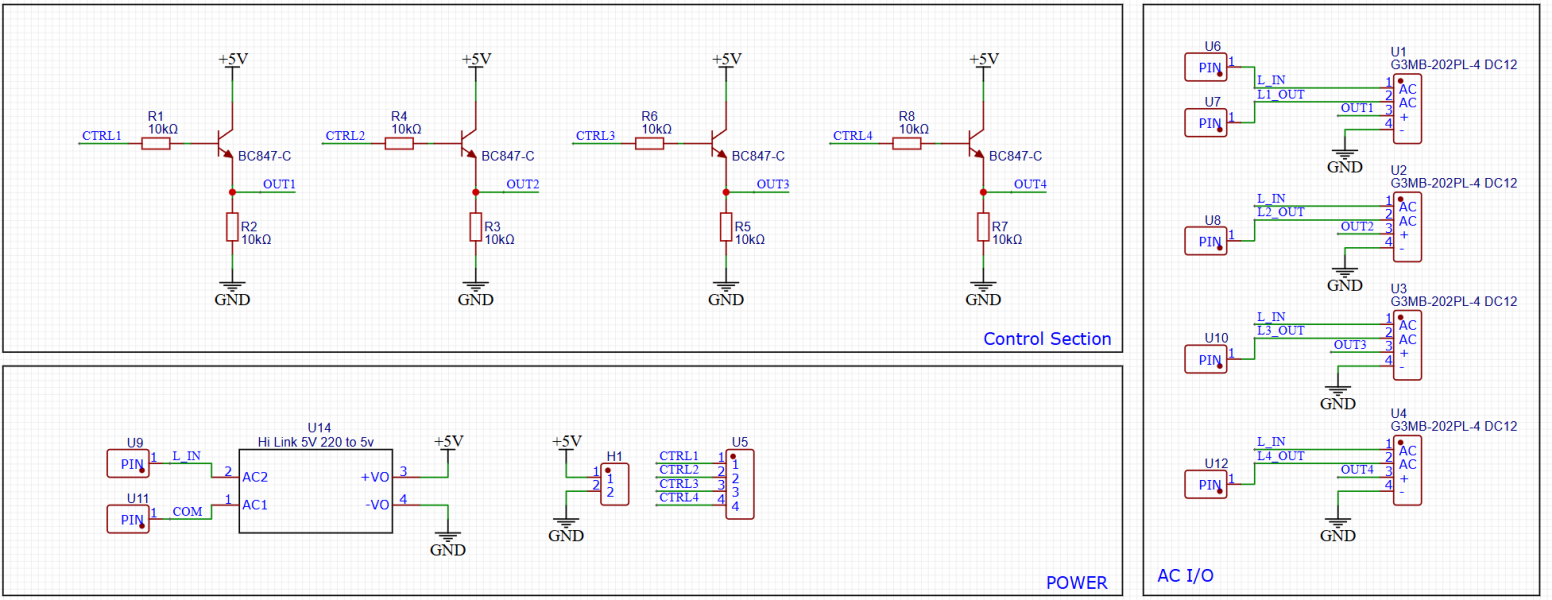

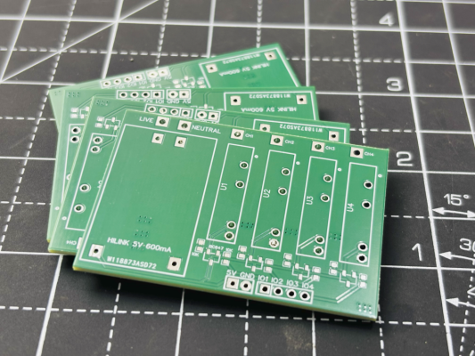

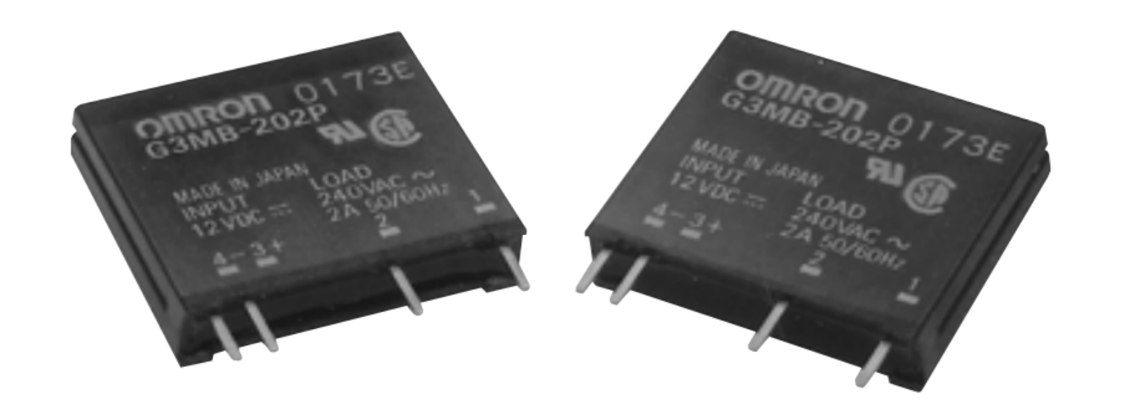

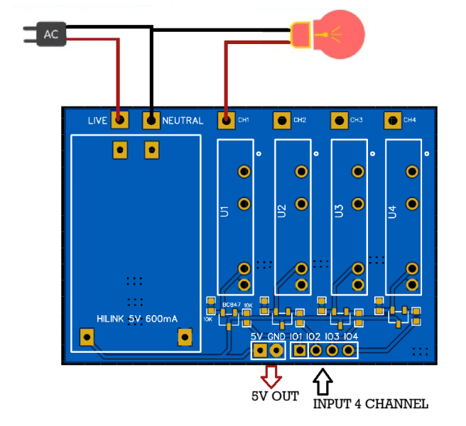

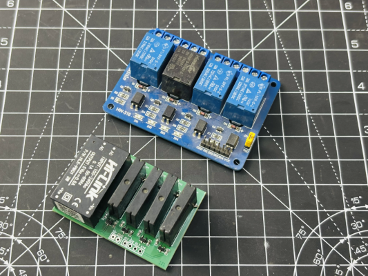

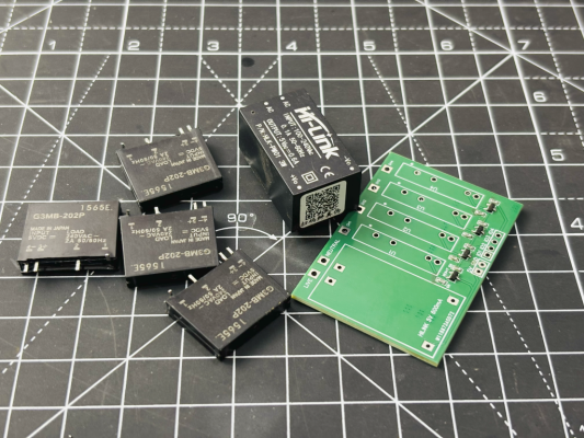

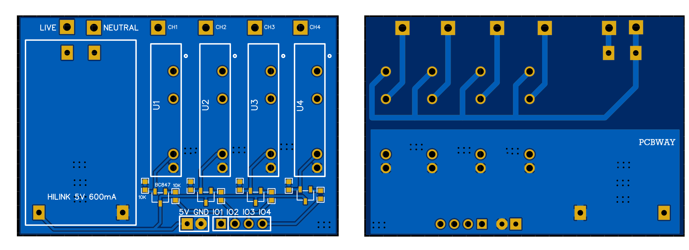

I have designed a triac and optocoupler based project in the past, in which triac act as a relay and optocoupler as a controller. And works on the phenomena of zero crossing. Here is the . But today I want to make a relay module which can fit into a small housing space and I don’t want that clicking noise anymore of standard relays. Then what is the issue with the last project, where I am using standalone integrated circuits which have a limit of handling current. Today in this project we have G2MB, which is a solid state relay module, widely adapted for its performance. I want to merge this project with my ESP8266 offline voice controlled hub based on ESPNOW.
To implement this in a small form factor, I have designed a PCB. This project is sponsored by PCBWAY, I am really excited to see my PCBs in my hands after they are manufactured, they are perfect. No issues with design and I am using the PCBWAY services for a long time. You can consider PCBWAY for your project if it contains a PCB, use this link and get best prices on your first order.
G2MB Relay Module:
Low cost Subminiature PCB mounting 2 amp Single in-line package (SIP). Bottom is approximately 3 times smaller than G3M. Low cost “SIP” package switches up to 2A loads. Built in Snubber circuit and input resistor as option.
- Two footprints available for design flexibility.
- The G3MB-202PEG-4-DC20MA crosses directly to the Motorola M0C2A-60 series power triac.
Components Required:
- SSR G3MB
- 10k 0603 Resistor
- BC847 SMT Transistor
- Hi-Link Power supply 220V to 5V
- SSR PCBs from PCBWAY
Circuit Diagram:
The circuit diagram is quite simple, we have a power conversion unit onboard which helps in switching of these relays. And to make them controllable through a single pin we have transistor drivers, the base is pulled low with the help of 10K resistors. The circuit does not have any capacitor but you can add one between the 5v and GND power line. I used the SMT parts to make it look cleaner as seen in the PCB below.
Coming to the relay part they have 4 pins, 2 for the DC 5v power controlled through transistor and headers. And two for AC, here we have to understand when the control signal is given the transistor makes the relay to switch and the relay will short the internal AC pins together to make the flow electric current through them. The application circuit diagram is given below, do the same to turn on/off the load devices. One more thing these relays are based on triac operation, so we can not apply DC to the AC pins, it will alter the operation of the device and can cause burn issues.
PCB Design:
I have a choice to make it smaller by heading some relay to the backside, But I choose form factor over PCB miniaturisation. The PCB is quite well populated because the hi-link power supply takes more space. I organised everything on the top layer. The PCB only has two layers, some stitching vias for proper current flow, the above layer has a copper pour as ground and the bottom layer is half copper poured as can be seen in the picture above. I do not want to make copper expose stuff here, so I increase the thickness of the AC side PCB and to make it more good remove the ac side copper pour, all the AC traces at bottom and control traces on both the layers.
PCBWAY is the manufacturer here, I got the PCB exactly the same quality I supposed to be. PCBWAY is the one stop solution for all prototyping requirements, So what do they offer? PCBs, Stencil, CNC, PCBA, 3D Printing, Metal Parts, YES TO ALL! Explore now and get free coupons.
Application Circuit:
Here I have shared the one picture of the load device, it has 4 channels so 4 different devices can be operated from the 4 different pins. The controller can be a wire, microcontroller or manual. One line of the AC power directly goes to the load device and the second line through relay.
When operated it shorts the internal connection, completes the circuit and current...
Sagar 001
mbsg99
Hulk
ELECTRONOOBS
Joe Menard
Doesn't the Hi-Link power supply mean that it's always drawing power even when there is no need for it?
