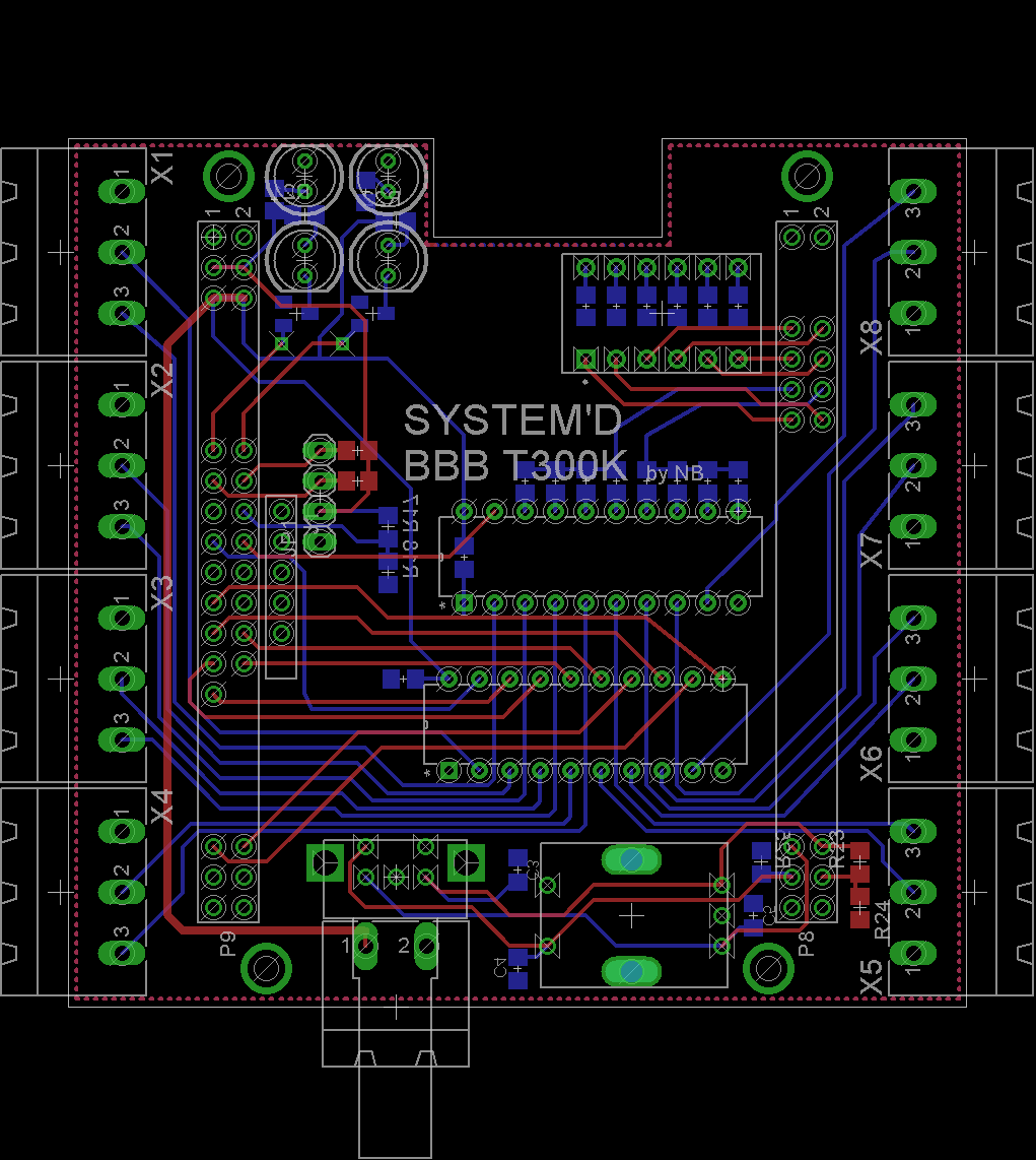

And there we go back to some hardware to drive those LEDs, after the prototype, PCB were made with
  • SN74AHCT245N buffer
  • DS01C-254-L-06BE dip switch
  • TBP01R1-508-03BE connectors
With version 2 of the board, we added an OLED display...
